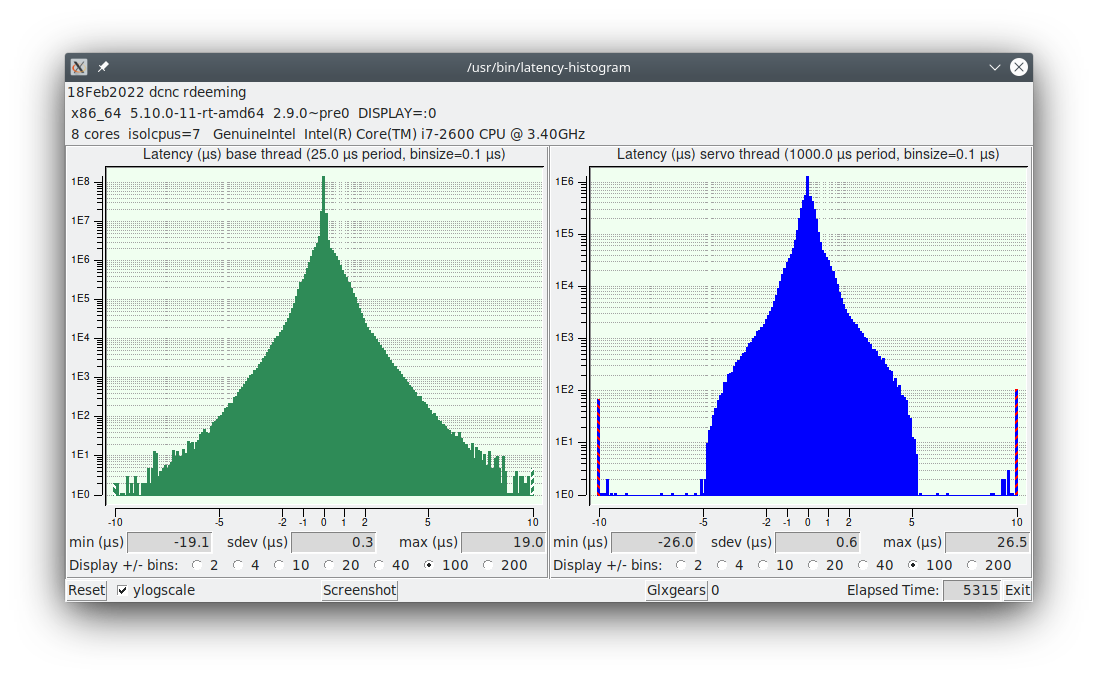

Got tired of the Gigabyte Brix fan noise decided to get a better system when the garage starts to get hot in the summer etc. Picked of a Dell OptiPlex 990 and that seems to be much better.

I did try and do the good fight to get FC35 Server going.
It was close but at the end of a few days I reverted back with CloneZilla and this guide which is put together really nice qtpyvcp Bullseye
With the new kernel builds there is only the need to change grub for RT.
preempt=full processor.max_cstate=1 idle=poll
If anyone wanted to take off where I left off with FC35. Here are my notes based off the link above for Debian plus the hacks to get around the most notable few annoyances like yapps and WC3-LinkChecker
