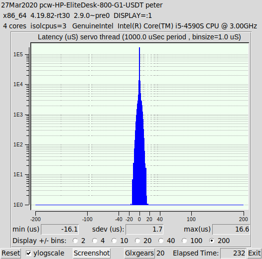

Ahh this is a relatively low powered PC, the Ethernet performance is probably more related to that than the
Realtek driver (which I have not noticed any real issues with)
What does
latency-histogram --nobase -- sbinsize 1000
show?
Replied by PCW on topic Mach3 -> Camtronics -> Parallel P Replacement
I checked the BIOS on this ZBOXNANO-AD12 PC and its as up to date as possible. Version 2K131128.
What does
show?

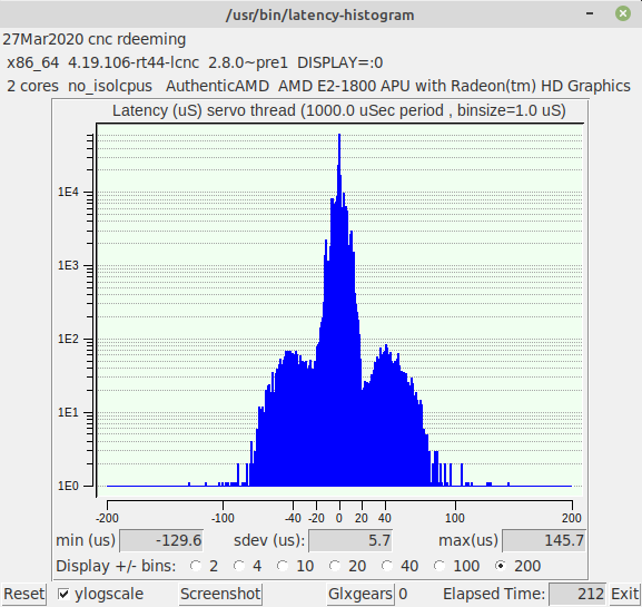

27 Mar 2020 17:12 #161724
by rdeeming
Replied by rdeeming on topic Mach3 -> Camtronics -> Parallel P Replacement

Is what I am building on projected to be a problem down the road for a 3 axis config?

27 Mar 2020 20:20 #161743
It should not really be an issue, worst case is that it cannot do a 1 KHz servo thread, but 750 0r 500 Hz is OK for most
applications
applications

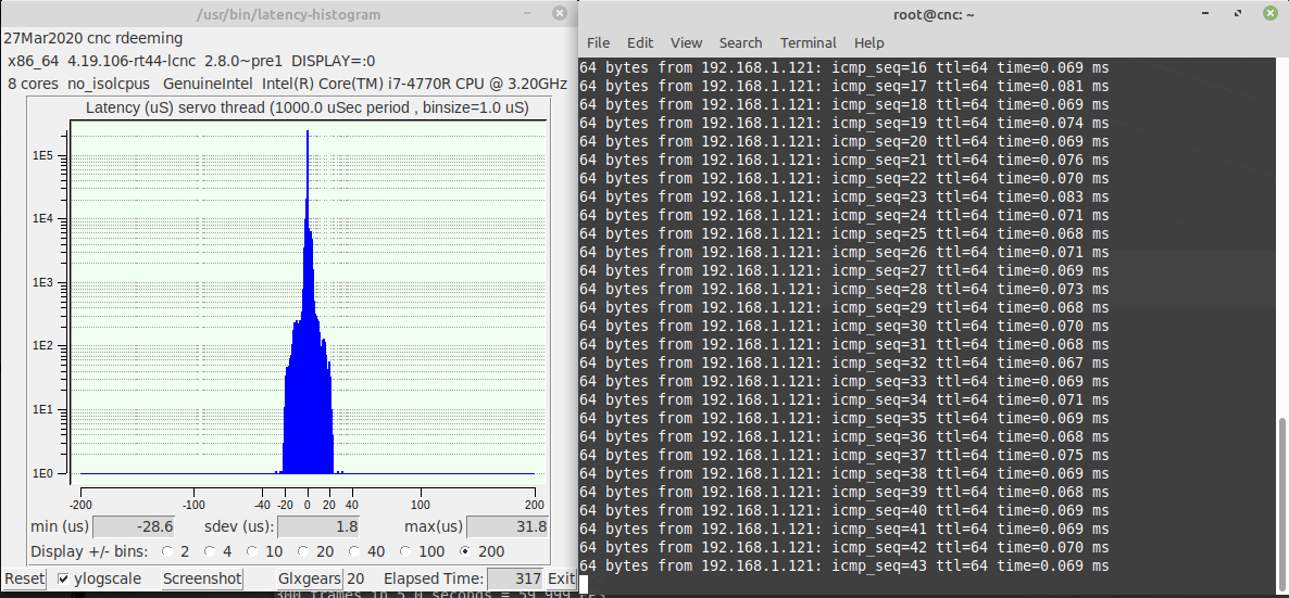

27 Mar 2020 20:37 #161745
by rdeeming
I dug another system out of the basement.
