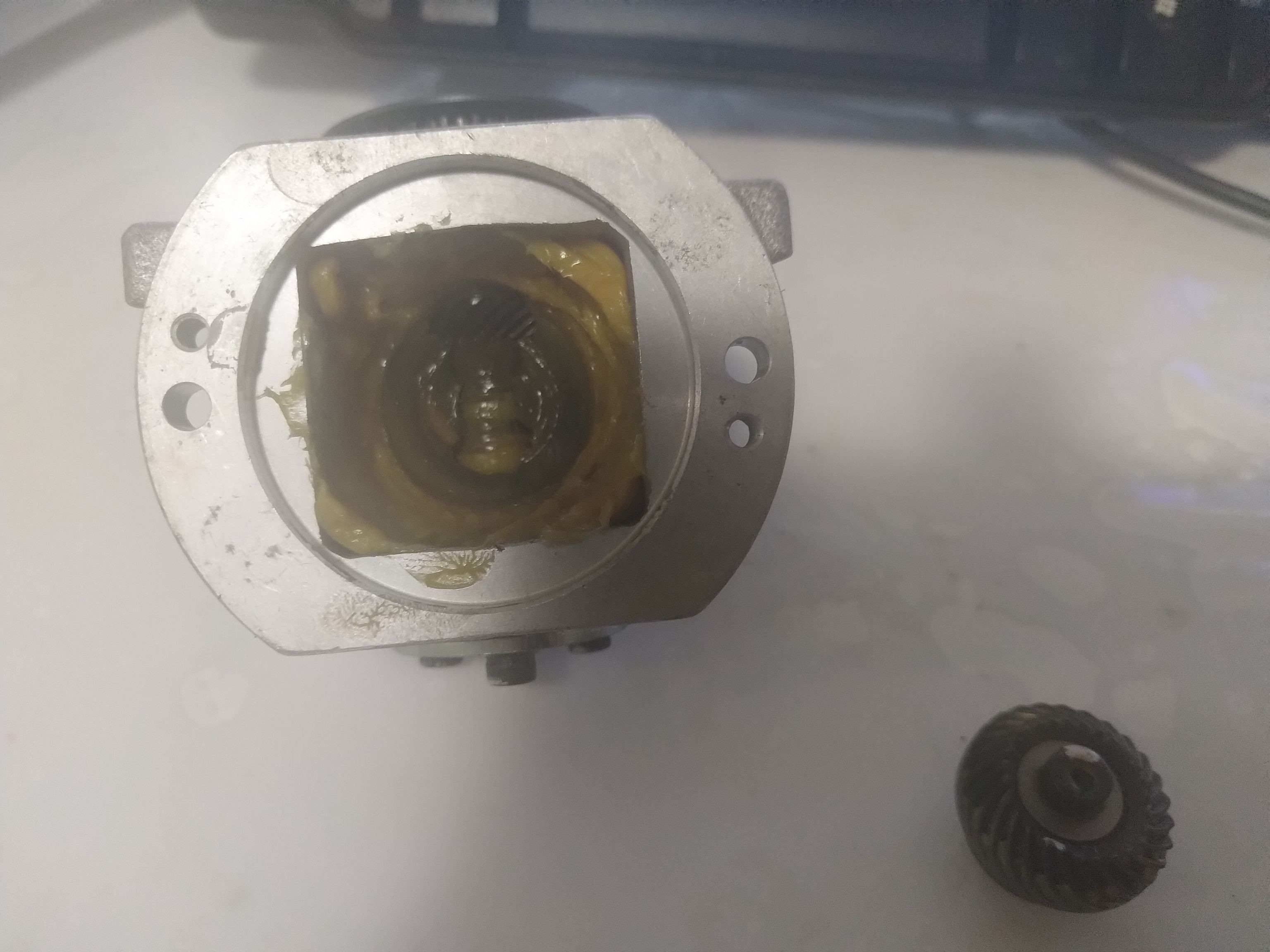

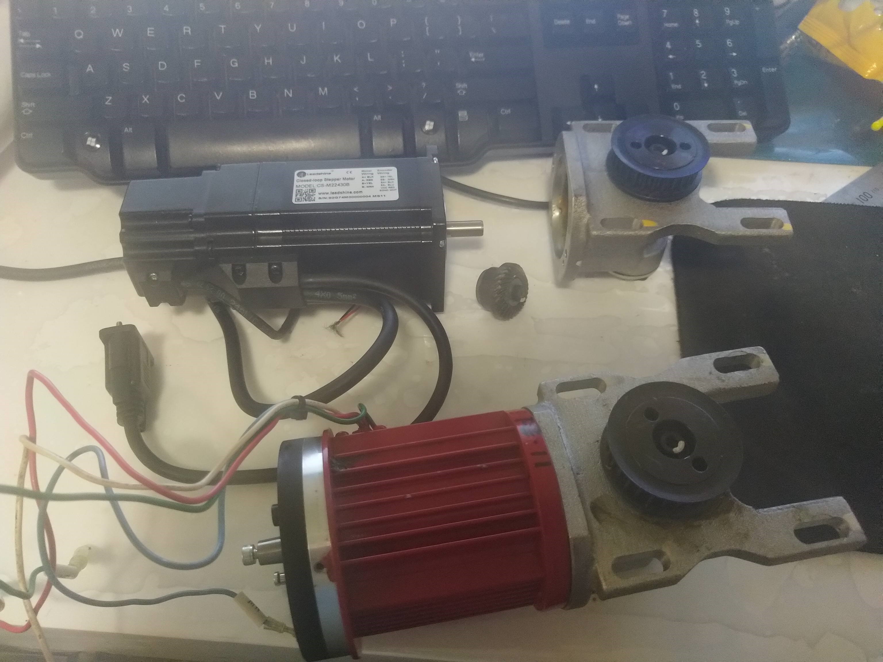

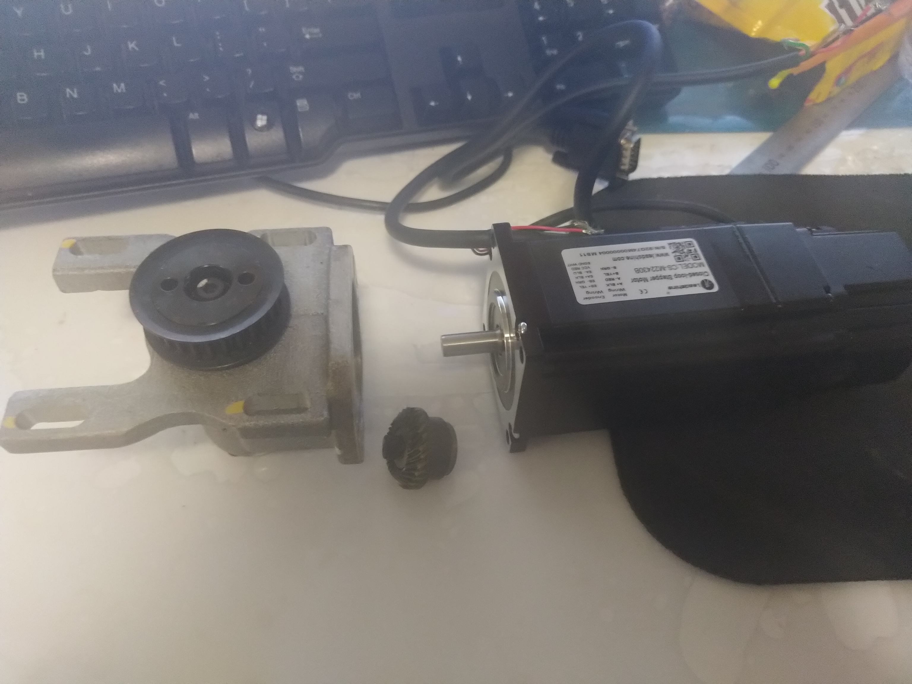

Joints 5 and 6 on the arm are operated via belt drive from two servo motors mounted in the top part of the arm,
Attached to the servos in the arm are two right angle transmitions that drive the belts, I need to make a adapter for the transmitions to the 8mm shafts and mounting points on my new steppers. Should be a fun project in itself.

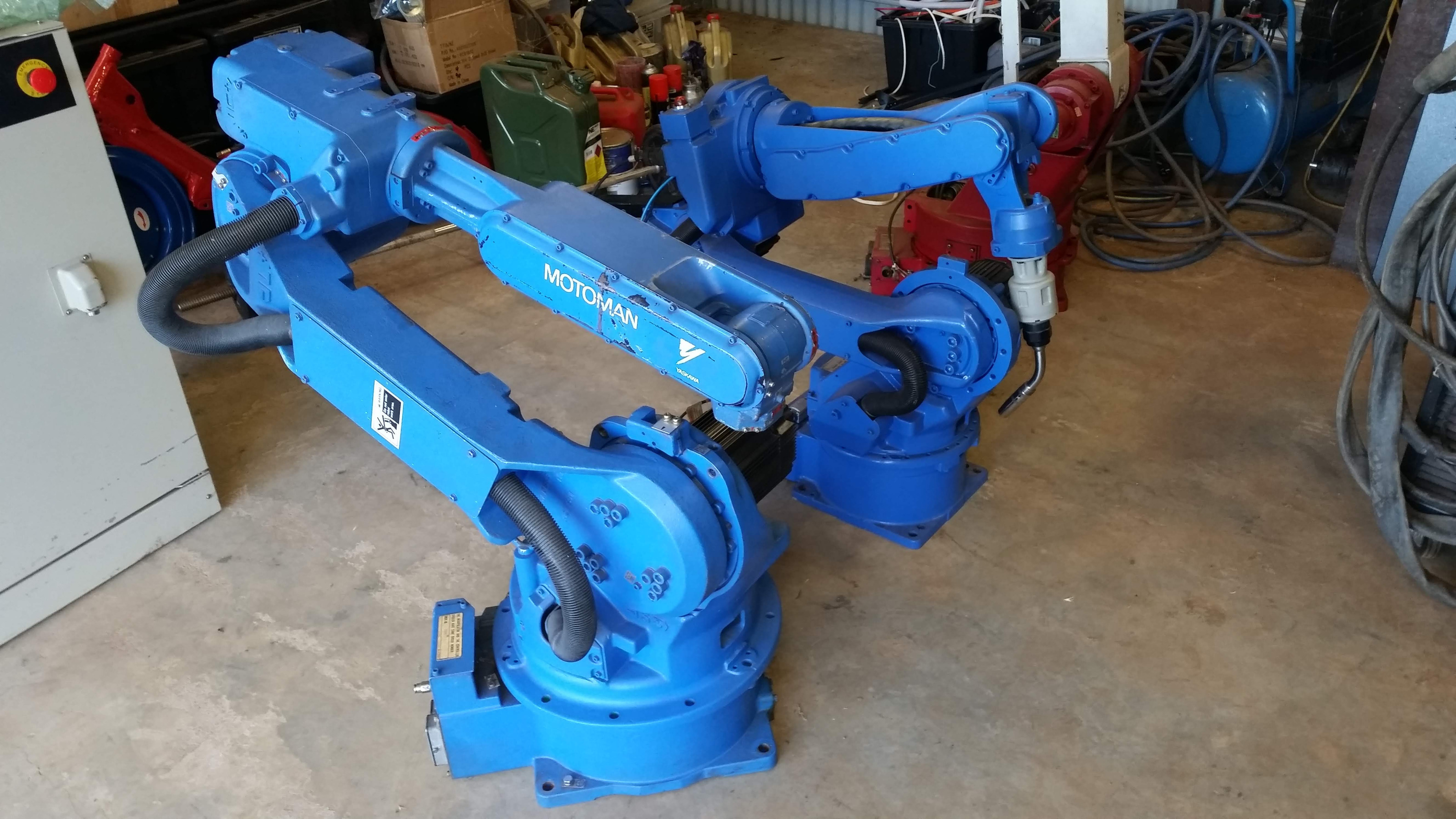

1: I dont know if normal G-Code will work as well as I hope but I will give it a go. I know it is limited as its not made for six axis robots. I was hoping to try to develop a open source hybrid. I have two working newer Motoman robots I am going to reverse engineer to get a working code setup. I will study robot language and try to come up with something that works.
2.,3,4, I am not exactly sure on at this stage. My plan is to get the robot retrofitted with the new motors installed, new grease on the joints and a new coat of paint then dive into the software side. I am sure its going to be a huge learning experience! But I have to get the robot working with external axises workinkg together. That is one of my main goals and EtherCAT will be a big part of that.

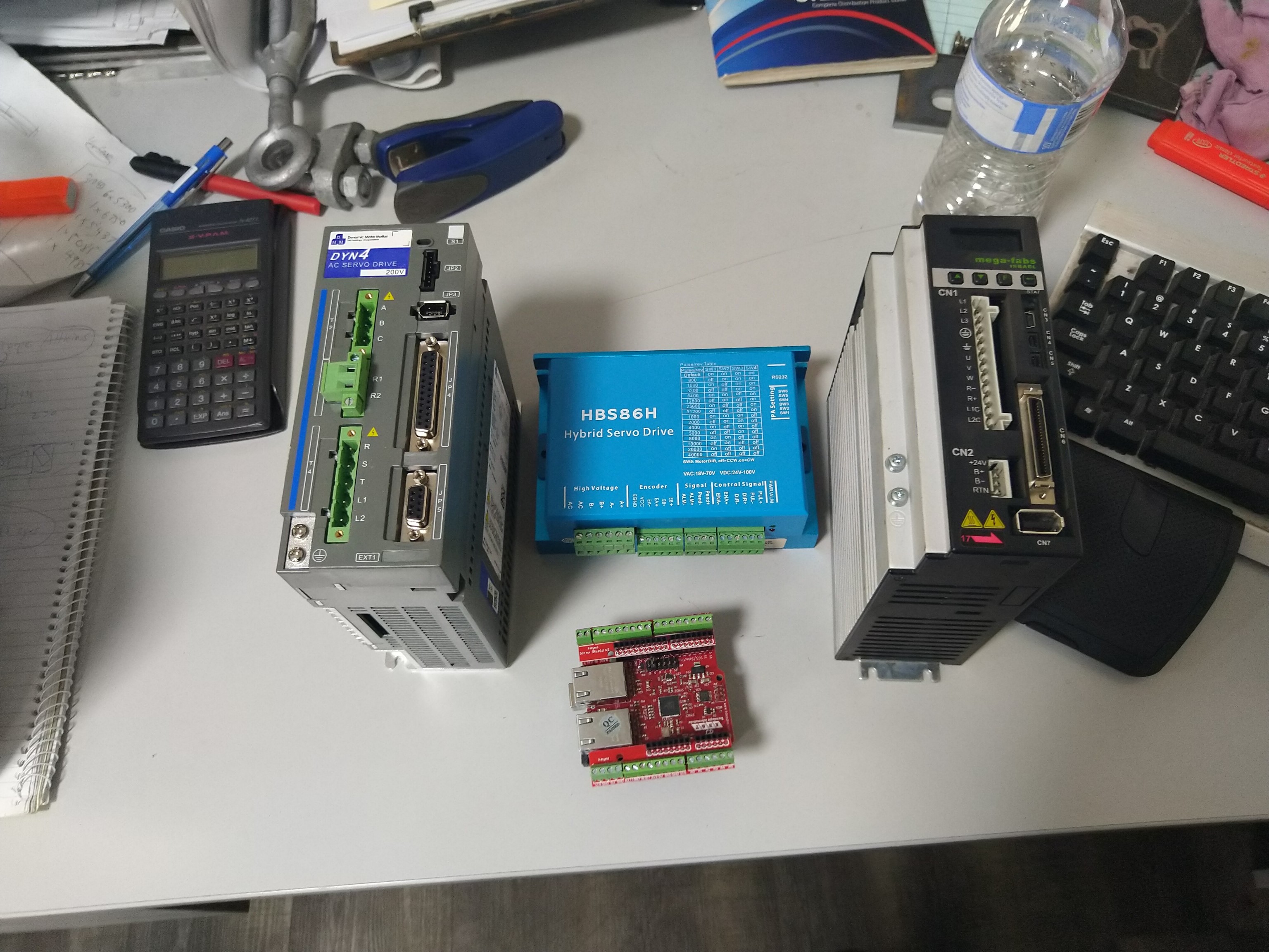

With the steppers I am going to be powering them with 80Vac with is nearly equivalent to 100VDC. They should be good for more than 1500 RPM at those voltages. But even so with the large gear reductions in the harmonic drives I do not think ultra high speeds will be necessary for my welding application so they should be fine I hope. We will see.

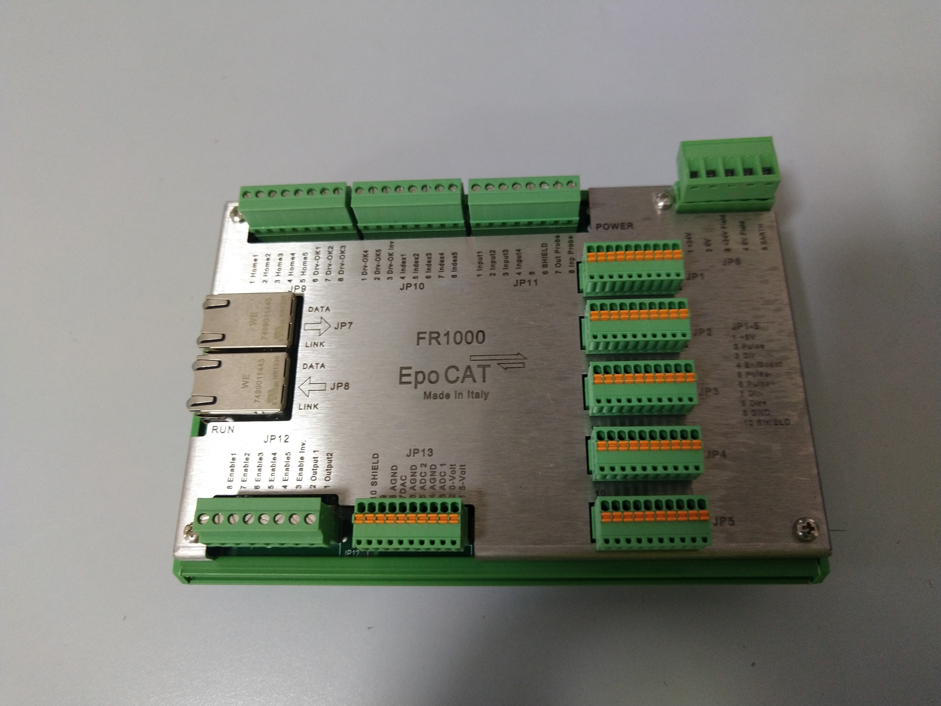

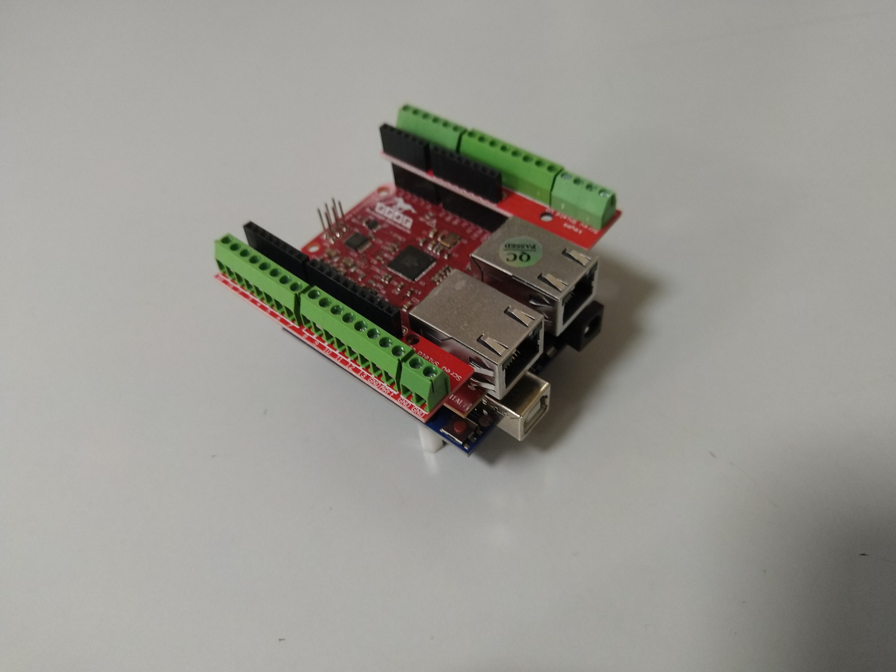

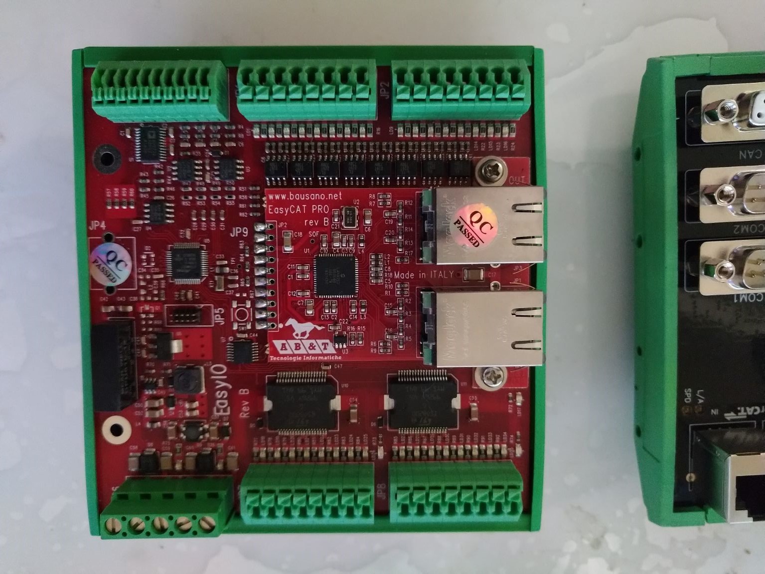

I have looked in the AB&T modules and I have brought three to experiment with.
I have not had much time to play with them yet as I have a few other projects going on but I want to try to get the EasyCAT set up to control these drives, I have high hopes for the modules.
