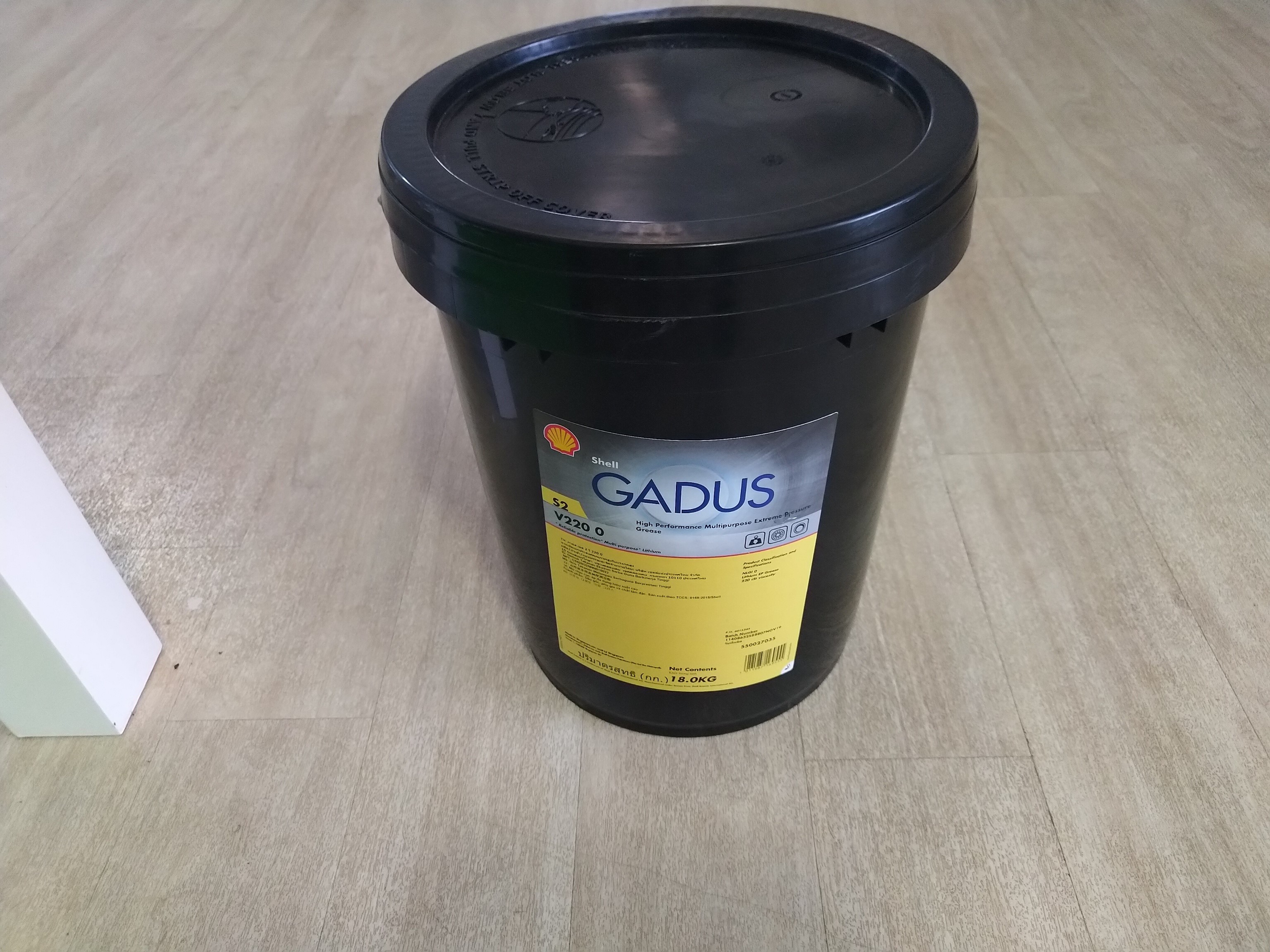

02 Aug 2020 22:32 - 02 Aug 2020 22:37 #176950 by cakeslob
Replied by cakeslob on topic Motoman K6SB Retrofit
Does anyone have any advice on the type of grease I should use to replace the old?
I have done a bit of looking and cant find a definitive answer.
depends on the joint and gearbox , joints S L U , or 1, 2 , 3 take a MOLY WHITE 00(for the joints with cyclodial gearboxes) , joints R B T , 4, 5, 6, take harmonic SK-1 grease(for the harmonic joints), and the pivot joints not connected to gearbox take EP2, some of the names have been updated since, but thats what it says on my robot, i have an old SK-6.check if your gearboxes/joints are different. spent a lot of time learning about the yasnacMRC controller, so if you any questions, i might be able to help. my goal was also a linuxcnc retrofit, but im a bit hesitant about it. are your newer ones using the the yasnac XRC controller?
Last edit: 02 Aug 2020 22:37 by cakeslob.
  • thefabricator03
  • thefabricator03's Avatar Topic Author
  • Visitor
  • Visitor
02 Aug 2020 23:00 #176956 by thefabricator03
Replied by thefabricator03 on topic Motoman K6SB Retrofit
Thanks for the grease advice. This robot had the ERC controller, even older than the MRC.
My newer robots have a NX100 controller.
I wont be going back to proprietary controllers when I get the LinuxCNC based controller set up.
  • thefabricator03
  • Visitor
  • Visitor
25 Aug 2020 03:28 - 25 Aug 2020 11:40 #179307 by thefabricator03
You would not believe how difficult it was trying to get the recommended grease here in Australia!. I contacted the Australian Yaskawa dealer and they wanted $800 for a 18KG drum of Moly White 00 and $900 for a 2.5 kg can of SK-1.
The only company offering tubes of the stuff was Robotworx in the USA. They were selling the tubes for $22 USD each but wanted $330 AUD just for shipping.
I spoke to my local bearing supplier and he put me onto a guy from Shell who recommended Gadus S2 V220 0, but I had to buy a 18kg drum. It only cost me $240AUD for the drum, much more than I need but at least I wont run out!
Last edit: 25 Aug 2020 11:40 by thefabricator03.
