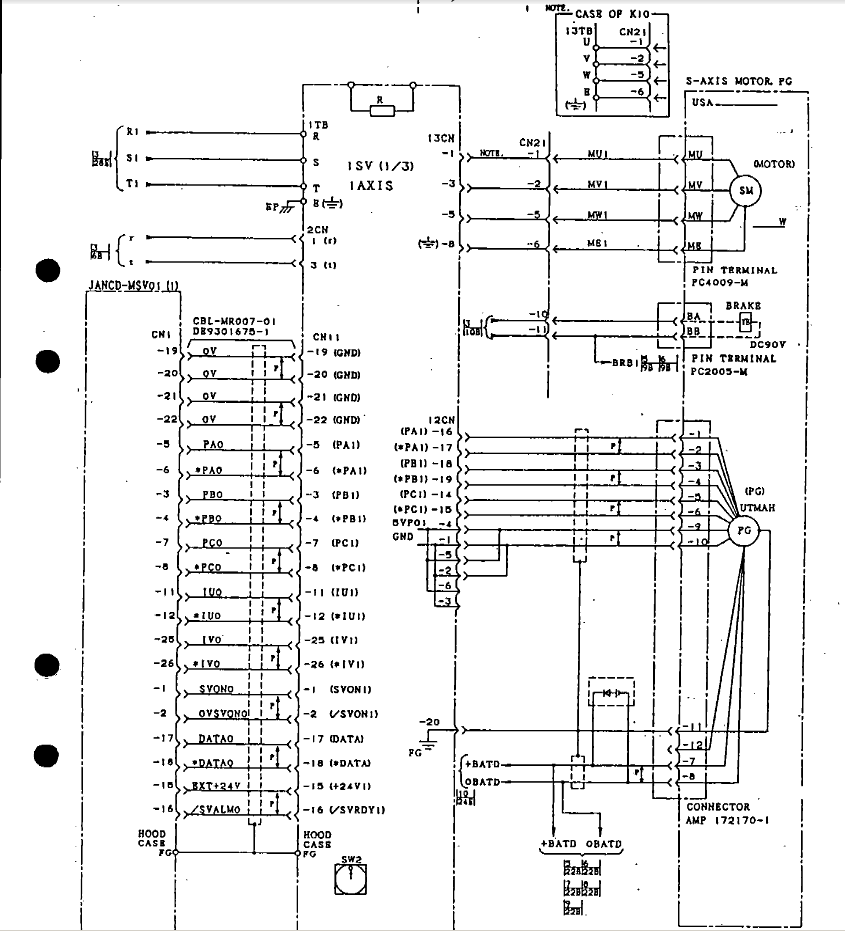

Well, I dont know if you will find out much info on that. I havent found a dedicated manual for that before. Boards like the MSV-01 have very little documentation, I assume because they are a more proprietary part of the robot that requires little interaction from the end user. The most reference I see about it is, "REPLACE MSV-01 OR CALL MOTOMAN". robot-forum is probably a better place to ask that.
If you want to do some digging and find out, you can make conclusions based on the information surrounding the MSV-01. Motoman has all their old ass manuals online, digitized for free, which is very cool of them to do so. If you look into the external axis board, it might have some more info, because I would wager it is a 2 axis version of the MSv-01.
There is def an current ref for the amp, because there is an alarm for it. Based on the manual for the servo drives, I also believe they are running torque mode. The board itself is 6 yaskawa DSP;s, with a daughter board add on. Ive also attached the wire diag for MSV-01
I will take any info you have on the encoder if you dont mind. It was expensive to replace, and complicated.

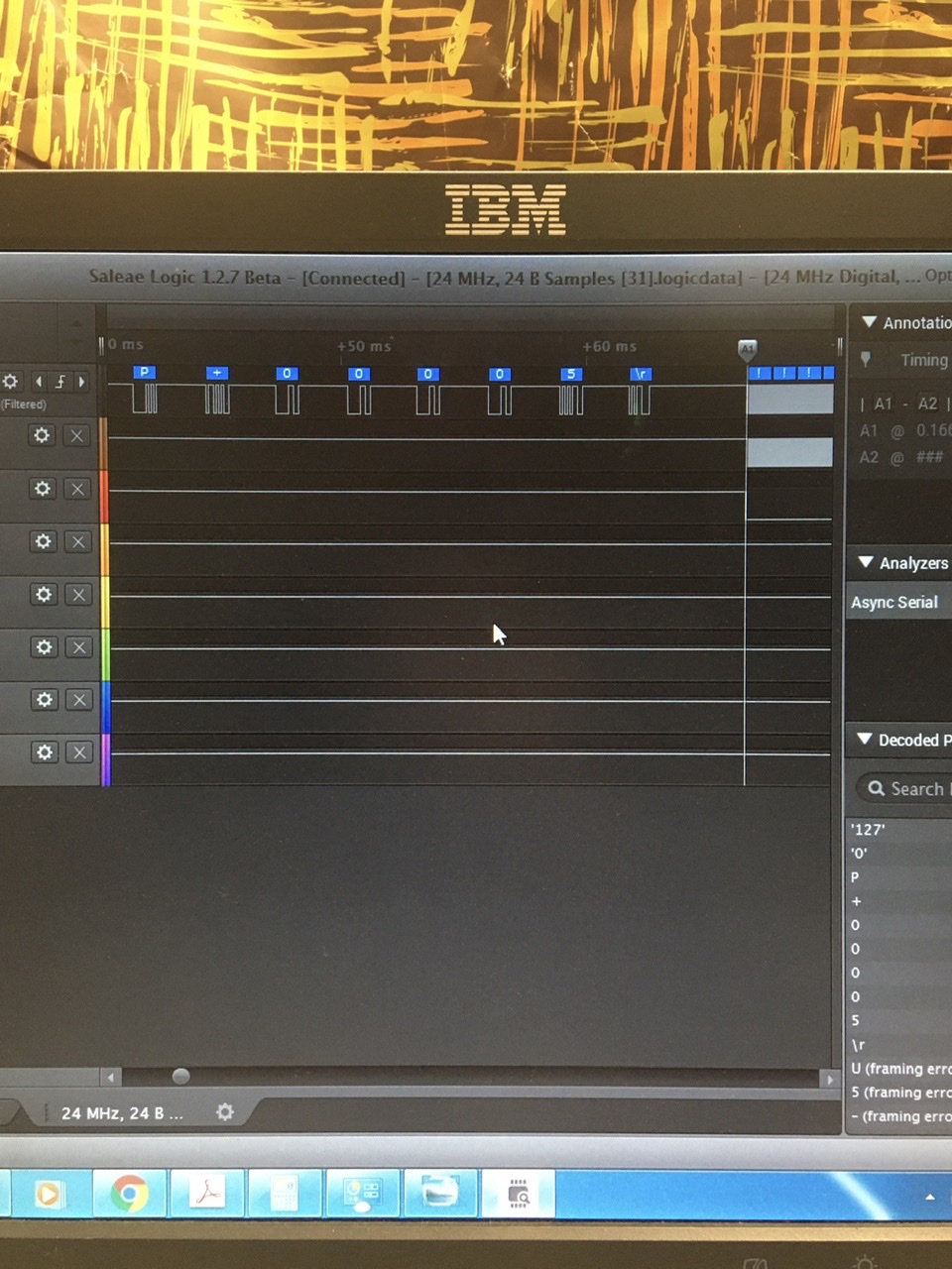

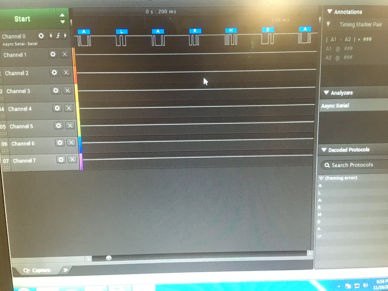

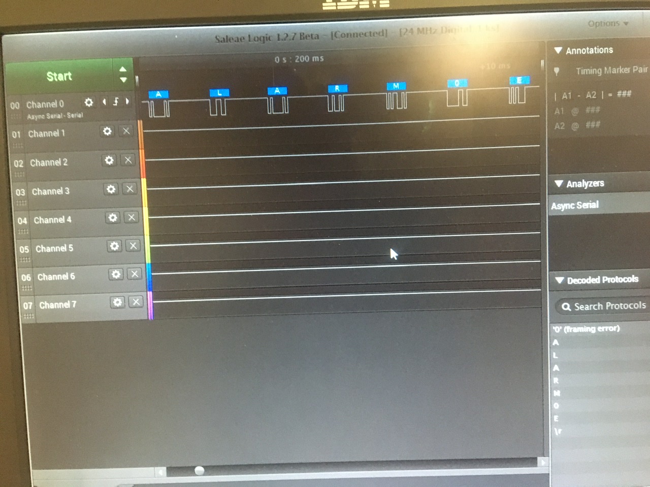

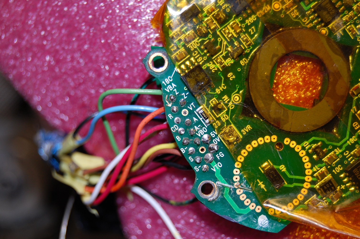

09 Apr 2023 07:24 #268650
by boksi
Replied by boksi on topic Motoman K6SB Retrofit

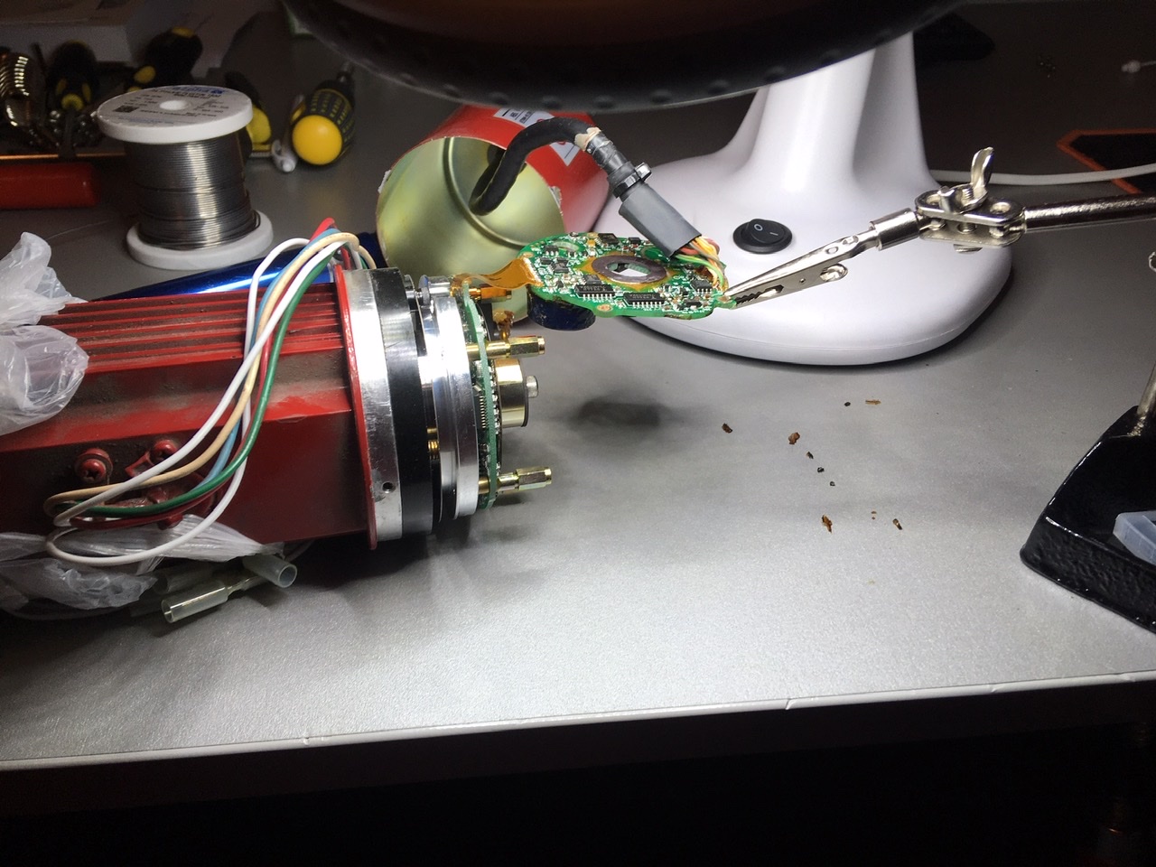

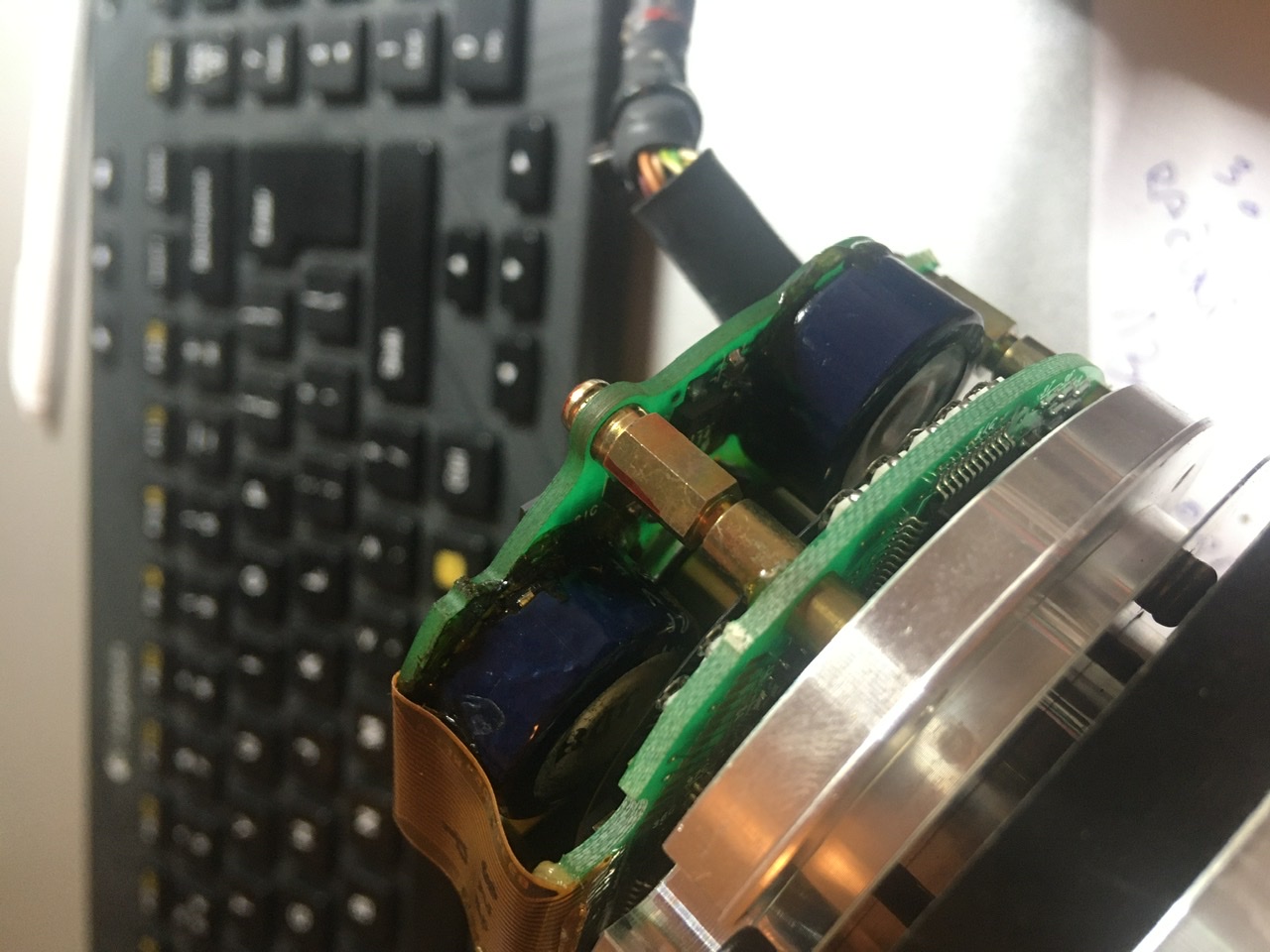

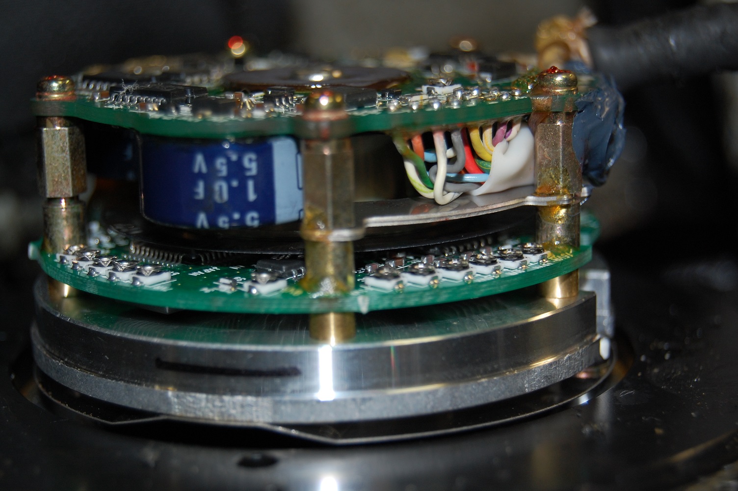

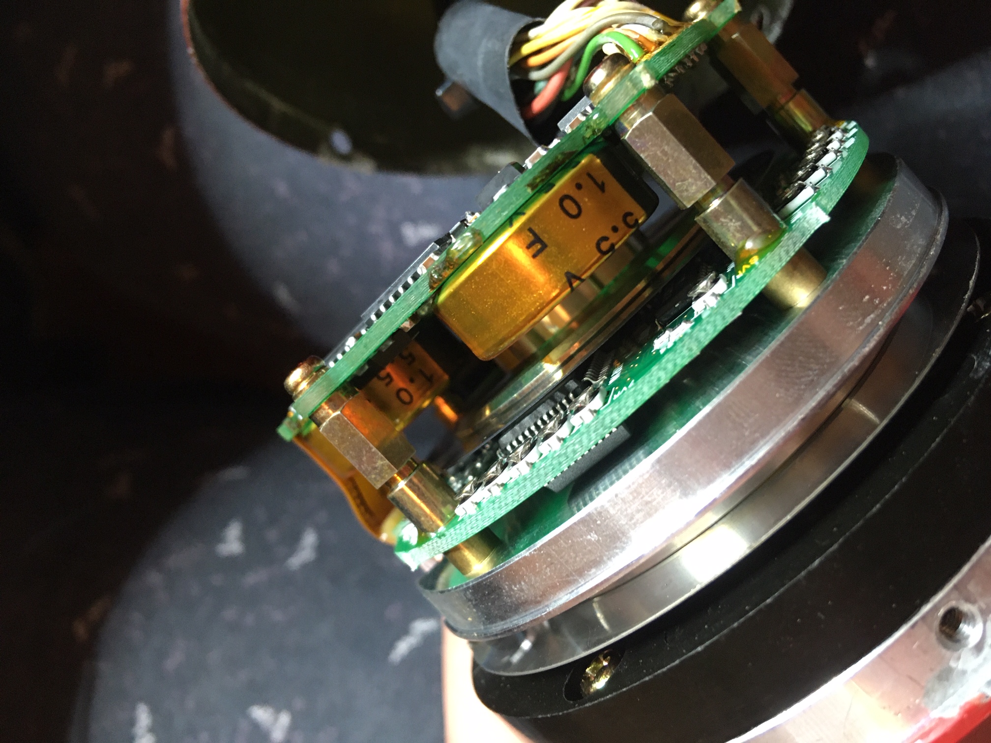

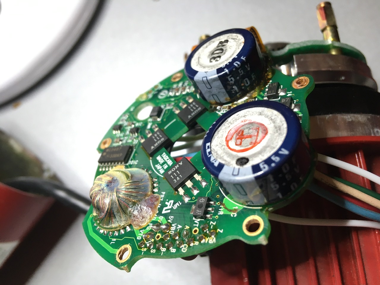

Thanks.
I asked on robot forum but get very little info. I suppose for different versions could be some differences. In mean time found this diagram for K6SB.
It seems that that velocity loop is closed in drive. But in drive manual it looks like it is accepting current command. I will check more detailed.
Concerning encoder info check pdf.
If caps in encoder are bad you should replace them to be able to get rid of alarm and get position informations.
Here ara some pics how this looks like and some exaple of communication.
Alarms concernig bad caps and missing battery if I remember good

- cakeslob
- Posts: 927
- Thank you received: 280
09 Apr 2023 15:56 #268684
by cakeslob
Replied by cakeslob on topic Motoman K6SB Retrofit
Thanks thats some good stufflol, yeah I did the same thing with the caps. I even tried redoing the cable. It was fine with me jiggling it for a while, but one time the robot arm lost position in that joint and the arm just dropped like a bag of shit, so I sent the motor for rebuild after that.
Hmm the MSV-02 is the daughter board on the msv-01
my arm is the SK6
my arm is the SK6

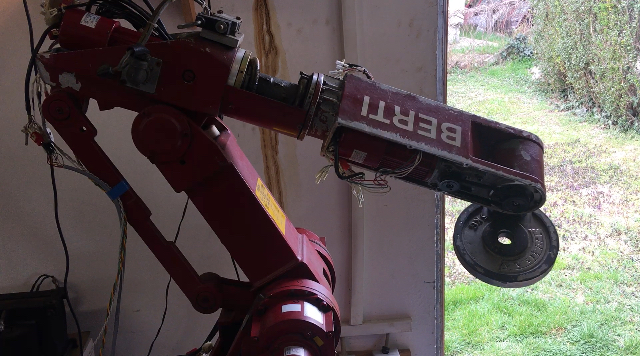

- Posts: 22004
- Thank you received: 7490
09 Apr 2023 18:20 #268697
Replied by tommylight on topic Motoman K6SB Retrofit

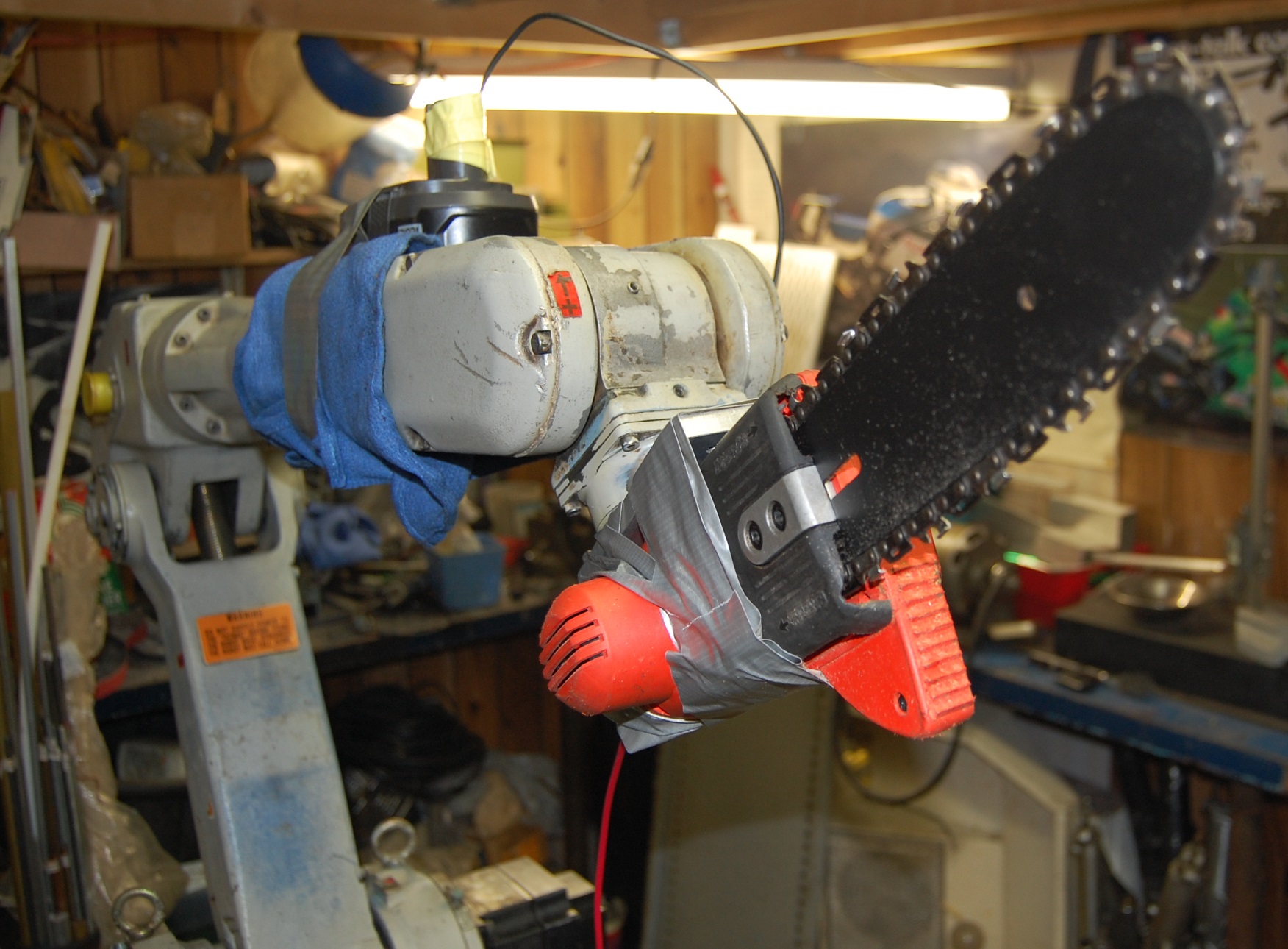

Preparing for a zombie apocalypse ?

11 Apr 2023 19:23 #268837
by boksi
Mine is also preparing for sometning seems for bodybuilding competition
