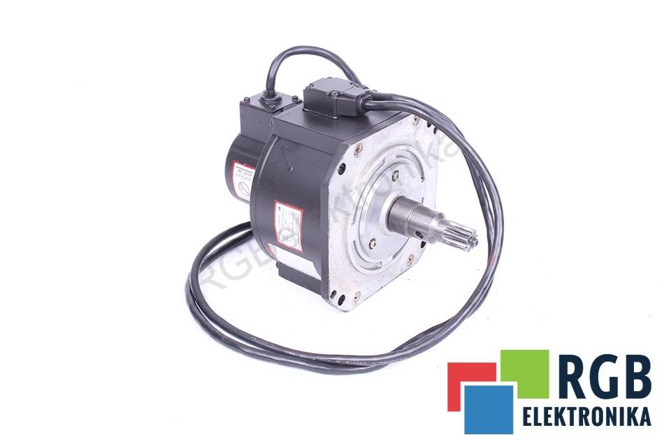

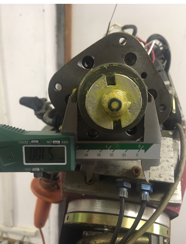

All I can remember as I pull out motors long time ago. S joint motor and gears look like this.

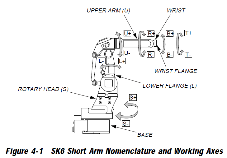

For upper joints R,B and T motors seems to be the same and looked like this.
For U and L joints I have to check.

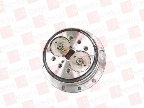

I little googled about cyclodial drive. I found this on wiki :"Due to the eccentric nature of the drive, if the cycloidal disk is not balanced by a second disk or a counterweight, it will generate vibrations which propagate through the driven shafts and the body. This increases wear on the exterior teeth of the cycloidal disk and the component bearings. With two discs the static imbalance is corrected but a small dynamic imbalance remains. This is generally considered acceptable for most applications. To reduce vibration, high-speed drives use three or more discs to correct the imbalance; the outer discs move in unison, in opposition to the middle one, which is twice as massive."
I mostly test S axis and noticed vibrations. By looking at current/torque plot from drive undamped vibrations are present on  constant velocity phase. Tried with a lot of tunning current controllers and position controller but vibrations seems to remain. Current/torque vibrations are reflecting speed and finally following error. I first thought maybe this could be from trapezoidal velocity profile from Linuxcnc(I used for testing 6i25 mesa)  as it will give acc/decc step response and inject high impact but this wasn't a problem as I tried also with different hardware which generated cosine S-curve velocity profile and still constant velocity phase of movement has undamped vibrations. S-curve profile improved a lot transition phases acceleration and deacceleration. Is it possible that combination of gear technology(at time of manufacturing) and fact that my arm has about 30 years  is responsible for this vibration or this could be something else?

boksi, yeah the S is cyclodial, L and U are the same thing, except with brakes on the motor,same with fanuc. They sometimes have a secondary gear reduction with spur gears. I dont know the purpose of the 2 spurgears on the cyclodial, but I think its something to keep the 2 disks in sync with the eccentric middle section. R and T are harmonic, B is wild card, sometimes is got belts, sometimes spur gears, sometimes a differential to control J5 and J6 , bevel gears etc. If that motor is your B axis , then it is harmonic, as that is a wave generator at the end of the motor, or at least it looks like.
