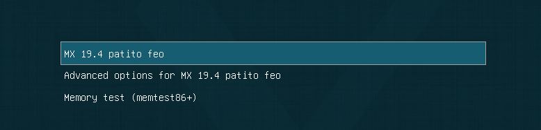

Hold off for a bit, I may have installed standard 19.3 today from an existing download, my memory is so bad I can't remember.
Had some time to check this after work. Looks like the rt kernel is in the regular 19.4 ISO.
So, install guide forthcoming.
Here are the results:

I spent all day yesterday trying to install Linux and Linuxcnc on my Odroid H2+ which requires the network drivers to be installed from a USB drive as they are not in most distros. MxLinux had issues with loosing my wireless mouse. Also on PREEMPT_RT, there was a dependency required (how do you install that with no network?). Tried Mint 20.3 with similar issues. Tried Mint 19.3 and had issues too. Finally tried to install the official Debian Buster ISO and it wanted to install a dependency to install grub so it was not possible to boot. I could not believe it was not in the ISO!
So eventually, installed Debian 10 (Bullseye RC3 released 2 August) which uses the Linux 5.10 kernel which supported my network cards and has the PREEMPT_RT kernel in its repos so I installed that with Synaptic. Sadly, there is no buildbot repo for Bullseye and I found it was impossible to install linuxcnc using synaptic becasue it had some dependencies that could not be satisifed. Some seemed pretty silly like it needed Python 3.8 or less and Bullseye is running Python 3.9.
So back to good old run in place to install linuxcnc. So this time I built the debs which I had never done before and they installed OK so have the menus operational. I have a full list of dependencies and the debs in Google drive.
I'm actually pretty excited about this. If the devs got behind bullseye, it would be possible to stop building ISOs and just ask the Debian guys nicely to include the buildbot repo in the debian mainstream distos. How cool would that be?
