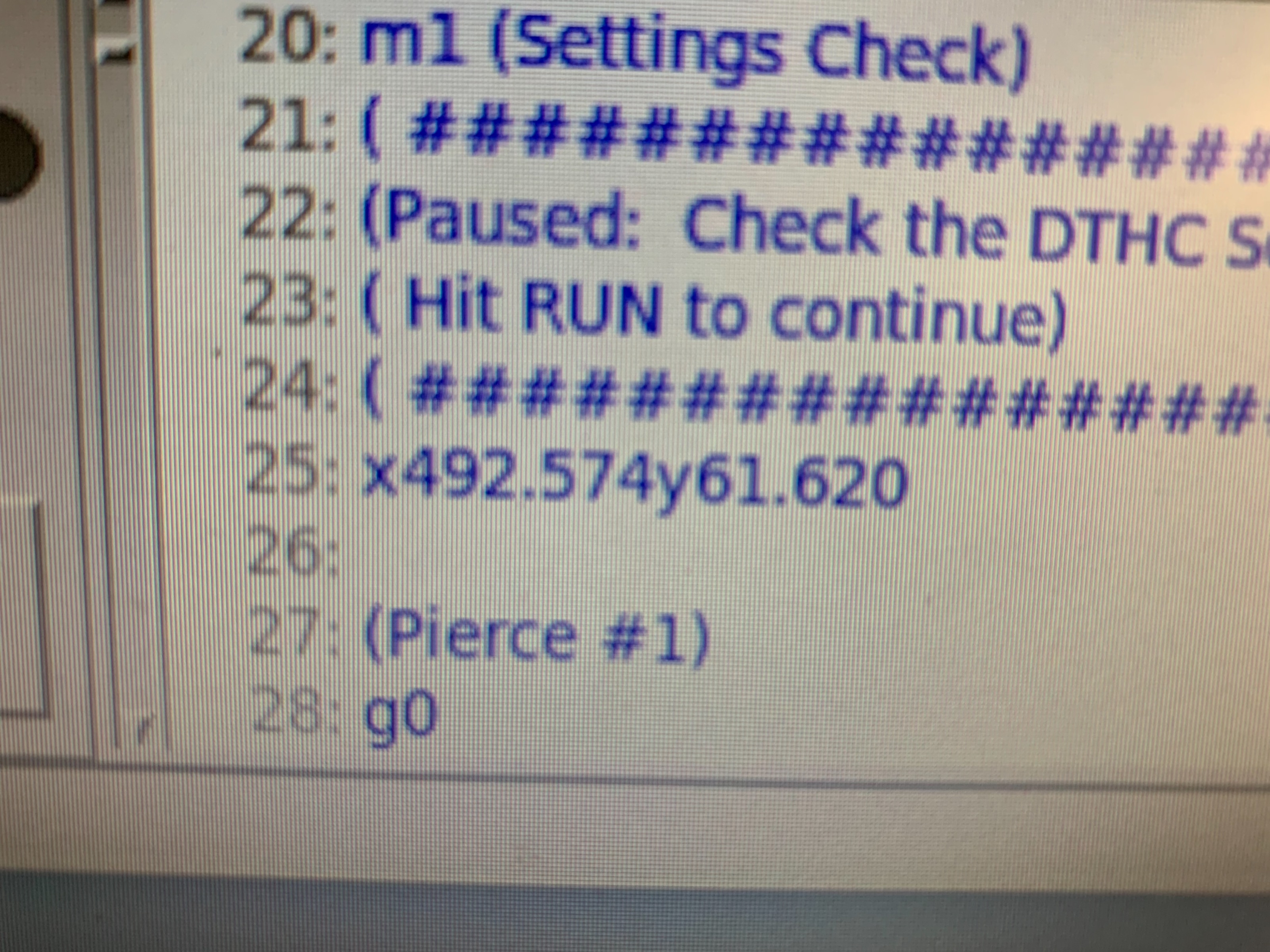

18 Jul 2021 00:16 #215190
by RNJFAB
Replied by RNJFAB on topic Homemade, cheap, plasma CNC

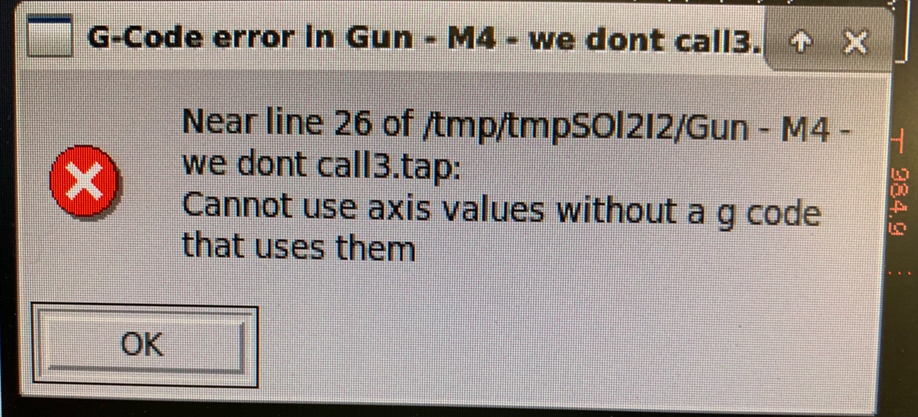

18 Jul 2021 02:17 #215195
by RNJFAB
Attachment not found

18 Jul 2021 07:51 #215210
by phillc54
Replied by phillc54 on topic Homemade, cheap, plasma CNC
In line 25 you possibly require a G0 at the start of the line.

18 Jul 2021 09:01 #215211
by RNJFAB
Thanks Phill
I can't edit the G code, it changes when I switch from pierce and cut to pierce only.
