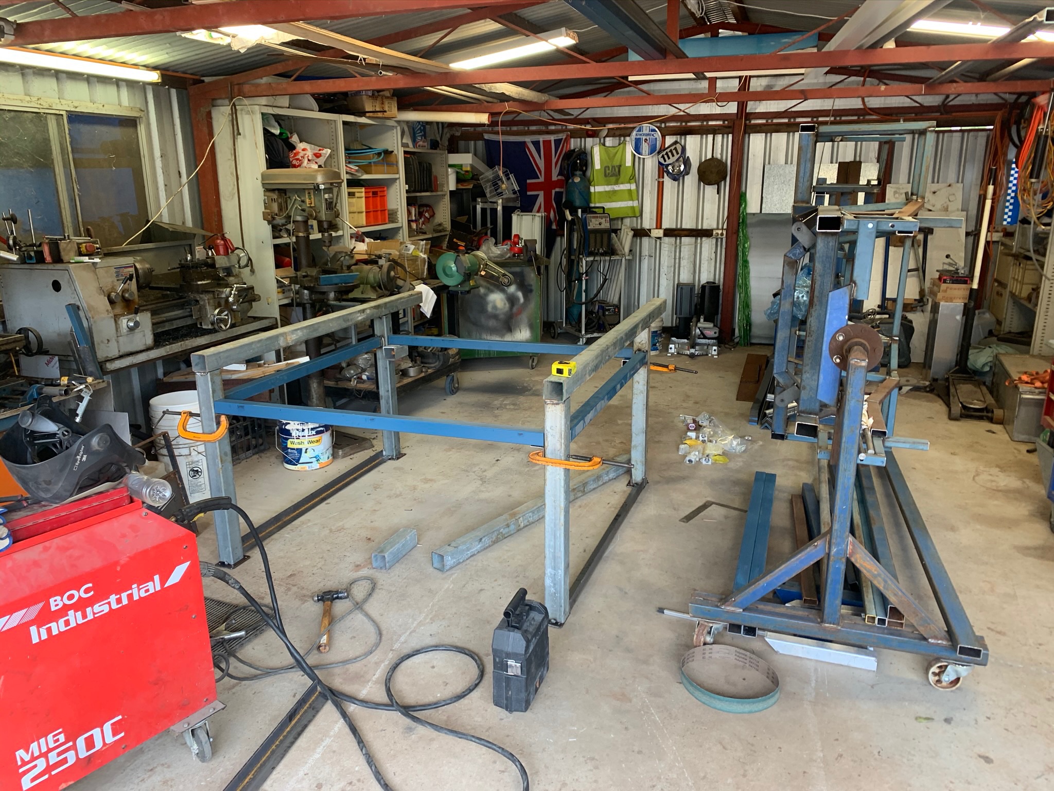

So long time reader, first time poster.
** Photos will be uploaded soon **
I'm in Australia so all measurements are in mm (25mm = 1 inch) and all $ are AUD (1AUD = 0.70USD)

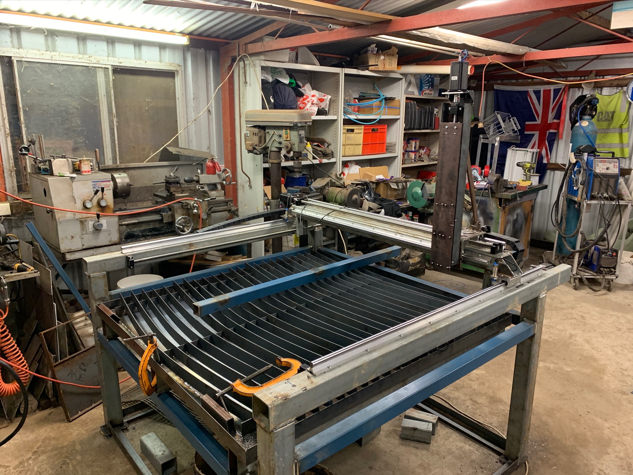

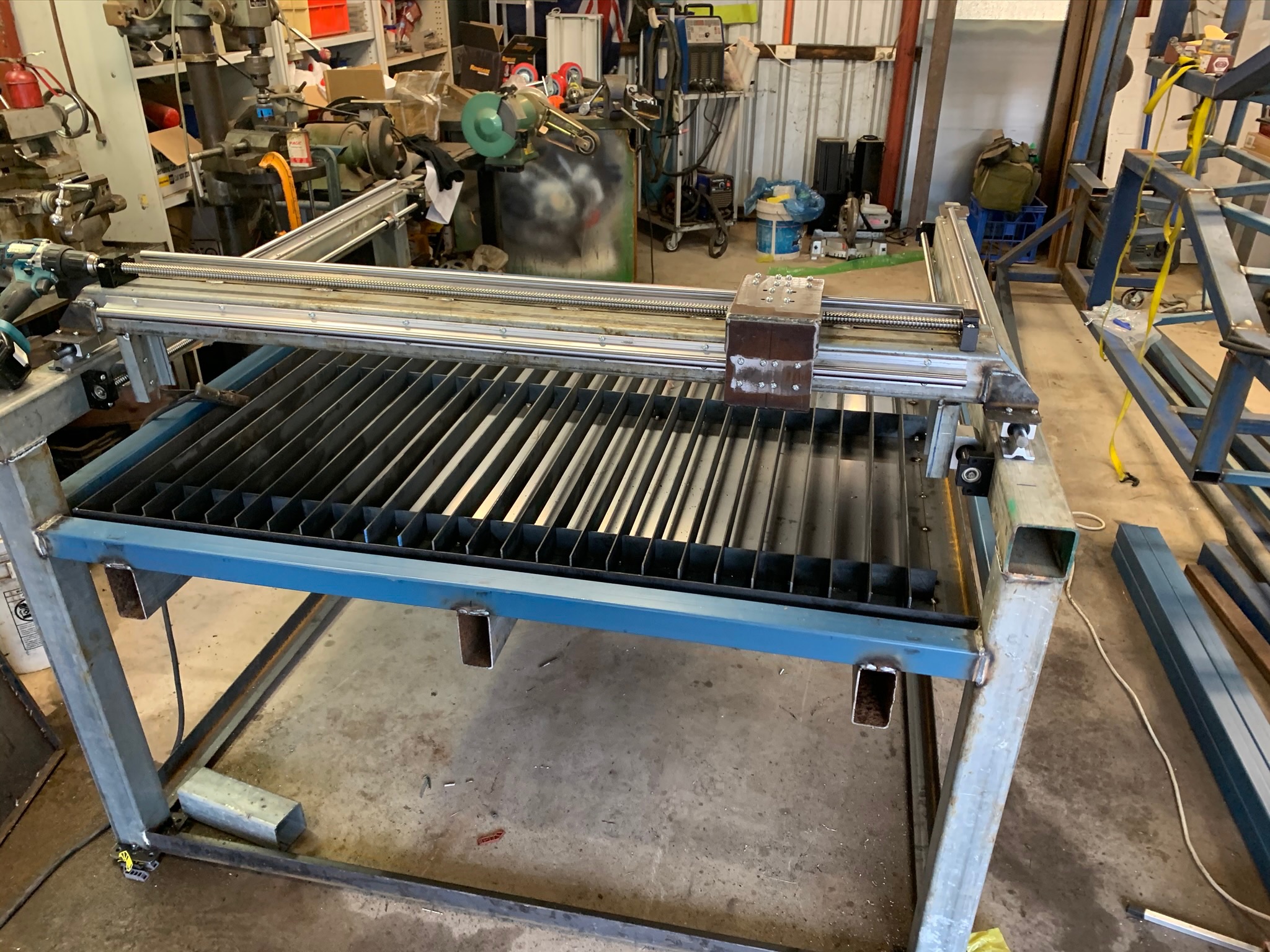

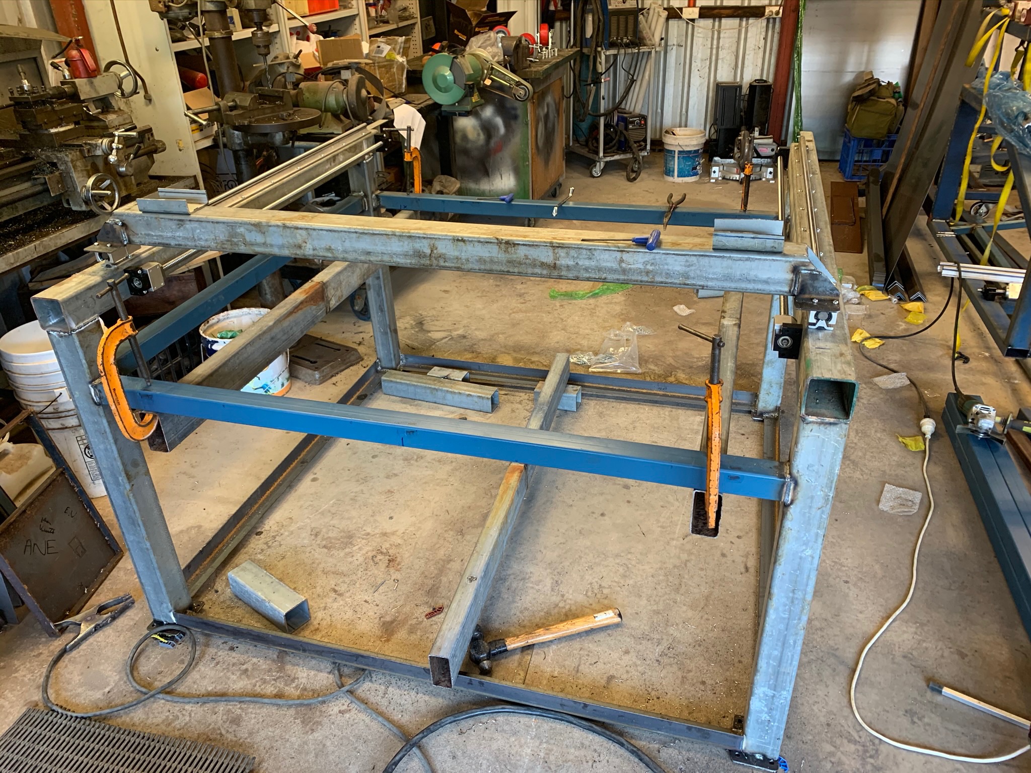

I built my own CNC plasma, with lots of hiccups, and want to share my experience for others looking to go down this path.
My build started in Jan 2020, with the plan that this would be made for my students so they had access to a CNC, buying one was out of our reach.
With the help of a few mates (much smarted than me) I worked through getting the right advise on what to buy to reach the end goal, that being a CNC that had a working area of 1200x1200, capable of plasma and router setup, cheap, using the existing Plasma we had and routers.
So I started by finding hardware that would work for us, this was found in 1200mm ball screws and 1300mm linear rails (mistake). this coupled with NEMA 23 stepper motors(Good) and TH6600 stepper motors (Good), Mach 3 USB board (Mistake).
These were all put together with what I thought would be the best frame (using material I had scavenged over the years). This was 75x75x3mm Gal RHS.
Then the gantry from another piece of 75x75x3mm with some angle to hold the bearings.
I decided on a waterbed as a cheap and suitable solution, 50x50 angle with a 2mm base, fully welded.

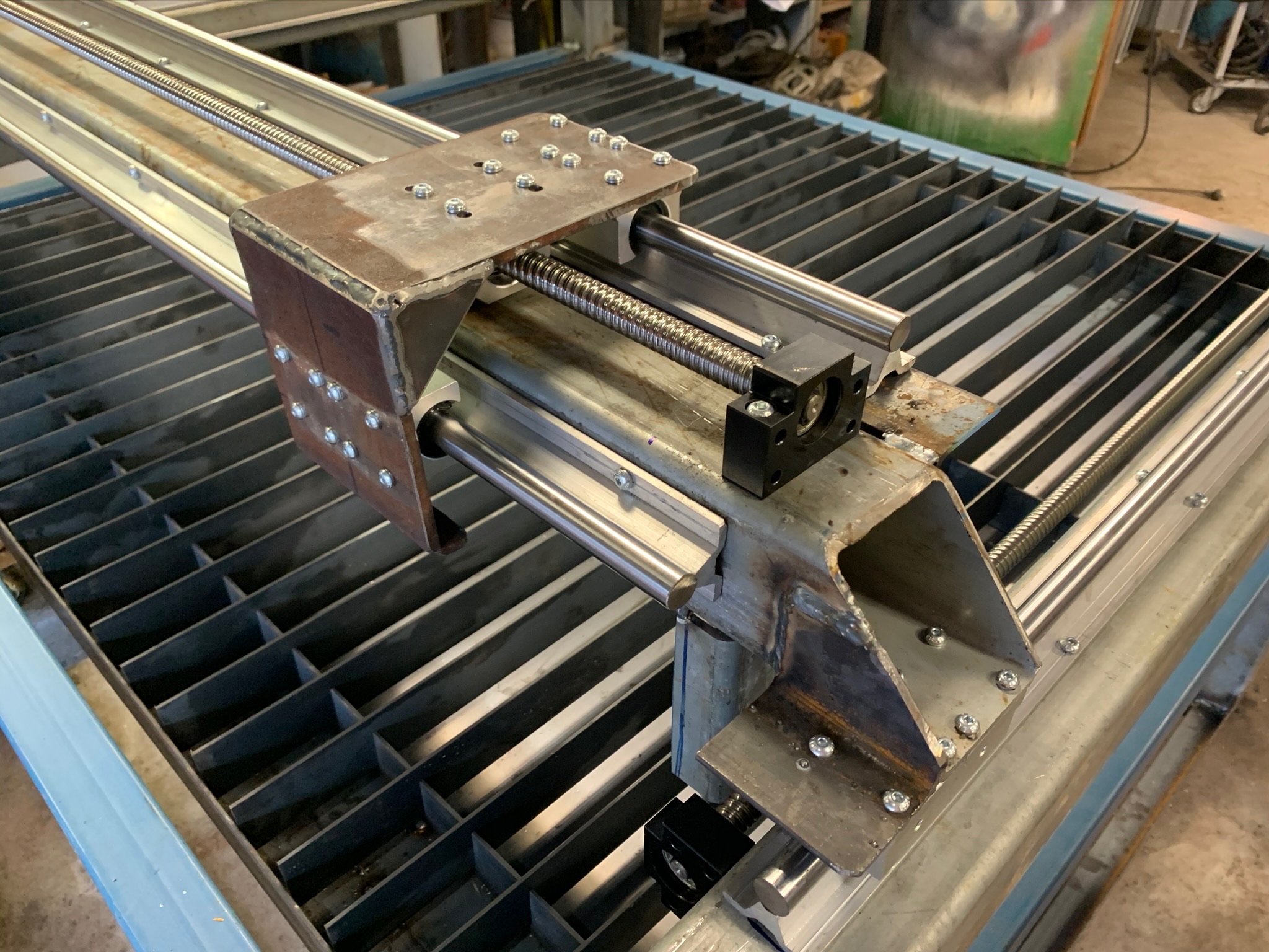

Nice! That Z is a beast!
Is it burning metal yet?

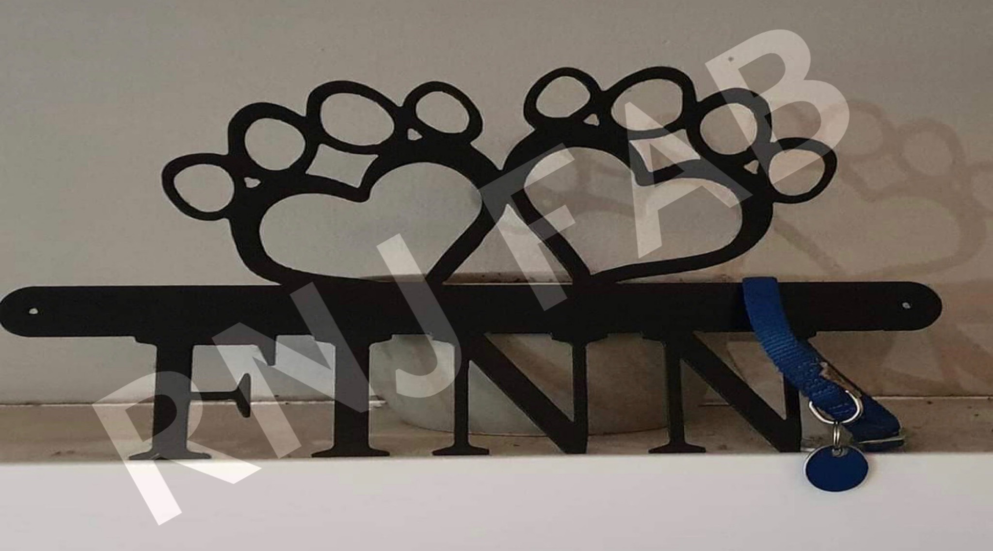

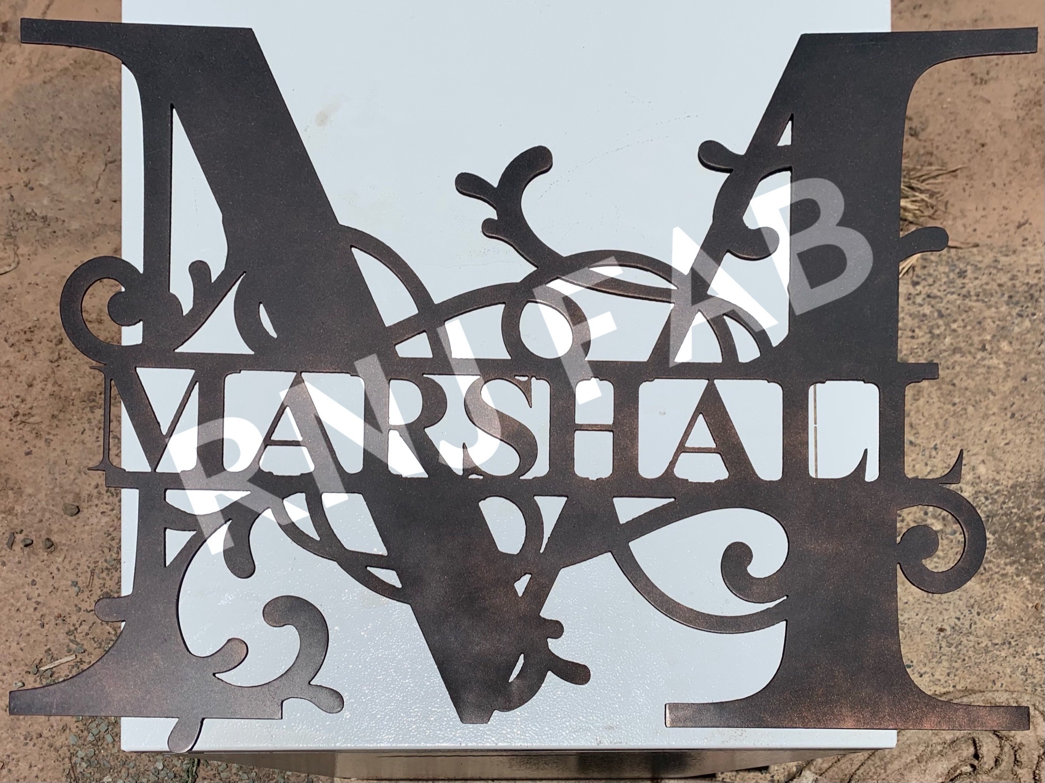

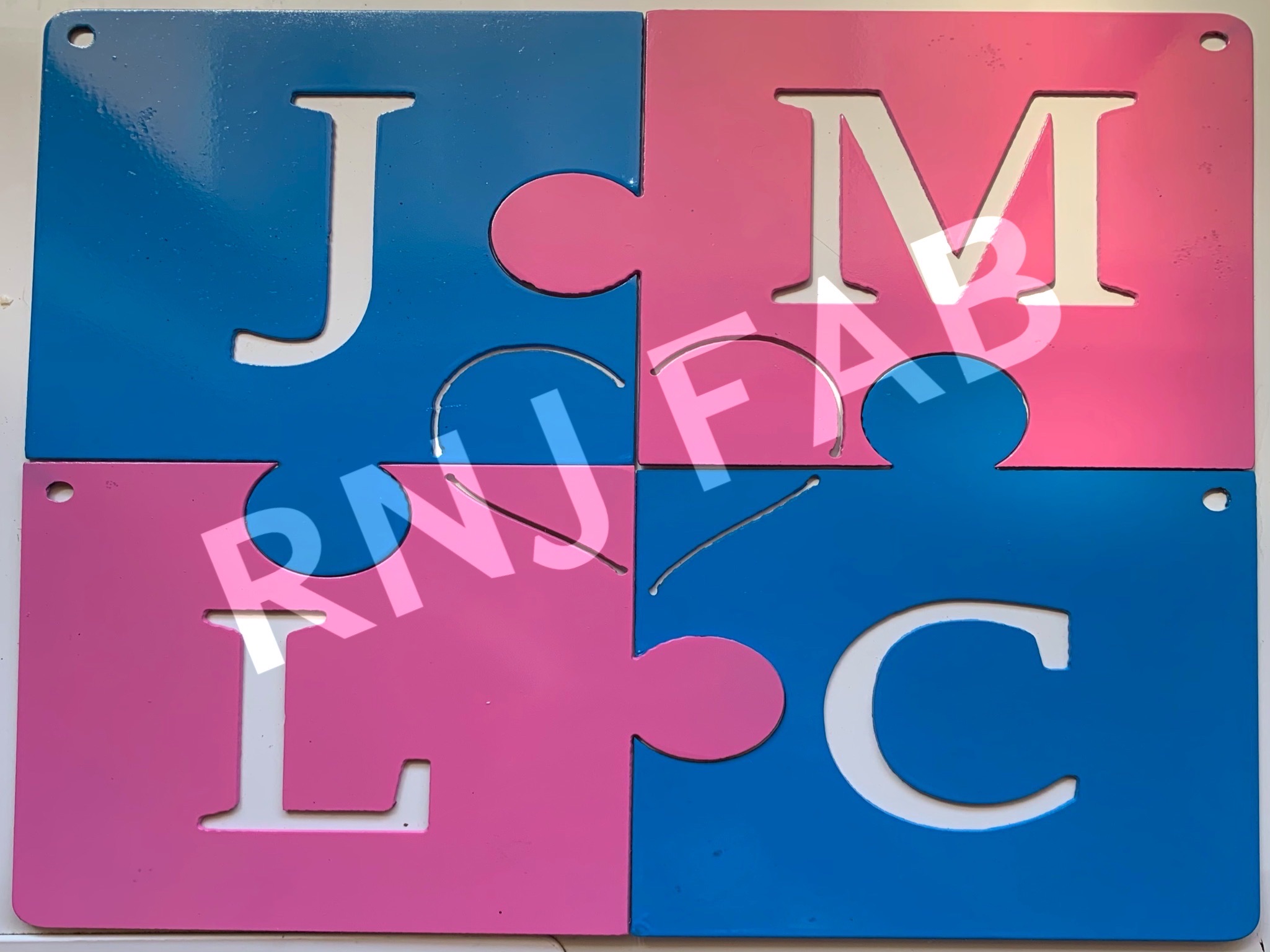

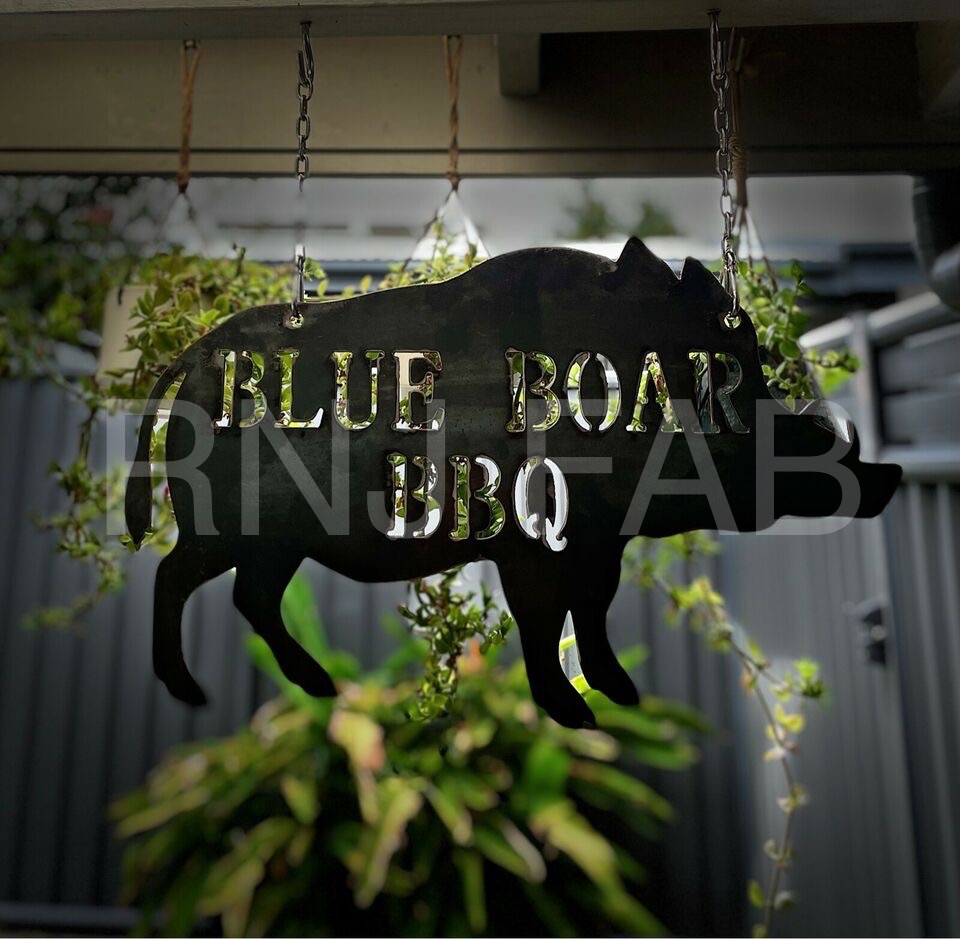

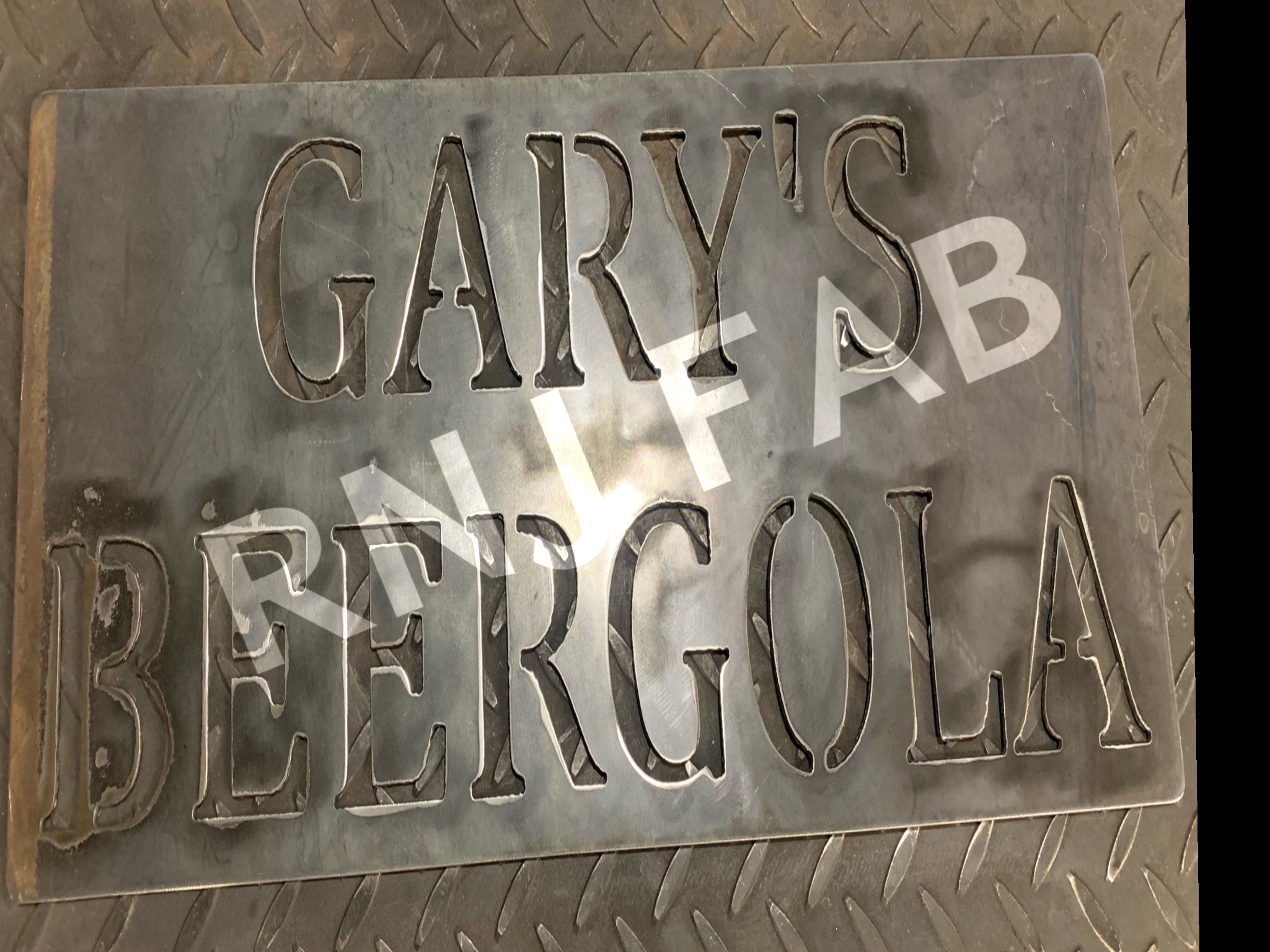

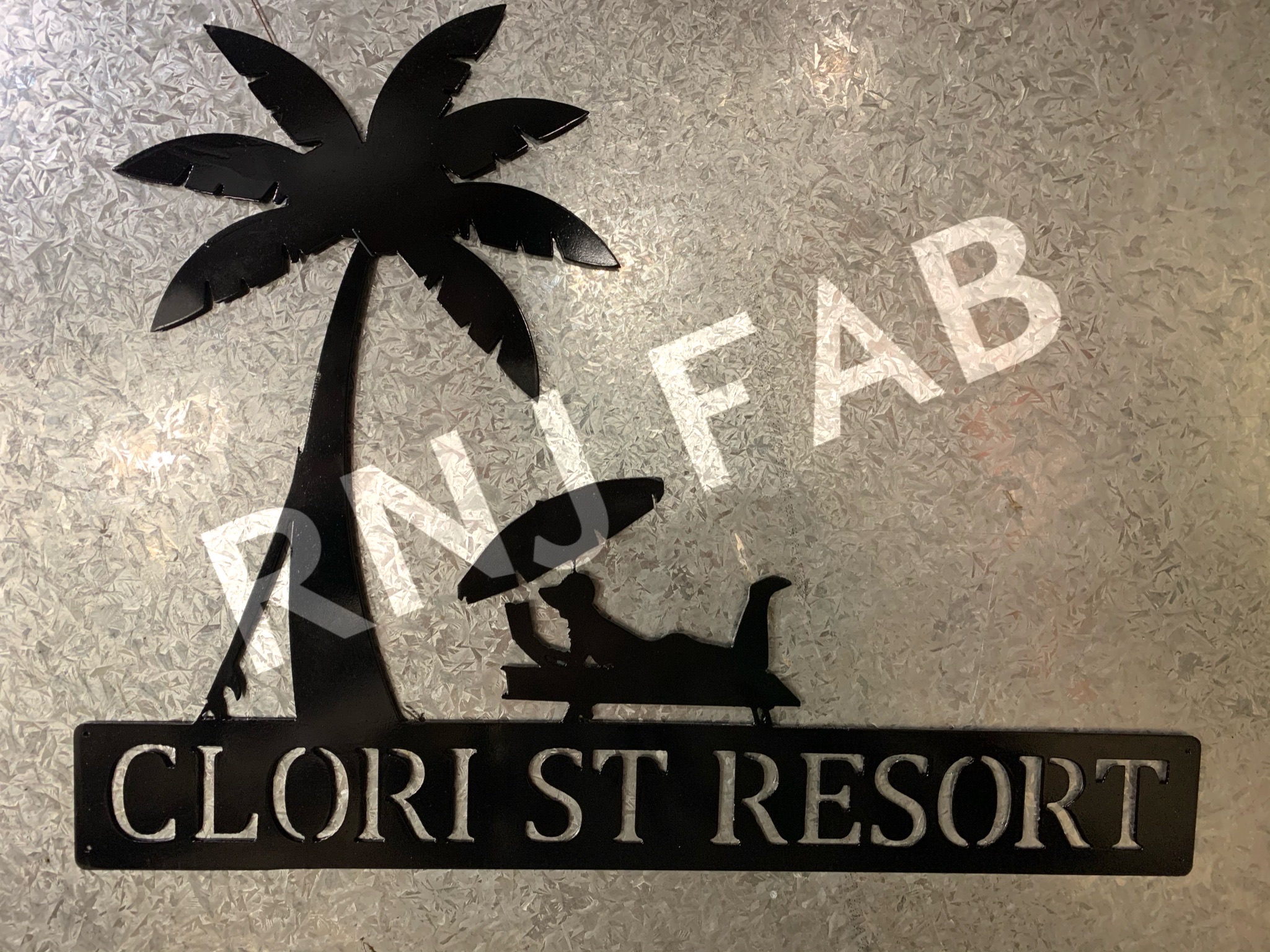

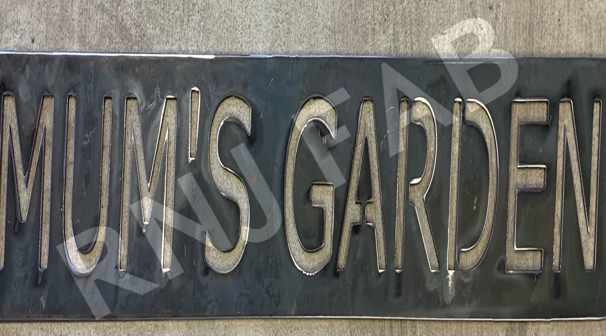

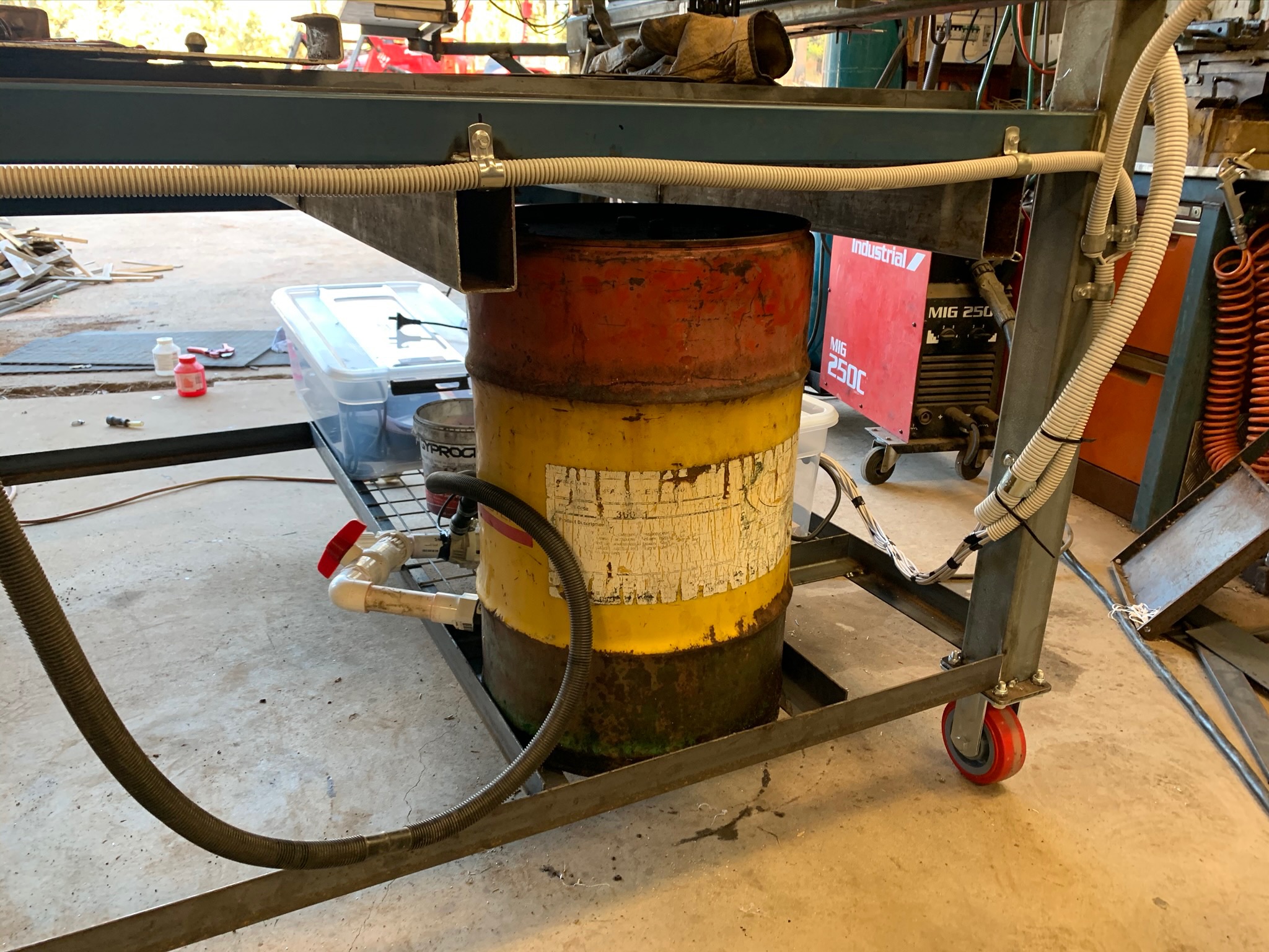

Once up and running it worked great for what it was, a sub $2000 cnc plasma, that had a cutting area of 1200x1200, using the cheap Cut50 plasma capable of 6mm steel cutting.
This worked great, although there were quite a lot of adjustments and modifications that were made over the next 6 months to improve flaws with the initial design. New gantry to stop pitching, multiple z axis remakes, deeper waterbed, adjustable slat holders, water tank, pluming, control box, THC, etc.
Some of the little signs I was making.

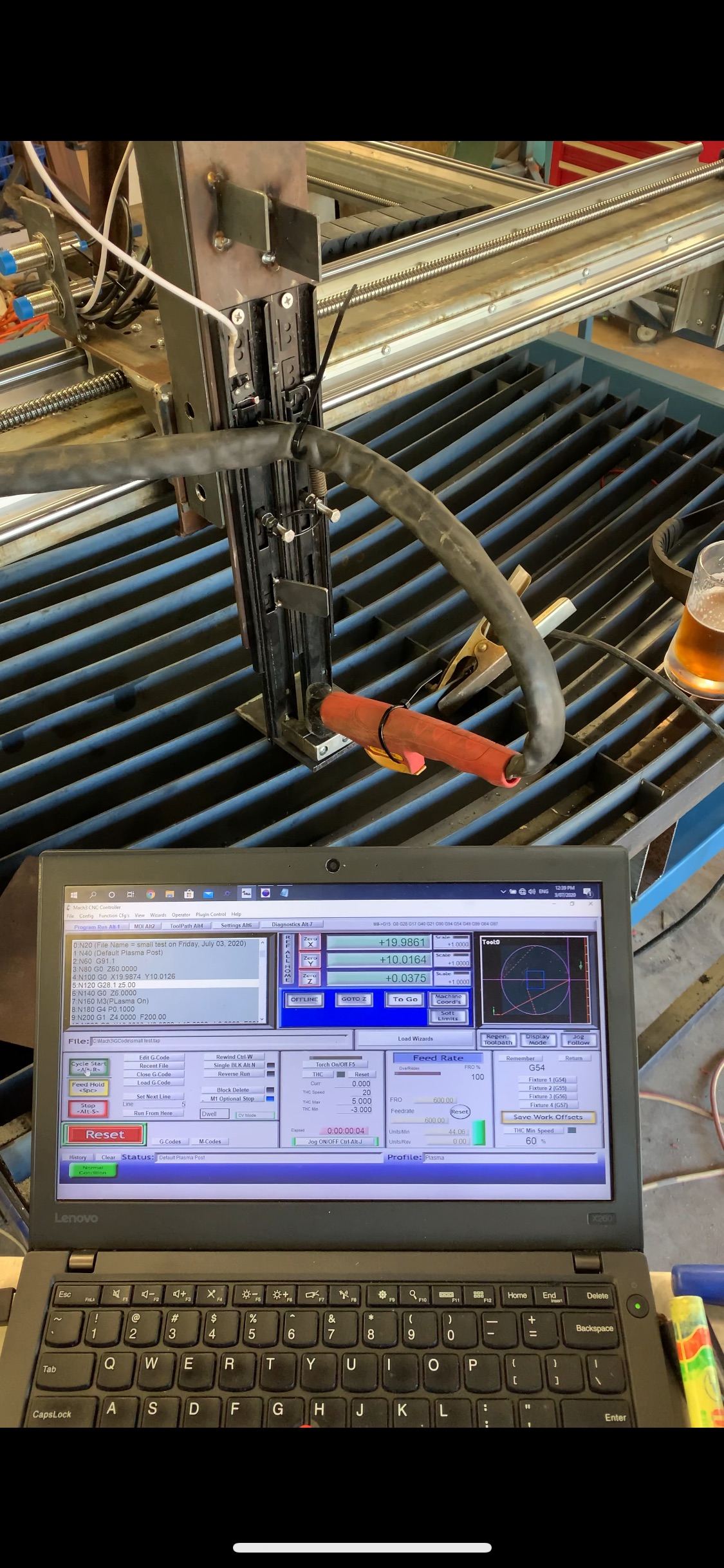

Fast forward a few months and I realise that I have reached the limits of Mach 3 and its USB board, at this point I started looking for what other options were out there, I looked into a better board for Mach3 and in doing so looked for comparable systems with all the learned knowledge over the previous 12 months. It was around this time that Mach3 started to hiccup and I was loosing sheets of material as a step would be skipped or the alignment would go out causing an entire sheet of cutting to be wasted.
At this point I discovered LinuxCNC and some of its capabilities, scared because I'm not super programming inclined (like most of you smart people here) and worried that it would be too big of a transition, I delayed this for about 6 months. Finally after meeting a fellow forum user (and Linux master - RodW) I was ready to take the plunge into LinuxCNC.
I went with a MESA 7i96 board with THCAD10. This was chosen for price and my level of machine inputs and outputs (10 inputs, 3 outputs). The inital changeover was full of headaches, physical connections were straight forward based on the information from manuals and this forum, however the Linux setup proved too much for me. At this point I somehow managed to wipe my laptop trying to dual boot with windows and Linux (I'm blaming lack of sleep leading up to this). At this point I was done, exhausted, brain fried, 12 months worth of drawings, cut files, tool settings, etc, gone, lost.......

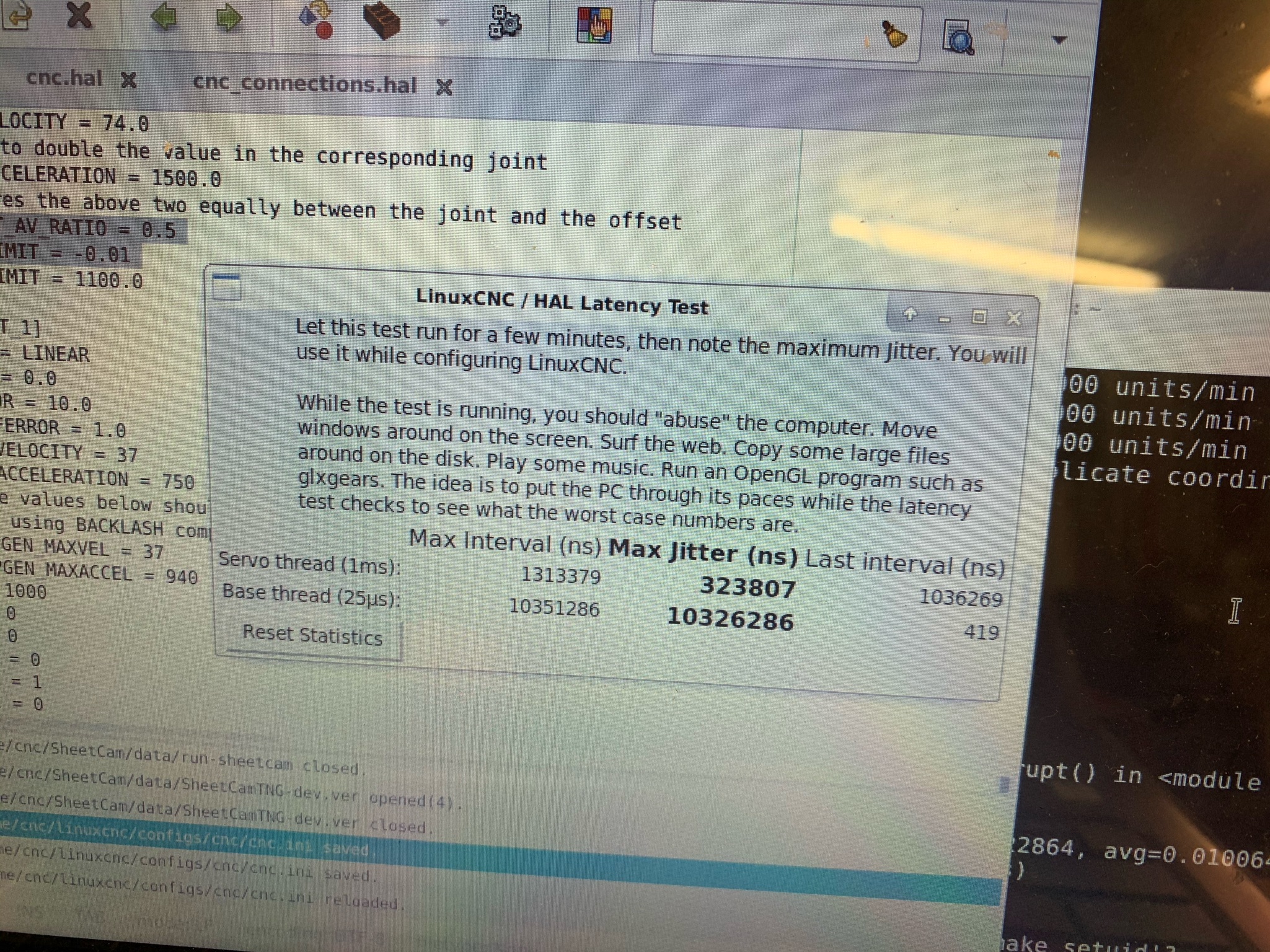

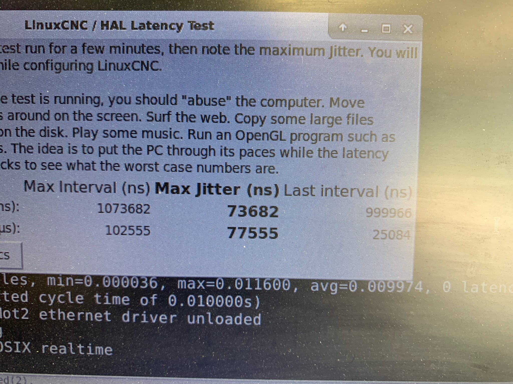

So with a new laptop capable of Linux, I started to load everything, first problem was the latency tests, these were coming back at around 10 000 000. Yes 10 million, way too high for LinuxCNC to run. The IT guys did everything to get the laptop to work (I chose a laptop as I wanted the touch screen) but we were unable to get latency under 5 million until we changed a bunch of bios settings and turned off some of the systems in the back end of the laptop. This got us down to under 1 million which was ok for us to get a connection.
With the help of RodW who came out and helped work through a series of my mistakes, we were able to get a machine that moved, it didn't work but it did move. Victory I thought was close. WRONG.

did you have a real-time kernel installed?
getting jitter like that implies not using the RT kernel
