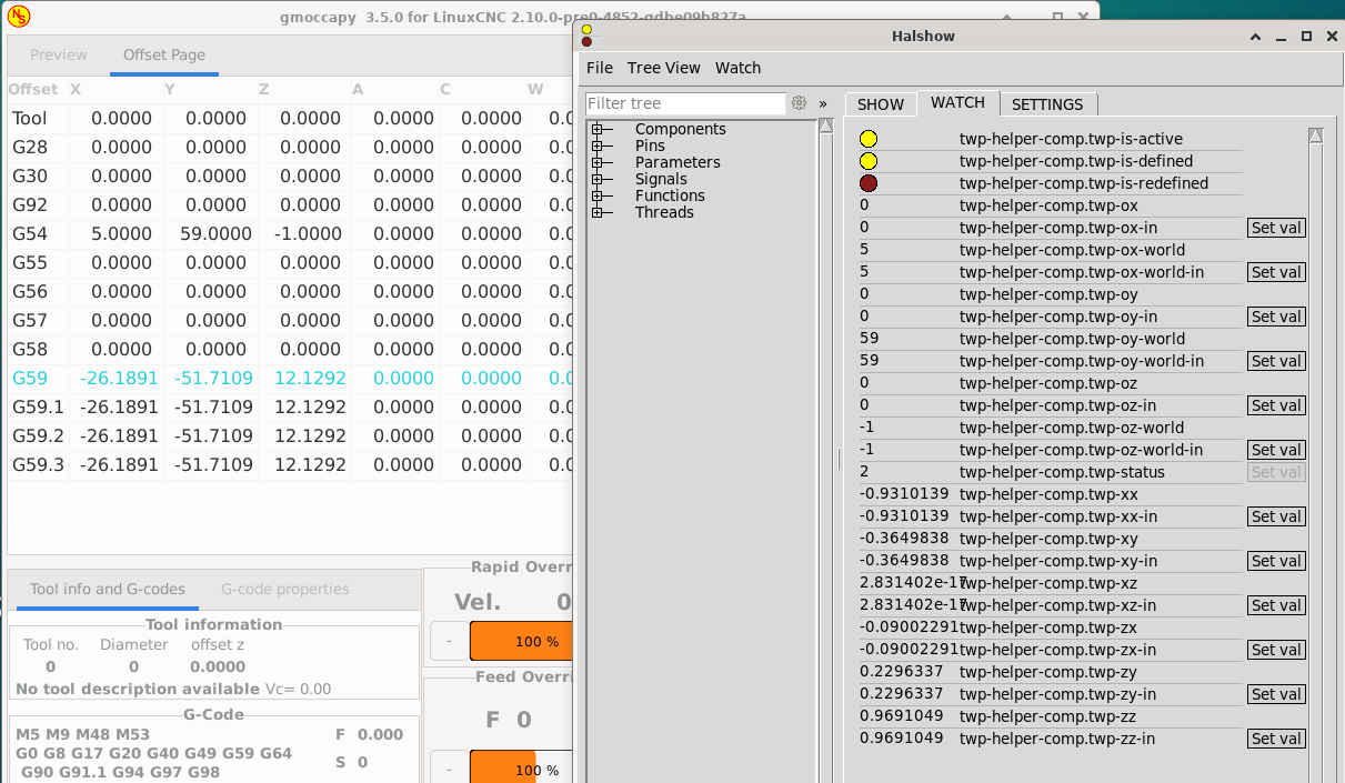

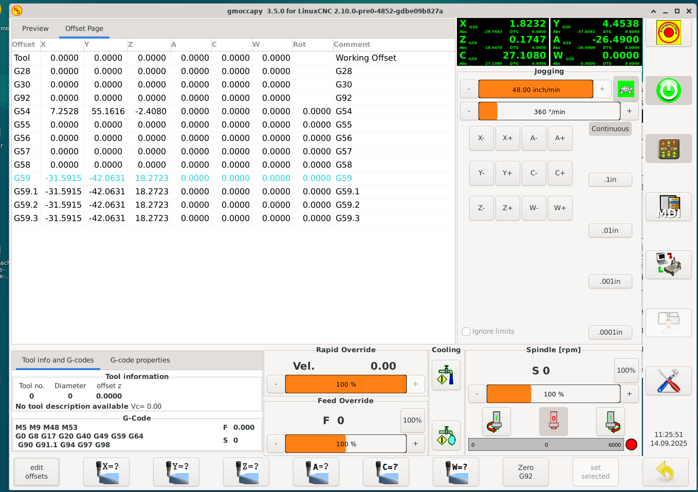

I was able to test this out a bit today and I've figured out it wasn't working because after setting the TWP, the G59 offset made the axis positions outside my soft limits,  I made my soft limits massive and it worked as expected.  If I have G54 zeroed out, then I don't get any values in G59, but my axis position are still outside the soft limits.
I've been digging through the remap.py trying to figure out where the G59 offsets are coming from and I can see where it sets them around line 863, but I'm not sure how it's getting it's value.  It looks like it's passing the G54 offset value to to the twp-helper-comp.twp-ox-in correctly, but after that I'm not sure what to check.  Any idea what I should be looking for?
Ah yes, I'm sorry I have not caught onto this before,  this is expected behavior, which is unavoidable since the motion planner lives in cartesian space and assumes that each joint is aligned with its assigned axis which is no longer the case when the work coordinate system is rotated and thus no longer aligns with the machine coordinate system. Joint limits will be respected but are only triggered at runtime (ie when the joint position violates the limit) and will thus trigger an emergency stop.
It is possible to expand the axis limits when switching to TOOL kinematics and change them back to restrictive values when switching back to other modes but you will have to expand axis limit values when using TWP.
