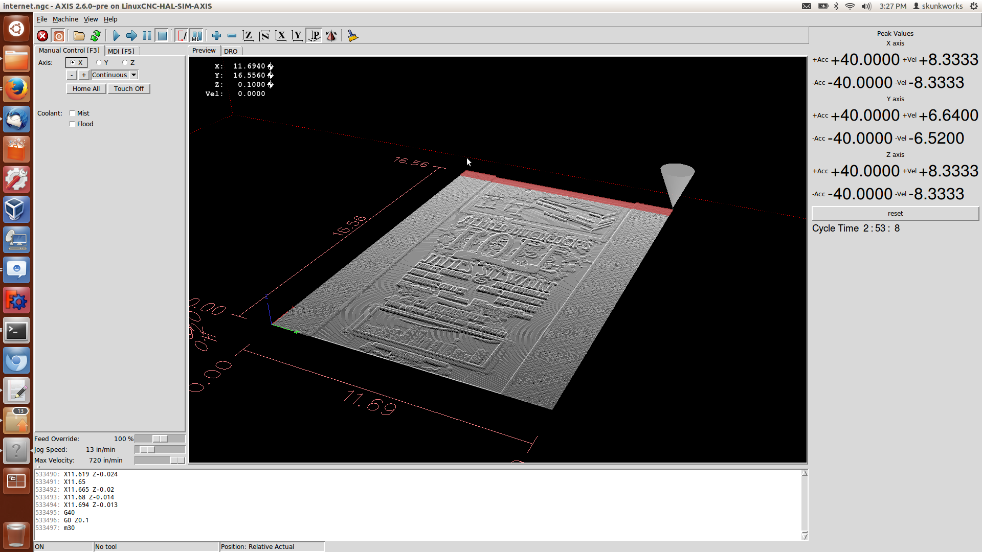

My first tests, with g64p0.005 were actually slower with the new TP than the old on the file I was using. Adding q0.005 only shaved 3 min off a 25min runtime and without it it was that much slower. Tomorrow I still need to retest it with the old TP and the same g64 settings, to try and get a better apples to oranges comparison.

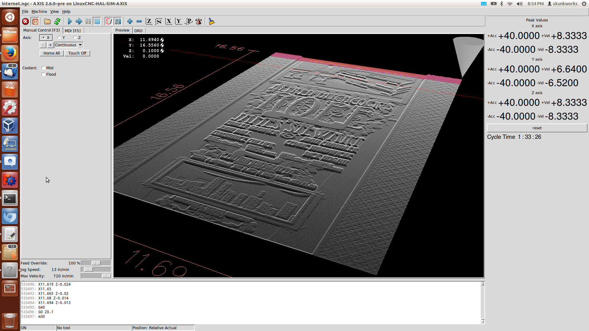

what kind of gcode? If there are a lot of non-tangent arc-line or arc-arc segments - it will run pretty closed to the current TP. Those type of segment transistions are not handled yet and fall back to the current parabolic - 1 segment look ahead.

I have only been testing it virtually so far.. I have a router that I need to play with soon..
This program I have attached would probably be a good program for testing your non-tangent arc work...
(if I have not posted it already...) Lots of arc-line for sure..
