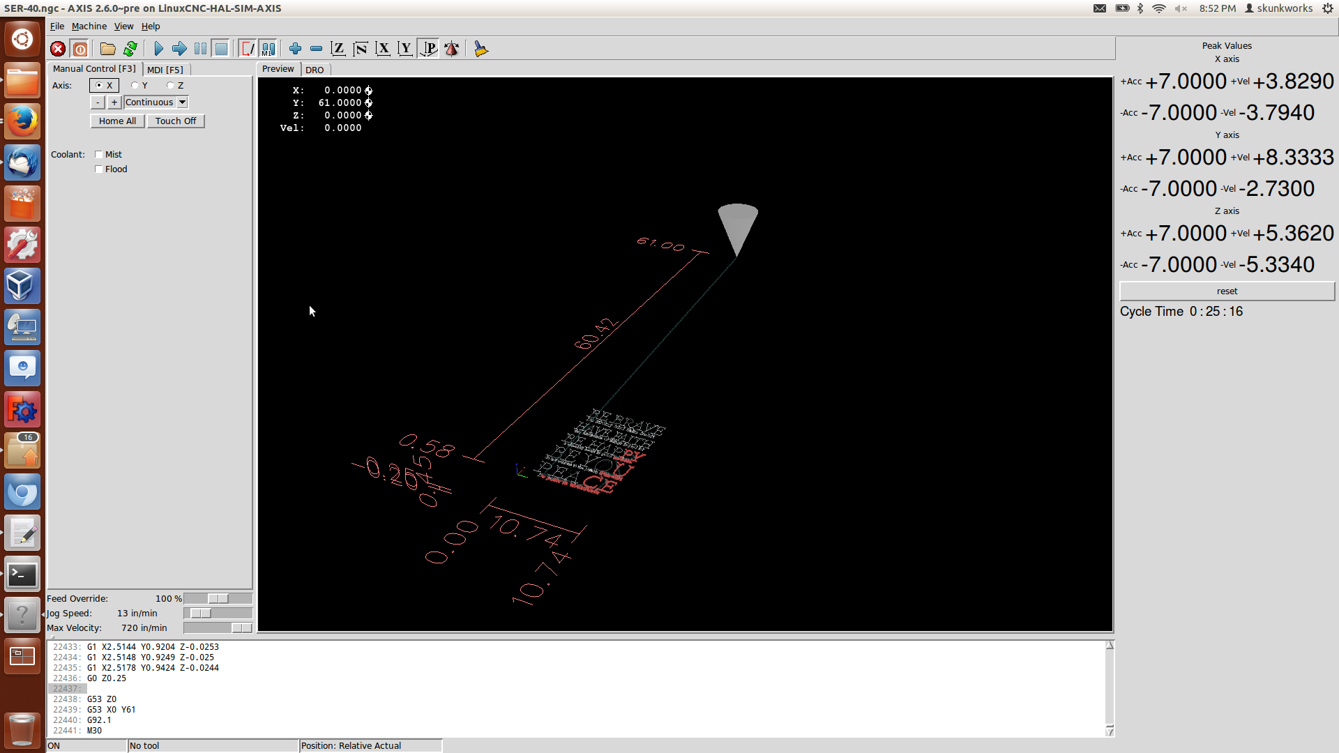

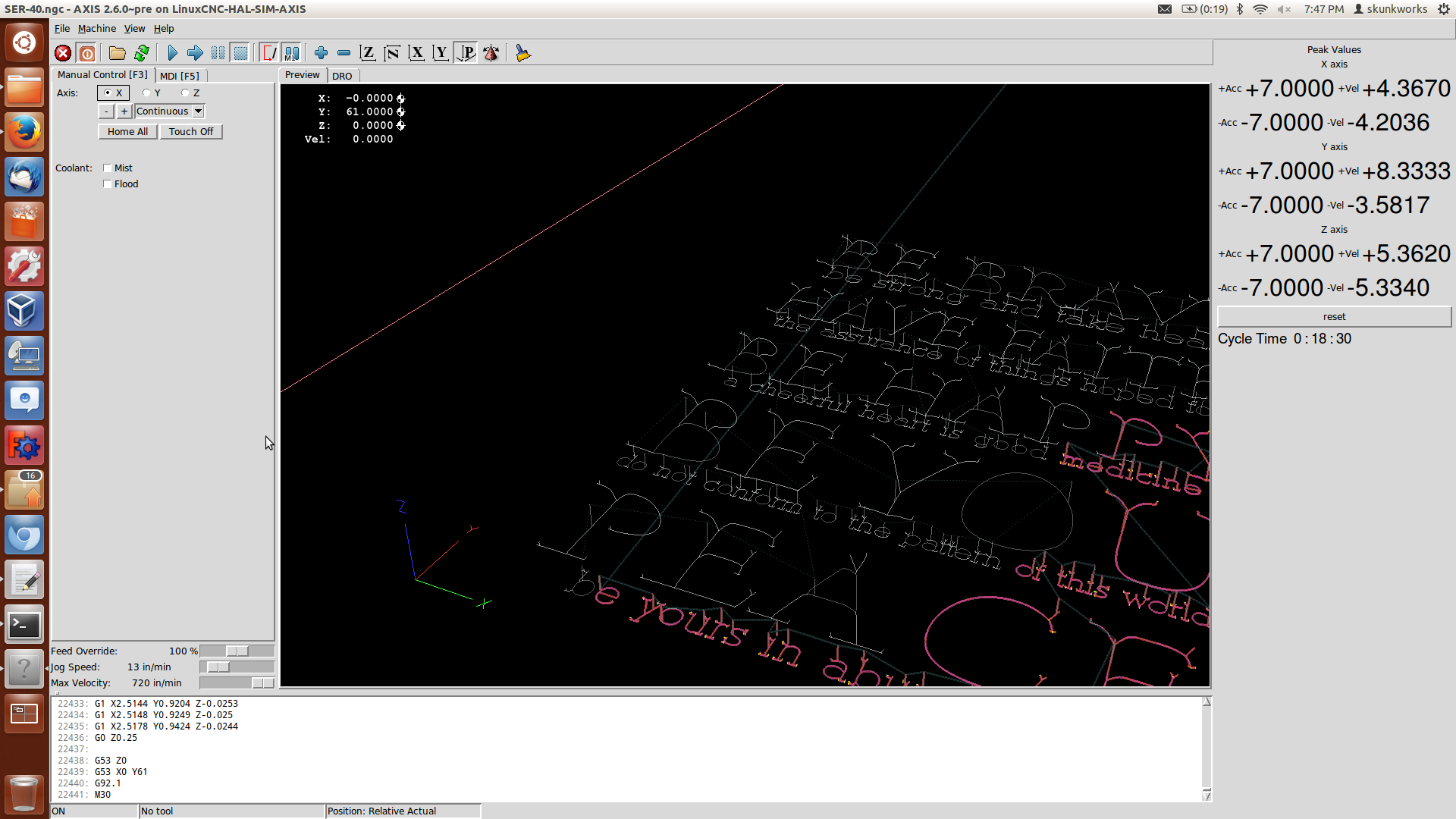

I did a quick test with your program. I just set my config to 7in/sec^2 (my max velocity is set to 500ipm vs I think your 600ipm) There is a lot of shuttling time between letters - that is really going to make the two tp's run closer as long strait runs are going to run close to the same between the two. Still - I think that is quite an improvement.. Did you put the needed lines in the ini?
ARC_BLEND_ENABLE = 1
ARC_BLEND_FALLBACK_ENABLE = 1
ARC_BLEND_OPTIMIZATION_DEPTH = 50
ARC_BLEND_SMOOTHING_THRESHOLD = 0.4
Old TP - 25min - 16sec
New TP - 18min - 30sec

13 Feb 2014 11:48 #43814
by skunkworks
Replied by skunkworks on topic New Trajectory Planner - Testers/programs wanted
BTW - you can really see the improvement in the O in YOU. On the old TP and 7in/s^2 acc you barely got to 40ipm (programmed feed is 100ipm). With the new tp - it accelerates up to 100ipm and keeps it all the way around.
Cool beans!
sam
Cool beans!
sam

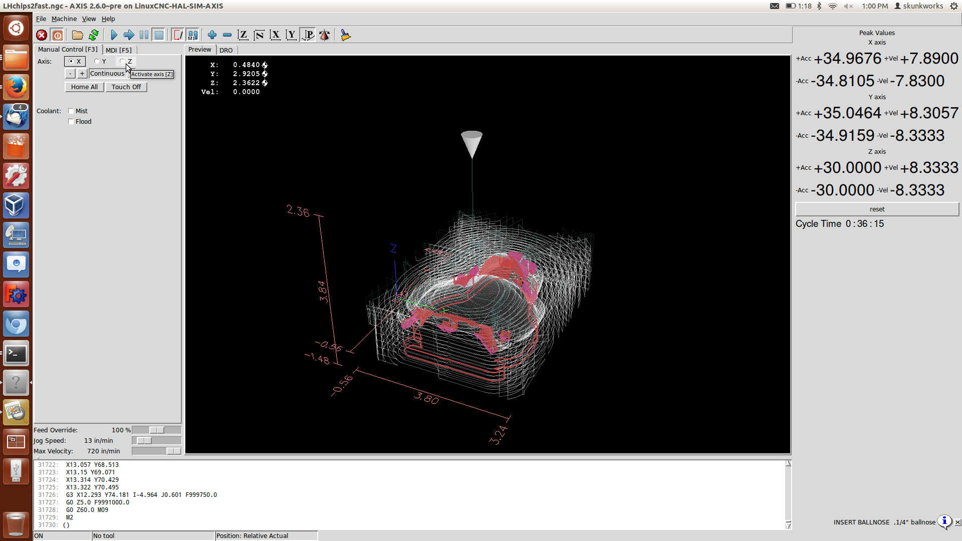

25 Feb 2014 03:48 #44153
by skunkworks

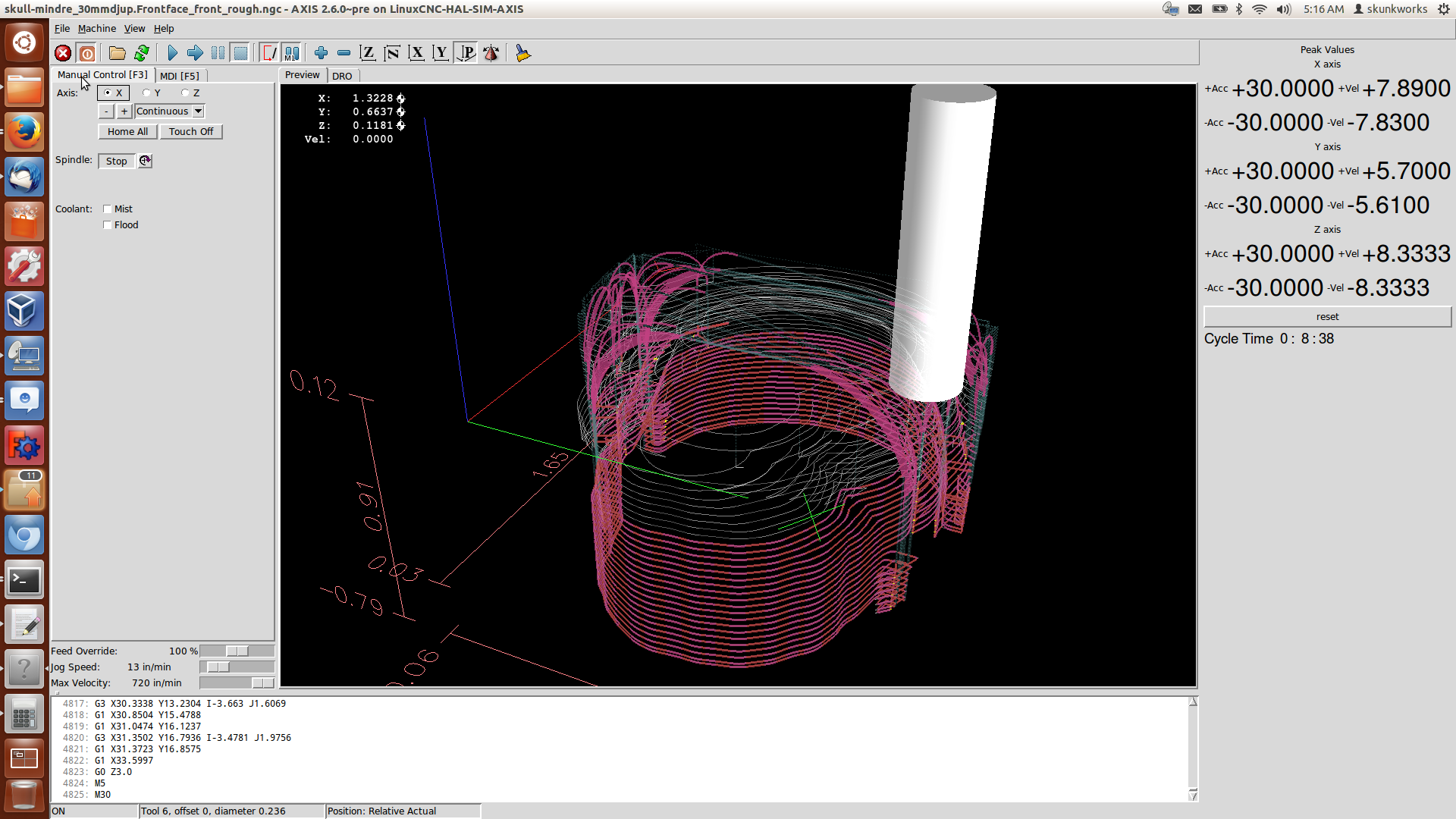

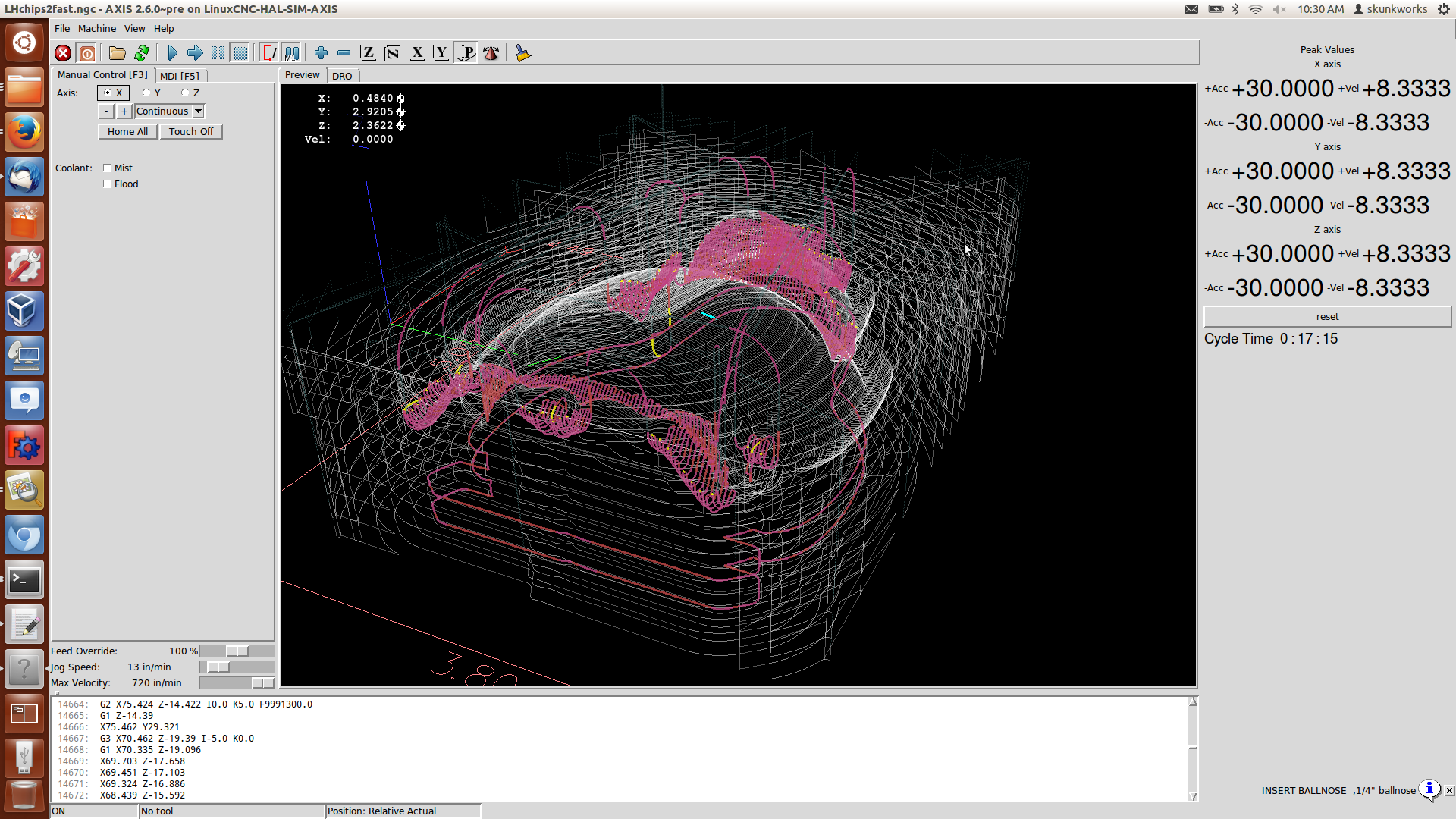

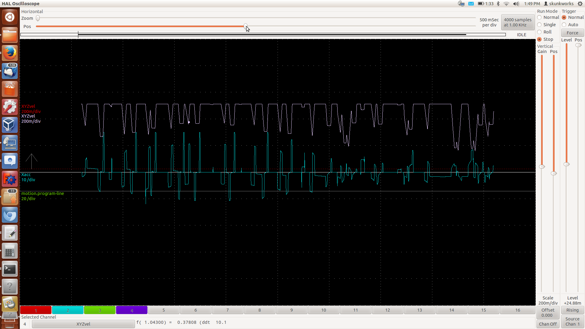

- skunkworks
- Posts: 351
- Thank you received: 153
05 Mar 2014 03:56 #44409
by skunkworks
did you add the ini settings?
[TRAJ] section
ARC_BLEND_FALLBACK_ENABLE = 0
ARC_BLEND_GAP_CYCLES = 4
ARC_BLEND_RAMP_FREQ = 20
Depending on your acceleration - I think the path should be a lot smoother.. Using my config - 30in/s^2 (it ran a little over 1 minute faster.
This is current tp..
This is new tp.. It keeps the velocity up
[TRAJ] section
