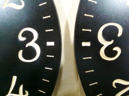

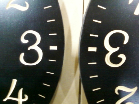

09 Jan 2014 23:15 #42547
Replied by Todd Zuercher on topic New Trajectory Planner - Testers/programs wanted
I know that the axis A-W don't are not included in the new planner (yet). But I did notice some sort of bug there.
When running with the new traj, planner installed and using the the Z and W axis, the W was over shooting some of it's moves.
See the attached pictures.
Picture of Z carving Old on left, New on right.
Picture of W carving Old on left, New on right.
Both W and Z were carved at the same time using the same code on the same machine, new planner first old planner second. Both runs took approximately the same amount of time

awesome! well - not awesome but this is the stuff we are looking for.
Is the program you posted above exhibiting this issue?
