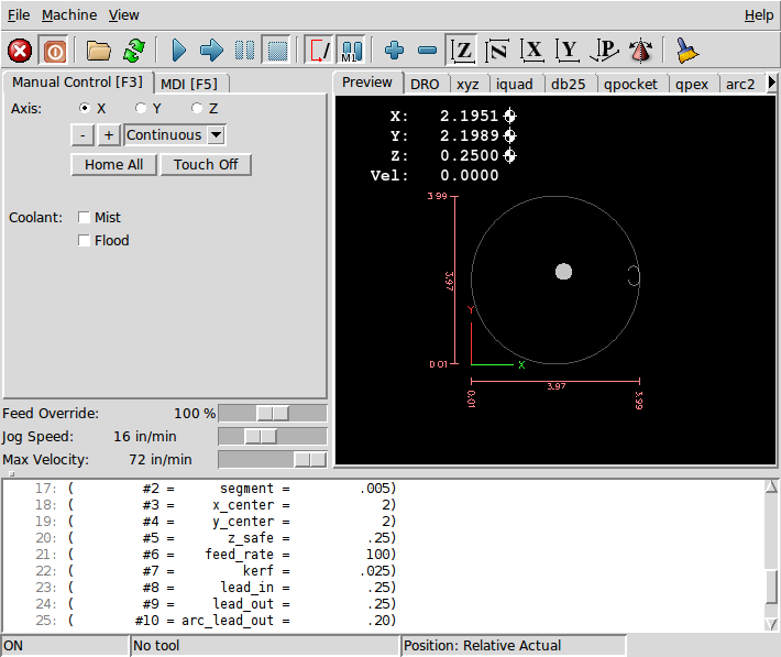

Here a NGCGUI sub was used to compare the original and the new TP.
It is useless code but might show some differences and offers an easy way to try different variables.
The NGCGUI sample configuration was used.
To exaggerate the differences the acceleration of the X and Y axis was set to an extremely low rate of .05
Set for inches.
Use MDI to set G64 Pn Qn before running.
This test was done with G64 P.001 Q.001
There is a move to the start location, a lead in Arc then a circular path made of segments and finally a lead out arc.
The velocities
Original TP...
Lead in arc max 4.74 slows at end to enter circular path.
Circular path max 3.82 - 3.32
Lead slows to 1.5
New TP...
Lead in arc max 3.32 slows at end .04 to enter circular path.
Circular path max 5.24 - 5.02
Lead out slows to .05
Highest circular path speeds at 45/135/225/315 deg when X and Y are both moving closest to the same rate.
There appears to be a dramatic increase in the circular path speed 3.82 vs 5.24.
The transition from arc to segment and back again appears to cause more of a slow down.
To try some text samples NGCGUI and true type tracer might be used.
As a side note auto homing seems to ignore the acceleration settings on some moves in both cases.

24 Jan 2014 20:07 #43124 by skunkworks
Replied by skunkworks on topic New Trajectory Planner - Testers/programs wanted
I think there, and rob will have to weigh in here, that the first and last segment do not get blended well yet. (so your lead-in and lead-out arc probably slow more than previously..)
You can see it if you would run a program like
(1" square with rounded corners)
G90 G54 G20
g64
G0 X0 Y.25 Z0
G1 Y.75 F999
G2 X.25 Y1 I.25
G1 X.75
G2 X1 Y.75 J-.25
G1 Y.25
G2 X.75 Y0 I-.25
G1 X.25
G2 X0 Y.25 J.25
M30
if you run this the second time (to be sure the tool is starting at the begining of the line segment) - you can see it slow down at the start of the first line-arc transistion and then again at the last line-arc transistion.
I know Rob has talked about this on the list and is looking at rectifying it. ah - found it
That's by design, though it's not optimal. I abort optimization if a
segment is already in progress , to prevent stepping on tp 's toes. Also,
the optimization doesn't run on the last segment in the queue, because that
segment has the potential to be shortened by a future blend arc.
Both of these problems are fixable. I was looking into how to detect "end
if file" in the code, and it seems that the interp_waiting state
corresponds to the interpreter running out of valid moves (rather than just
having a full queue). If this is the case, then a simple check should be
enough to flag the last move. Similarly, I could make blend arc creation
work on the unchanged portion of a segment in progress.

26 Jan 2014 02:34 #43162 by rellenberg
Replied by rellenberg on topic New Trajectory Planner - Testers/programs wanted
Based on feedback from the dev list, it may be difficult to fully optimize the last segment, since the TP doesn't know when a program is done, vs. just waiting on more commands. However, one workaround to this is to make your last move of the program a rapid retract away from the part. Since the last step in the part is no longer the last step in the program, you'll still get a smooth cut.
As for the homing issue, I don't think I've seen any violations myself, but I haven't been specifically looking for them during homing. My simulation configs have the homing process cut short, because I got tired of waiting 5-10 seconds every time I loaded the GUI. Nothing that I've changed in this branch should directly affect homing, but it's always possible there are unintended consequences.
