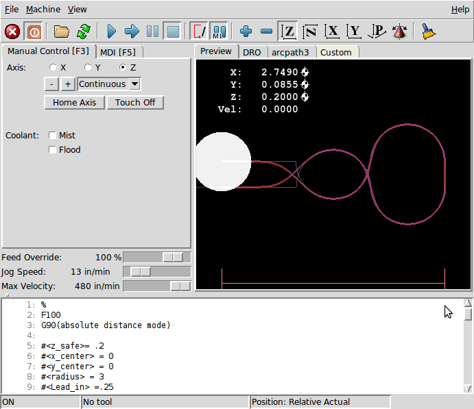

I noticed that your screenshots have offsets displayed in the preview pane.. If you turn them off in the view menu - it then displays the velocity. (it is a bug - there is a bug tracker on it)

Thanks for the tip! That certainly cleans up the screen a bit.

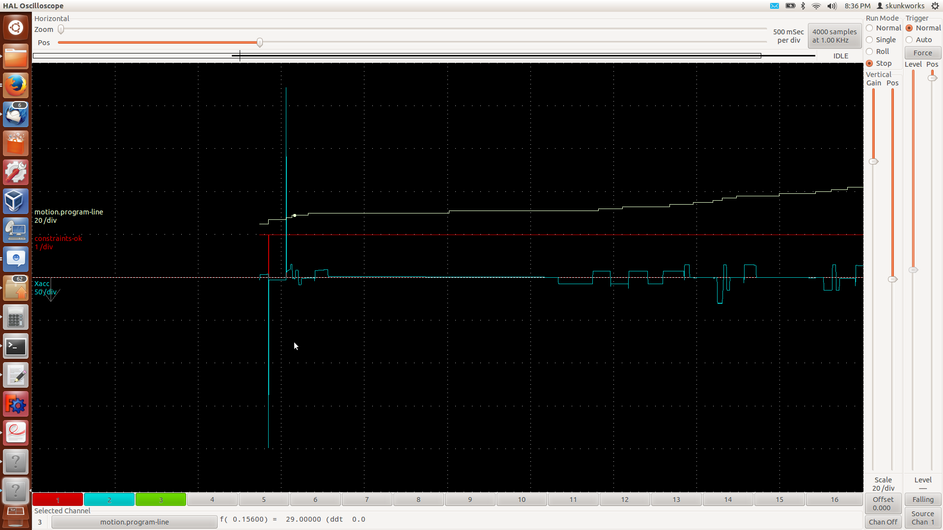

just goofing around - I ran steve.ngc - it had huge acceleration constraint viloations. Maybe part of your arc-line work?

That's strange, steve.ngc seems to run fine in my simulation and RT builds. However, I ran a big batch of tests and found a small overage on arc-parabolic-blend.ngc (attached). Is it consistently going over at a particular spot?

This is v2.5.3-2611-g9ea88c1
I get this running steve.ngc
sam
sam

here is the x axis - first at around line 25-27 and 27-28...
That is with steve.ngc strait G64
sam

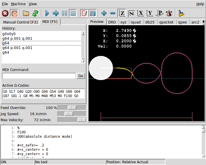

Rob,
I will update what I am testing this week. I did notice that end moves might be treated differently in certain circumstances.
Again I may not have the latest but here is the current TP vs the new with straight G64.
Rick G
I'm working on an update to push out to the beta branch that will fix this and a few other minor issues.
Rick G
