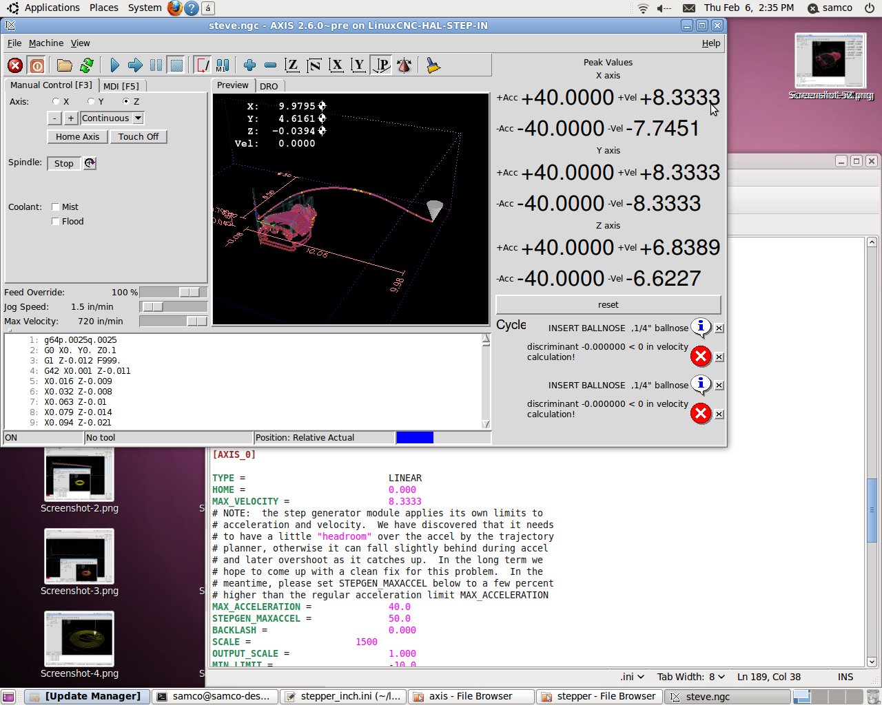

This is still the experimental branch - up to date as of today. This is a realtime build running stepgens (500ipm 40i/s^2)
I am getting a
Just a heads up. It doesn't happen in a sim build.. or some other configs - here is the files
electronicsam.com/images/KandT/testing/steppercon/
sam
I am getting a
sam

08 Feb 2014 04:15 #43627
by rellenberg
Replied by rellenberg on topic New Trajectory Planner - Testers/programs wanted
Ahh, good catch. I enabled some additional debug outputs, and that "error" is one of them. What that error means is that the trajectory planner has overshot slightly. However, the size of the error is quite small, so in practice it won't affect anything. This condition occurred in the original TP as well, but there was no message to say so. I'll disable that error flat in a future commit.

08 Feb 2014 04:44 #43628
by skunkworks
Replied by skunkworks on topic New Trajectory Planner - Testers/programs wanted
Cool - I have been running the experimental branch and have not seen an overage.. Very neat
I have a question (and maybe this is a bit vague and I can get more info later) I was running a program that someone had posted and it was running great at an acceleration of 500mm/sec^2. I was not seeing many fallbacks to parabolic blends. I upped the accelleration to 1000 and they started appearing more. Mainly on 90deg or sharper angles. Are parabolic blends faster at higher accelerations?

08 Feb 2014 05:07 #43629
by rellenberg
The difference in performance shrinks the closer to 90 deg. you get. Also, as the line segments get shorter, the maximum speed does as well, since we have to hit each segment at least once. The combination of those two effects could mean more fallback.
One thing to try is disabling the fallback entirely, to see if it runs faster or slower. The estimate of parabolic vs. circular arc speed is a guess, so in some case it may fall back even when it would be better not to. It would be really nice to isolate this with a simple case. I have a test file called "long-kink.ngc" that might work for this. Basically, we want a long segment, then a short segment at an angle, then another long one again. Comparing the velocity profiles for parabolic vs. circular arc would show which was actually better.
I'm working on a tech demo of line-arc and arc-arc blends now, but I plan to revisit this after that's out of the way.

08 Feb 2014 07:49 - 08 Feb 2014 07:51 #43630
by skunkworks
Can't wait to play with arc-line arc-arc... Again - great work!.
as far as my issue with falling back to parabolic blending.. I had been testing the sim mm-axis.ini in it it has
DEFAULT_ACCELERATION = 508
MAX_ACCELERATION = 1732
I have not researched it - but I thought default was like default velocity - but it uses it as the axis limit.. (and I don't know how it interacts...)
when I added the peak velocity and acc side panel - I notice it was only peaking at 508mm/s^2. (and doing parabolic blends on some of the corners)
I deleted the 2 lines (my other configs don't have them) and it ran with very little fallbacks..
sam
sam
