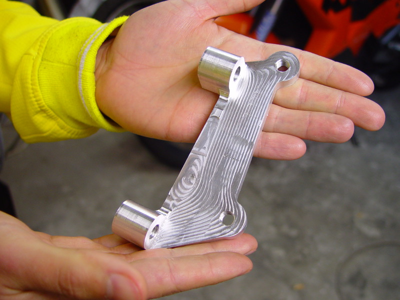

rellenberg: your TP did an extremely good job on these curved milling paths.
It managed to keep the feedrate up and, more important, constant through the curves.
Around 18000 blocks of G-code, milling time in total an hour or so.
With the default TP I would have to set the tolerances really loose to prevent constant acceleration/deceleration.

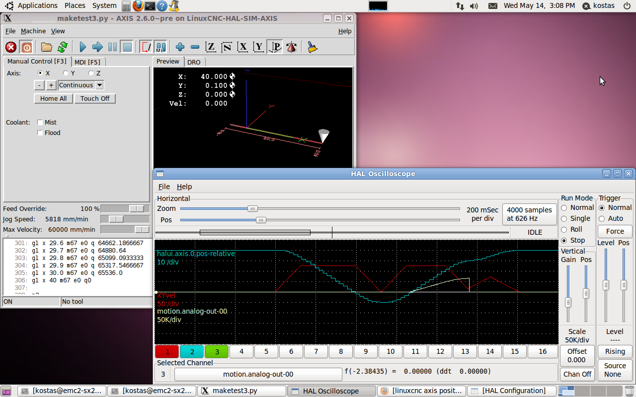

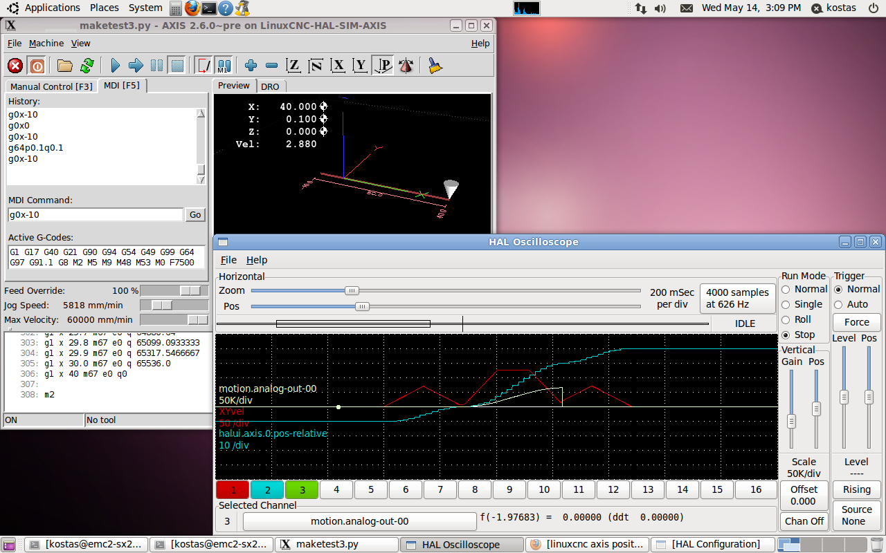

I'd also like to report a behaviour I can't understand. This small g-code program is treated differently from the planner, based on where the tool is located initially.
I'm doing some overscan before and after the line, so that the laser will have the correct velocity before it starts rastering. If the tool is located at the end of the line so that the "g0 x-10 y0.1" makes it move at rapid, everything works as expected, except for the last g1 which has an acceleration/deceleration of its own, which I also don't understand. The screenshot "laser_overscan_2.png" visualizes the moves.
As seen on "laser_overscan_1.png" though, the machine moves differently if the tool is already located at x-10. The first g1 x0 accelerates/decelerates and then accelerates again when it sees the rest of the g1s ..
Is this something normal I don't understand?

m2I'm doing some overscan before and after the line, so that the laser will have the correct velocity before it starts rastering. If the tool is located at the end of the line so that the "g0 x-10 y0.1" makes it move at rapid, everything works as expected, except for the last g1 which has an acceleration/deceleration of its own, which I also don't understand. The screenshot "laser_overscan_2.png" visualizes the moves.

I'm glad to see such a performance boost! The velocity dips you are seeing at the beginning and end are due to how the TP handles a "short" queue. The short story is, it's a known issue. It stems from the motion module not knowing the current interpreter state.
The origin of this issue is in the way we do lookahead. The velocity lookahead can only work on segments that have a known length. The last segment in the queue has a nominal length, but if another segment is added, then it could be blended with this new segment. In this case, the segment will be shortened. So, this means that we can only trust that the 2nd-to-last segment in the queue has a known length.
The current method code has a simple band-aid fix. If the queue is less than 3 segments deep, it assumes that the last segment will not be arc-blended, locks down its length, and runs lookahead over the queue. However, this means that a new segment added later will do parabolic blending instead of arc blending, which slows the motion down at that point.
Practically, it means that any time the queue gets very short, the blending behavior will not be optimal.

Ok, got it (partially
What I can't understand now is how it is affected by the queue at the beginning of the line, where the queue is not small (or I misunderstood something), but also how this does not happen after the rapid move. Also, it does not look like a non optimal blending, but more like a full machine stop there. Would a non optimal blending make the velocity go down to nearly zero?
My band aid is adding some small (1mm) g1s at the overscan area, so that the queue is always well filled!
My many thanks and congrats to your work! And the timing with my experiments was great also, so I'm really thrilled about it

Yeah, it's annoying because you get that hiccup when the queue is less than 3 segments long, which happens at the beginning of the program (as it's first filling up). This may also happen during "queue buster" commands like turning on/off the spindle.
