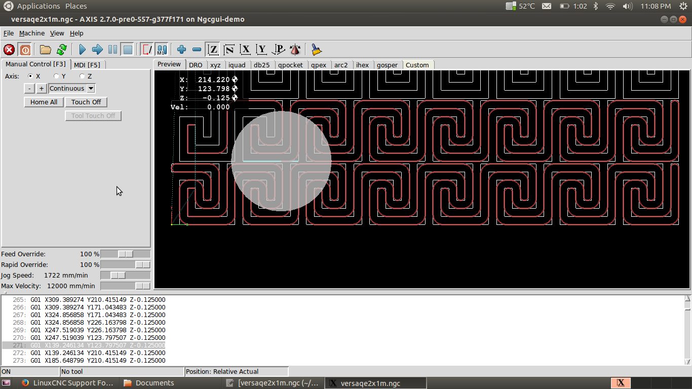

20 Jun 2014 04:31 - 20 Jun 2014 05:02 #48134 by tommylight
Replied by tommylight on topic New Trajectory Planner - Testers/programs wanted
Evening,
Last night i updated to 2.7 pre on one of my plasma cutters and .........it now makes ROUND corners all the way. :woohoo:
See attached pictures, on one is a pattern as it should and was untill the update, on the other is what i got today @ 2600mm/minute so it is even worse @ 3300mm/minute i usualy cut the 3mm mild steel plate.
All this is without any changes to anything, just updating from 2.5.4 to 2.7.
I have tried the G64 P0.01 with the same result, with G64 P0.01 Q0.1 again same, with G64 AND G61, still the same result.
I did just now try on this laptop ( diferent from the one on the machine ) , same result as the pictures show.
I will try to fidle a bitt with it and see if i can figure out what is going on and report back.
Also noticed that when i switch from Joint Mode to World Mode, the max velocity set in .ini file does not aply anymore, it will move above the set speed.
Later,
Tom
Update,
It occured to me that i read on several posts here that a Q0 after G64 should cancel naive cam detector, so gave it a try and low and behold, it works.
Thank you very much to all of you who are working and contributing to this astonishing piece of software, it is for all intents and purposes, a marvelous achievement. Personaly, i spent a lot of time learning the inner workings of it ( mainly HAL and setting it up as i acualy need it to be depending on the hardware), and i sure as hell don't regret it, i really am greatfull for it.
Last edit: 20 Jun 2014 05:02 by tommylight. Reason: Found solution
20 Jun 2014 15:50 #48141 by andypugh
Also noticed that when i switch from Joint Mode to World Mode, the max velocity set in .ini file does not aply anymore, it will move above the set speed..
It is possible that you would find better behaviour in the Joint_Axes5 branch, which will probably be merged into master in the not-too-distant future. This separates the concepts of axis limits and joint limits.
However, it may be that you just need to specify a [TRAJ] MAX_VELOCITY as well as the individual [AXIS] limits.
