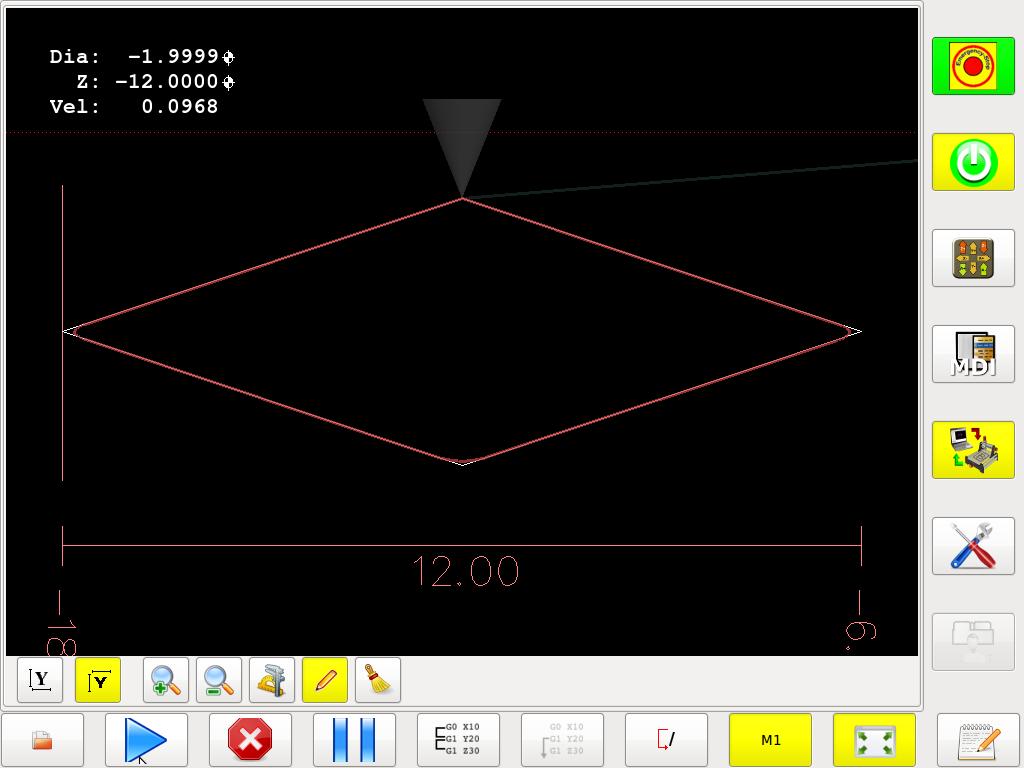

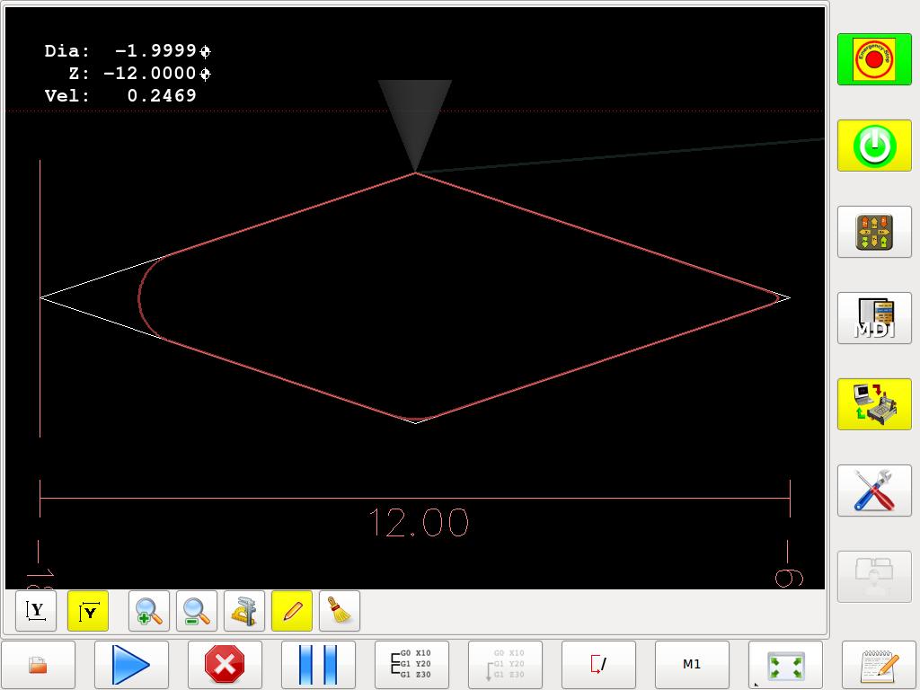

04 Aug 2014 22:14 - 04 Aug 2014 22:17 #49495 by LAIR82
Here are some pics of our turning center running the same program with and without the new TP enabled,
With new TP enabled
Without new TP enabled
And here is the gcode for this
G00 X-2.000 Z-12.000
G01 X-2.000 Z-12.000 F150
G01 X-6.000 Z-6.000 F150
G01 X-10.000 Z-12.000 F150
G01 X-6.000 Z-18.000 F150
M30
Rick

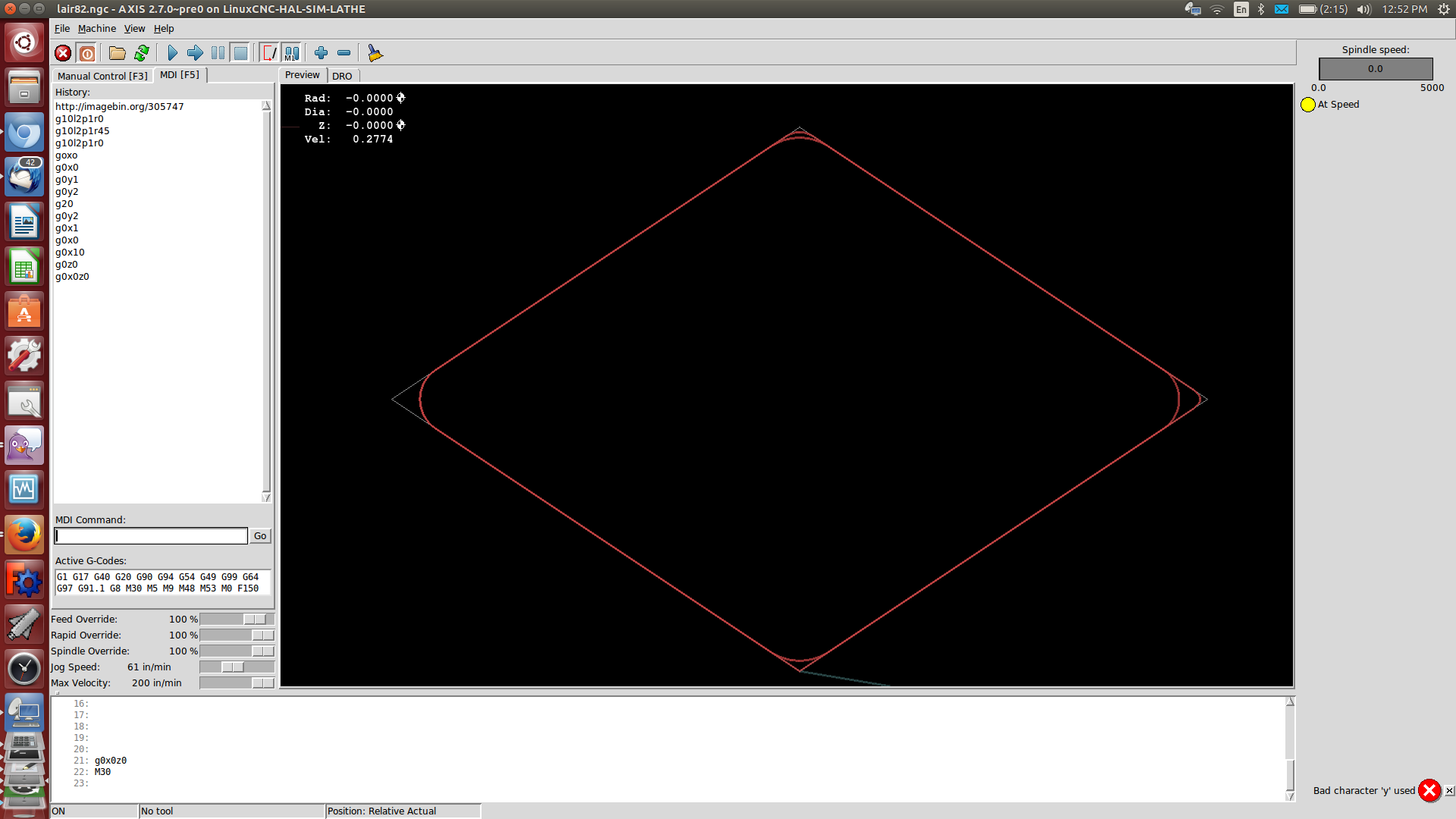

05 Aug 2014 00:57 - 05 Aug 2014 00:59 #49500 by skunkworks
Replied by skunkworks on topic New Trajectory Planner - Testers/programs wanted
You where on IRC and I think we hashed it out... What it is doing is queuing up moves to get to the maximum velocity. (it takes a few moves at the start to see far enough ahead - the way I understand it) So if we take your program and run the diamond part twice - you can see it rounds all the corners larger. With strait G64 (no tolerance) that is the radius needed to keep the velocity at 150ipm.
here is a screenshot of the diamond running twice.
So the moral of the story is - make sure you set a tolerance if you don't want excessive rounding... G64Px.xxx
sam

13 Aug 2014 18:46 #49807 by LAIR82

Sorry for the delay getting back to this,
We will definitely be getting that tolerance into configs, most likely into the INI so it is a set value. The operators never mess with G61/64 in their programs, so I am comfortable doing so.
Thanks for the clarification on this one.
Rick
