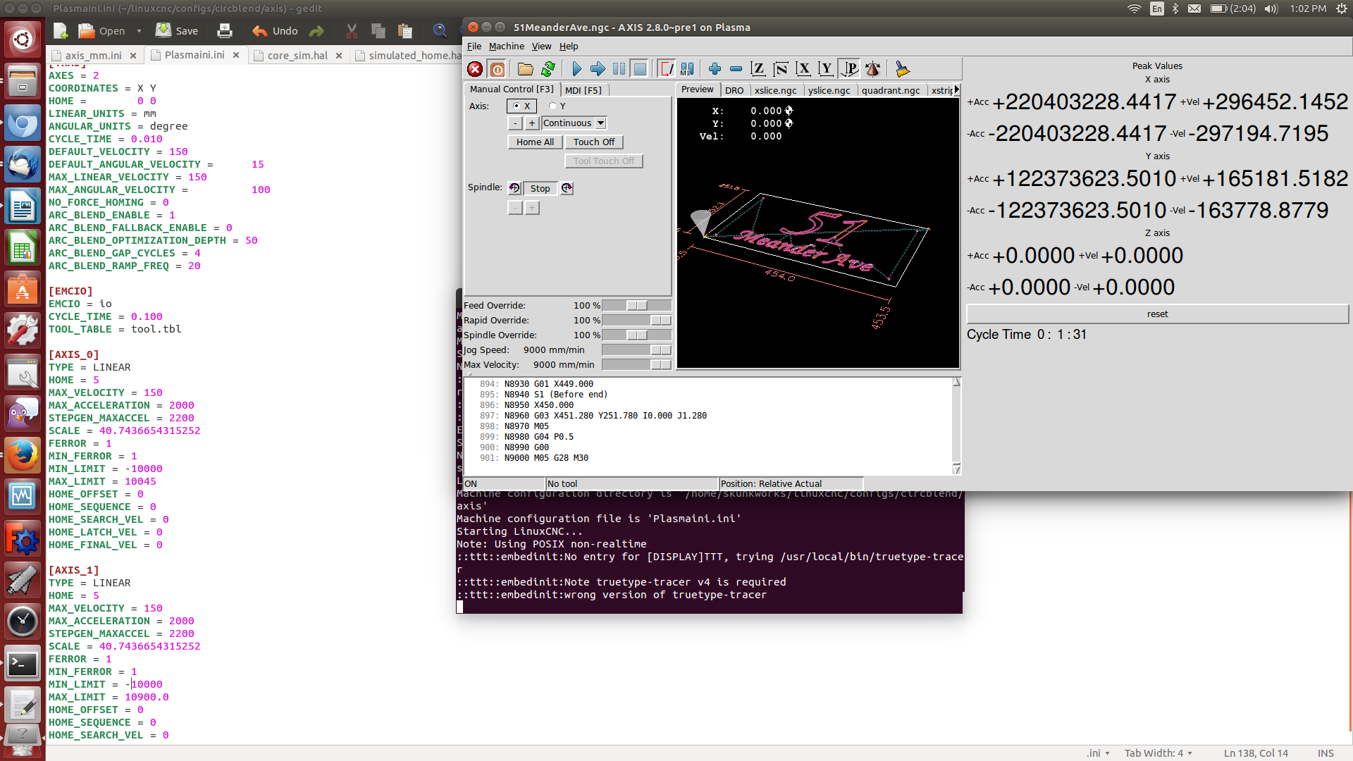

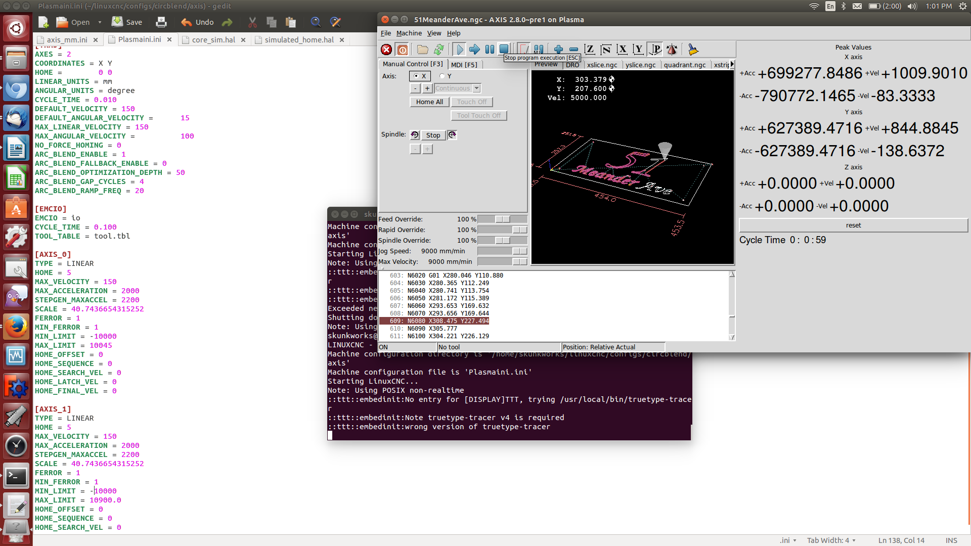

26 Dec 2014 03:27 #54306
by skunkworks
Replied by skunkworks on topic New Trajectory Planner - Testers/programs wanted
ok - it seems to have something to do with only having 2 axis. (X,Y)
I took the ini and hacked it enough to work with the constraint config. For me it happens twice in the program. also the XY plasma config runs considerably faster for some reason than the xyz config with the same acc/vel. Which seems a bit odd... we are talking to get the the first constraint violation - the XY config runs 53 seconds (end of r) and the xyz config runs at 1:12
something is a bit goofy..
Ok - tested a bit more.. It seems the reason the XYZ runs slower is that it takes into account the Z axis acc/vel (one or both) when doing XY moves. If I set the Z vel/acc very high both configs run about the same. (still no constraint violations with the XYZ config.
So I think there could be some performance improvement if axis that are not moving don't effect the motion. maybe
sam
sam

28 Dec 2014 06:02 #54325
by rellenberg
Replied by rellenberg on topic New Trajectory Planner - Testers/programs wanted
Nice work! I have a fix in the works for this. The code that checks for the maximum axis accelerations didn't properly handle the case of having fewer than 3 axes. It seems to be a simple enough fix on the TP side, though I still have to look canon. I'll have it pushed to a test branch off of 2.7 in another day or two.
