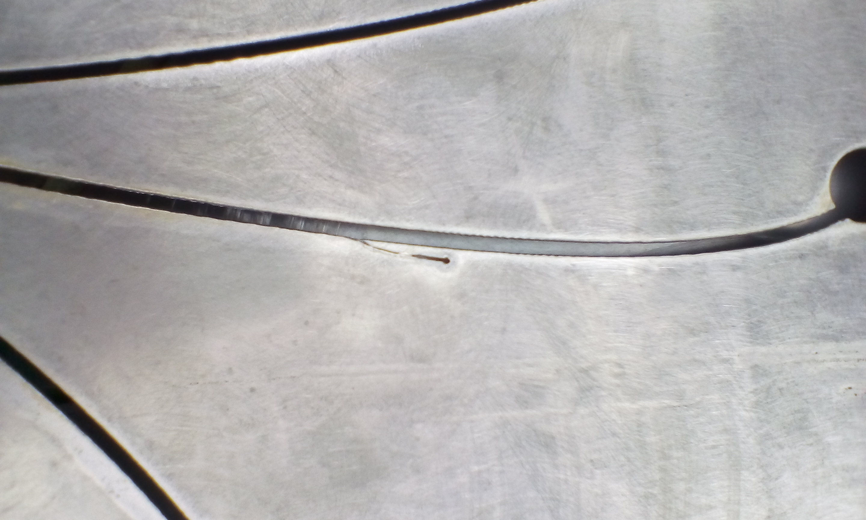

I have recently encountered a problem that is triggering a following error.
Please find a photo of my live tool plot here: https://goo.gl/photos/jyCbxXy7A5tJsKCq6 live plot
The problem occurs at the start of line 35 where it seems as though linuxcnc doesn't attempt to follow the arc. I have temporarily got this program running by setting ARC_BLEND_ENABLE to FALSE.
Please ask what additional information may be necessary and I will try to provide it.
Thanks,
Guy

- Quadro
- Posts: 8
13 Dec 2016 00:10 #84007
by Quadro
Replied by Quadro on topic New Trajectory Planner - Testers/programs wanted
I had a similar experience see picture it is as if the 'machine gets lost.
When it happen the first time we checked all the mechanical for binding in drive and checked steppers and power supplies etc. I then verified the gcode for an error all looked good, which now thinking about it white line appeared to be correct, the pink play back had veered off. i then homed all and proceeded to finish cut the same shape with 'run from here' to replicate the problem, it cut it without a problem. so we finished the rest of the sheet and i blamed it as operator error. Not happy with the defect we loaded another sheet and proceed to cut with same file and in the exact same spot it veered from the cut path. Then rechecked a what had before, reset the machine and cut out the rest of the sheet - no problems. So instead of wasting another sheet i found a piece of scrap and 4 shapes before the problem i ran the gcode to replicate issue didn't miss a beat. I then did a 'dry run' from the start of the gcode went through without an issue. I had another file to cut which is an exact mirror image so we ran that through - no issues. I still needed a flawless first sheet so i drove the machine with my finger hovering on the stop button and in the exact same spot it started to veer from the cut path but also what happens is it dramatically slows down. I was quick enough the stop it and recut the hole with 'run from here' and finish the job.
