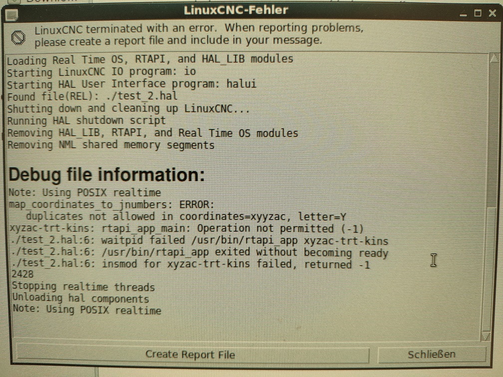

I referenced xyzac-trt-kins in my .INI-file. I have an XYYZAC setup.
After starting LinuxCNC it shows 6 axis as joints. After homing, it shows x,y,z,a and c. Nothing wrong there.
My problem: my joints are not moving correctly. X moves fine, but only one of my y-axis-joints is moving. When trying to move z, it is moving y2 and so on... I guess LinuxCNC "forgets" my gantry setup in the xyzac-trt-kins setup.
Any suggestions, what´s the issue?
I should add, that I am homing on the spot manually for test purposes.

30 May 2022 00:15 #244162
Replied by andypugh on topic TCP 5-axis kinematics
Are you passing the coordinate list to xyzac-trt-kins that matches your joint allocations?
Also, which version of LinuxCNC are you using? It looks like the version in 2.9 (unreleased development version) supports gantry axes, but the version in 2.8 does not.

31 May 2022 18:02 - 31 May 2022 18:23 #244300
by mittim
Replied by mittim on topic TCP 5-axis kinematics
I am sorry, I don´t know how to pass the coordinate list to the xyzac-trt-kins. Where can I do that?
Do you mean the assignment in the INI file as: KINEMATICS = xyzac-trt-kins coordinates = xyyzac?
Is there anything else I need to assign in the HAL file?
I am using LinuxCNC 2.9

31 May 2022 18:24 #244302
That's what I meant. Is it not working?Do you mean the assignment in the INI file as: KINEMATICS = xyzac-trt-kins coordinates = xyyzac?
31 May 2022 22:15 #244313
Try it without spaces around the = signs.

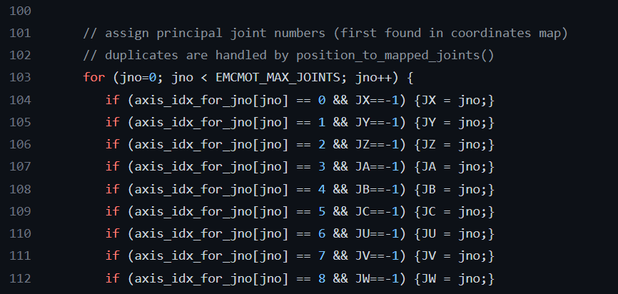

01 Jun 2022 11:12 - 02 Jun 2022 18:16 #244363
by mittim
Ist there anything I need to change in my hal file?
Getting the following error message.
Maybe hardcoding the trtfuncs.c could help? I would change the assignment of joint 3 from "JZ" to "JY2" and move any further joint according to that.
