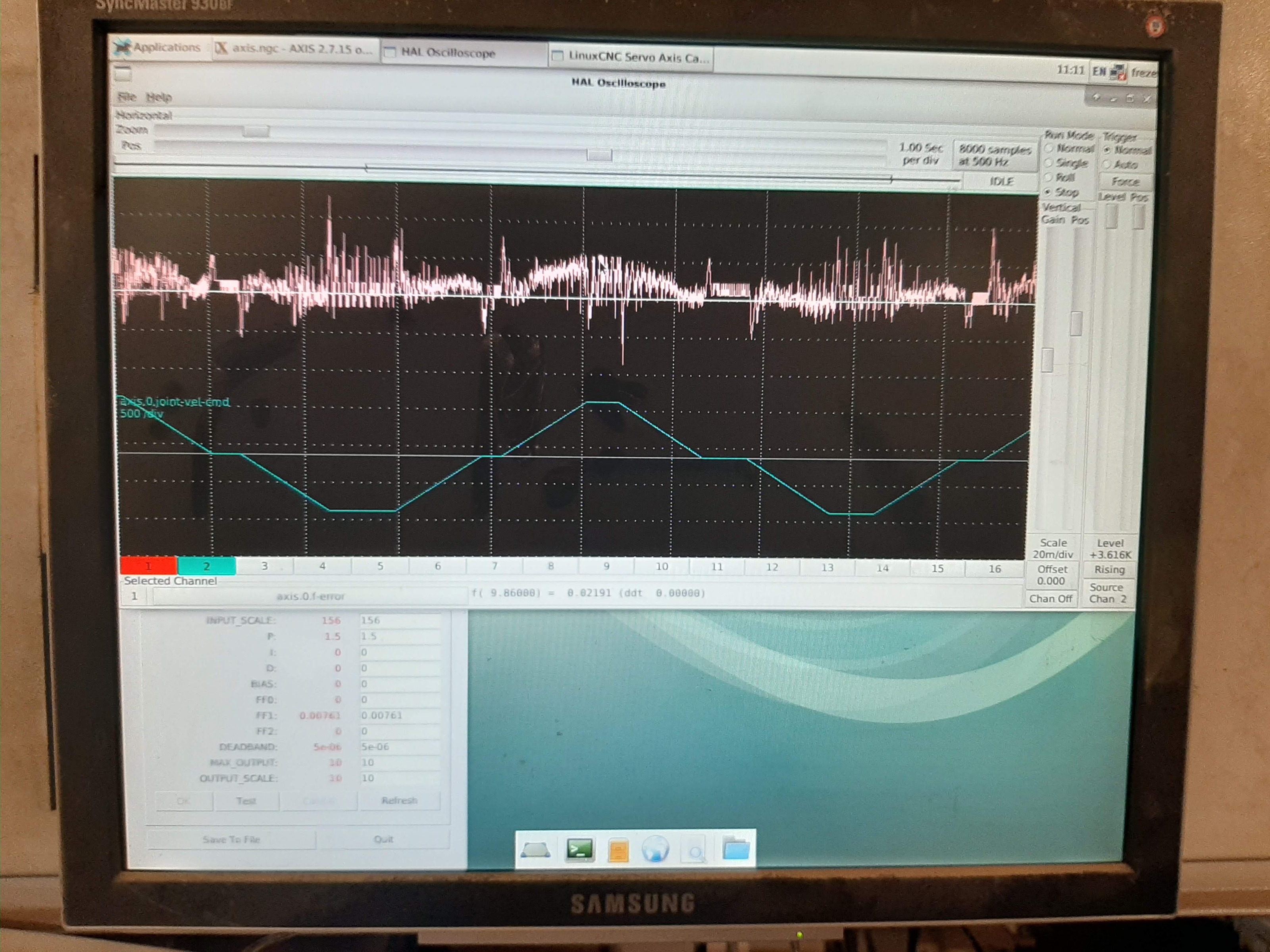

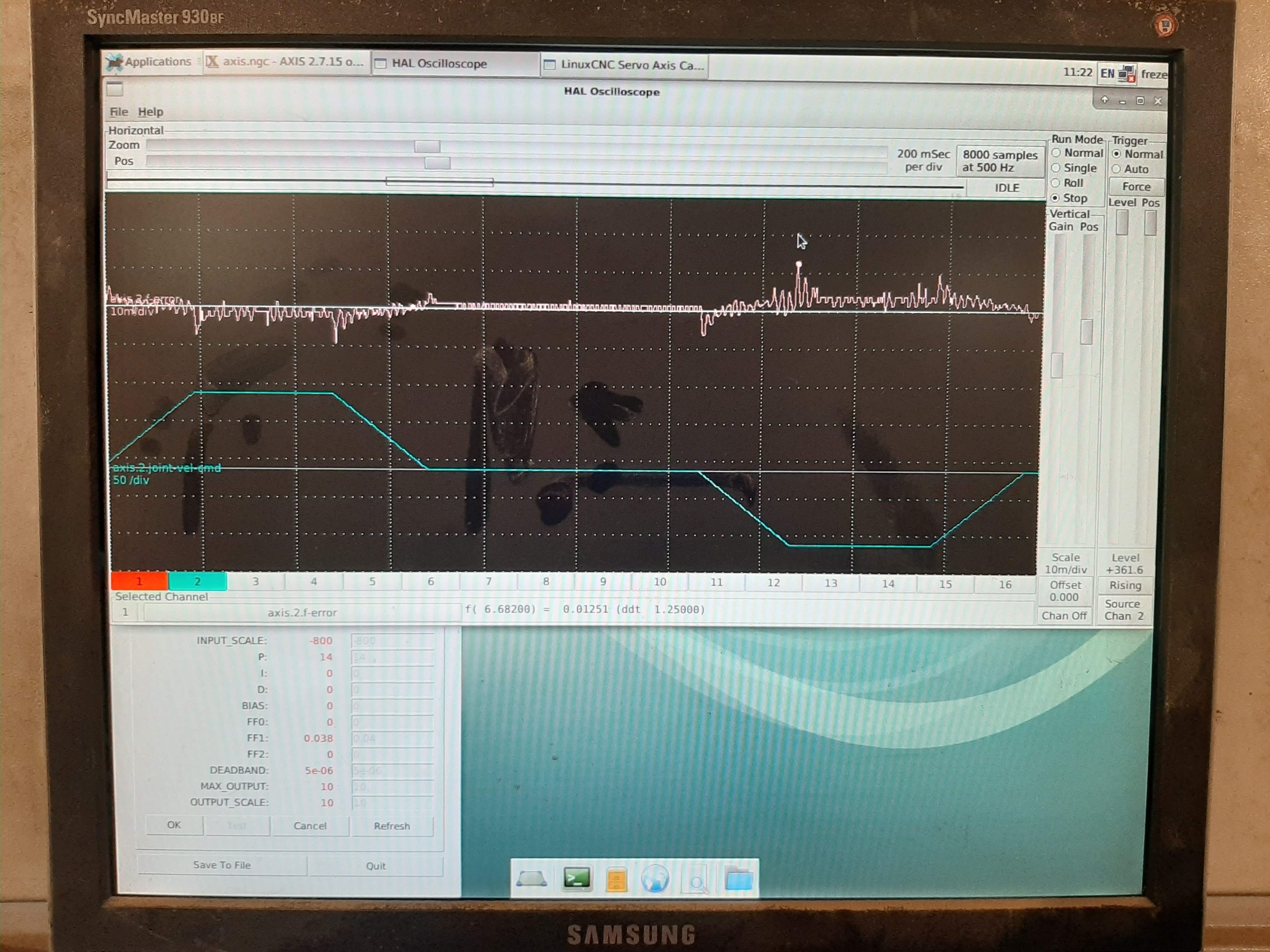

So I have managed to get the axes almost tuned.
I am happy with X axis (see attached picture with HalScope screenshot). Basically I have get max spike of following error 0,02 mm at jog speed 45 m/min. Just like I am happy about Z axis - following error of 0,01 mm at 6,4 m/min. And that is only with P and FF1 parameter, like Tomy suggested.
What I do not understand, is WTF is wrong with Y axis. My main issue are the spikes at the beginning and end of movements. I tried to tune this the same way I did all the rest - set the P parameter and then worked on FF1 gradually increasing the jog speed. Up to 36 m/min.

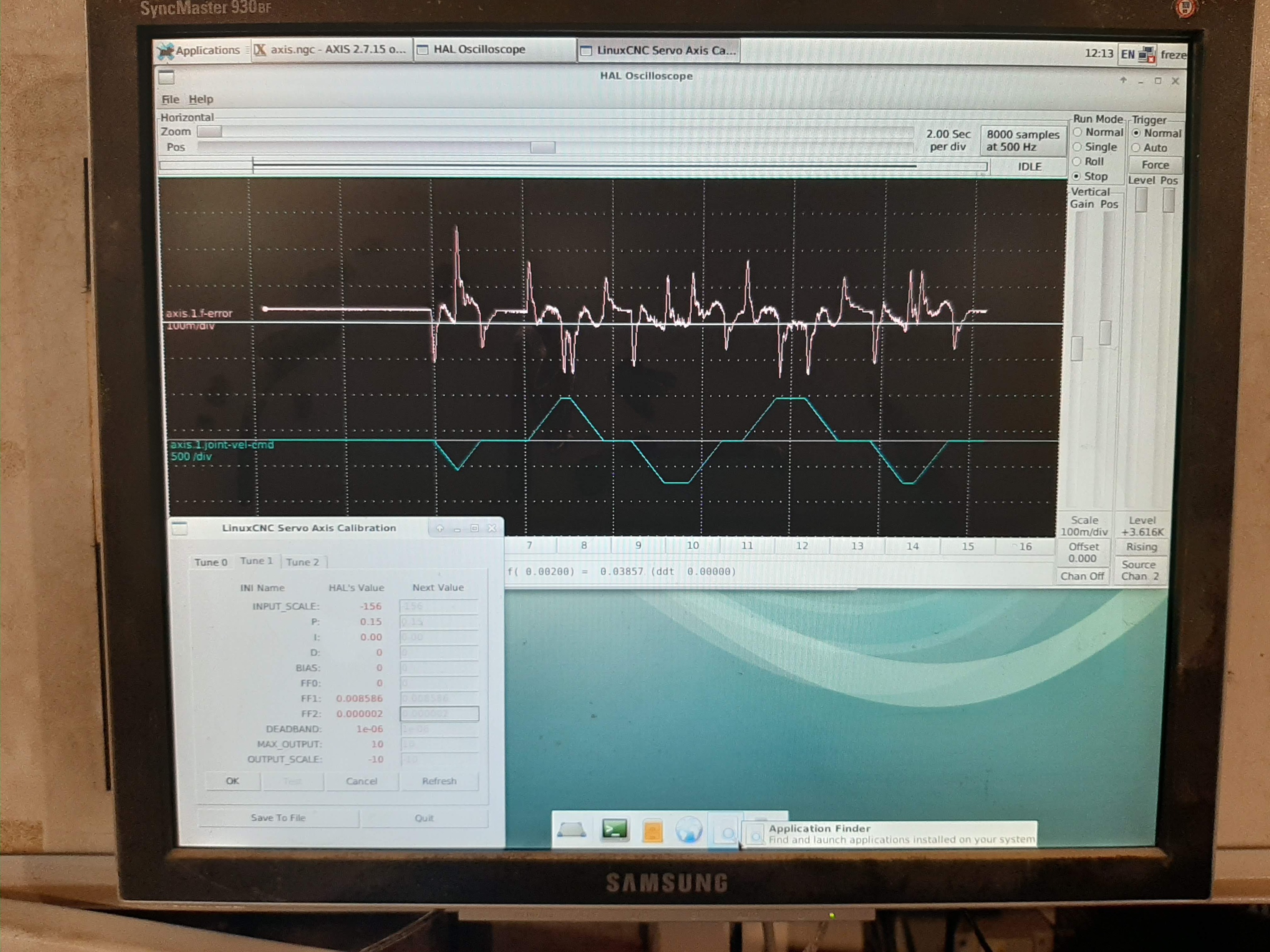

I made it to the point in which it seems to me that FF1 is good enough that movement does not lag behind nor rushes forward command - see screenshot of y_axis_36m-min. All that is left are those spikes. I have tried to remove them with FF2, but this is the best I can do - if I increase this parameter, the graph changes so that there is an increase of 0,2 mm for whole accel or decel phase.
And one more thing that puzzles me is that I dropped the velocity to 9 m/min and now the graph looks like FF1 is too much, because it runs ahead of commanded position.
I tried addding I term. Only thing it does is makes the whole graph go up or down, it does not help with the spikes. I tried also D term. It started vibrating at 0.006, so I tested it with 0.004, but the spikes are exactly the same.
I would appreciate any ideas, what is wrong with my approach.

Can you describe the mechanics of the Y-axis? Is the feedback encoder mounted directly to the Y motor or is it mounted to a ball-screw or is it a linear feedback device?
Tuning FF2 can be very touchy. Your plot shows you were using an FF2=0.000002. What happens with FF2=0.000003 or 0.0000025

That is my suspicion. The plots of your other axis also look like FF2 could use some more attention. (And maybe a little less P for the X.)
A plot of the PID output might also be a little telling, to try to see if the f-error spikes are due to delay in response of the servo or simply a lack of FF2.
