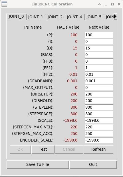

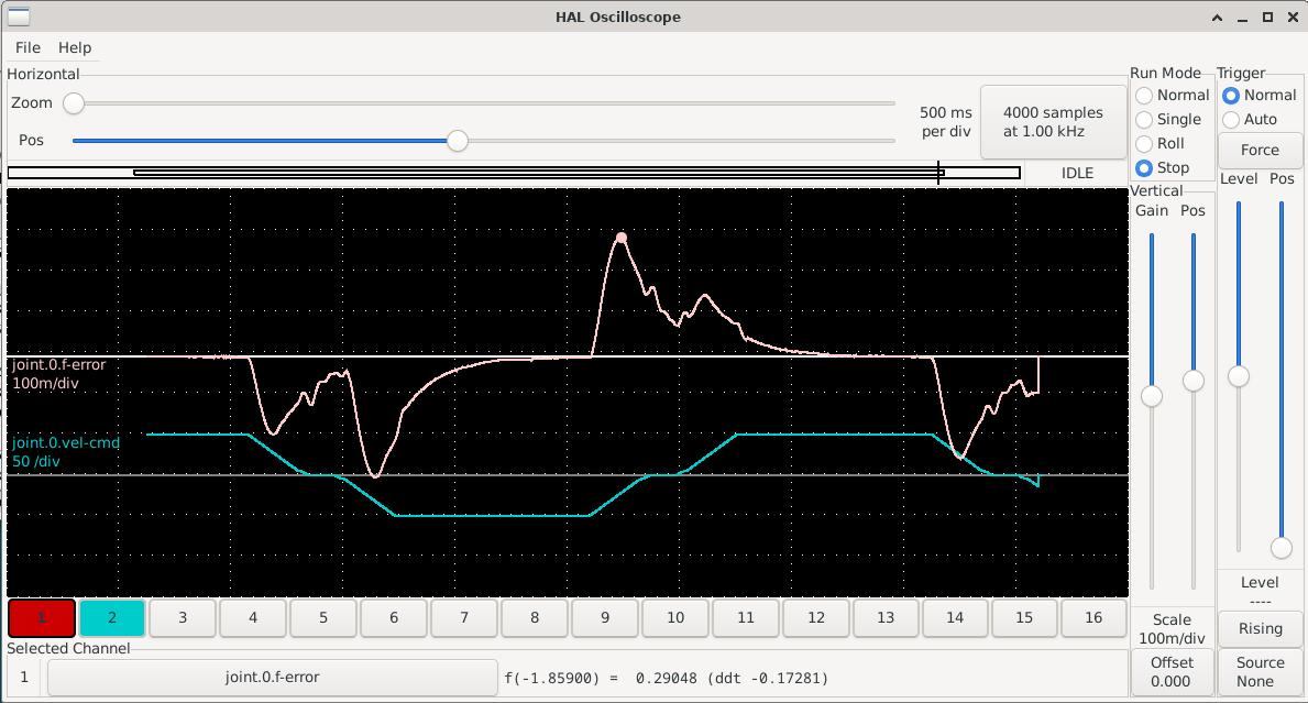

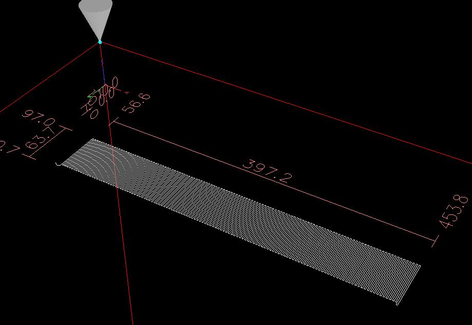

25 Mar 2025 19:37 #324907
by tommy
Replied by tommy on topic Servo Wiring and Tuning detailed How To example Mesa 7i77.
I would need a bit of hint on my tuning of AC servos + 7i95t, as I cannot decrease those spikes on acceleration and deceleration, doesn't matter if I go higher or lower with FF2. On linear move there is f-error 0.001mm or less. Should I start adjusting parameters on diver?
Also if I "go crazy" with short presses on arrow keys for jog, especially with changing direction, f-error is all the way up to 1mm or more.
Captures below are taken during running some test g-code:

25 Mar 2025 19:58 - 25 Mar 2025 20:01 #324908
Replied by PCW on topic Servo Wiring and Tuning detailed How To example Mesa 7i77.
Are these step/dir servos with encoder feedback to LinuxCNC?
If so it seems there is significant delay from command to motion.
This may well be a drive tuning/setup issue. Maybe drive acceleration
set lower than LinuxCNCs setting or some other filtering or constraints
in the drive.
in the drive.
Last edit: 25 Mar 2025 20:01 by PCW.

25 Mar 2025 20:08 #324910
Replied by tommylight on topic Servo Wiring and Tuning detailed How To example Mesa 7i77.
If those are step/dir drives, you should be looking here:
forum.linuxcnc.org/10-advanced-configura...glass-scale-feedback
Also
dirsetup and dirhold to 20000
and stepspace and steplen to 5000
Untill you get things working properly, then you can lower the steplen and stepspace while testing to make sure there are no missed steps.
As you have them, chances are some steps are being missed by the drive so LinuxCNC keep upping the number of steps till it catches up.
Yes, i am aware the drive manual might say 200ns, but that is almost always not correct, except on very good quality drives.
Also

25 Mar 2025 20:19 #324913
by tommy
Yes, it is step/dir driver.
If it helps, here are .ini and .hal sections, related to this axis:
[AXIS_X]
MIN_LIMIT = -1
MAX_LIMIT = 1100
MAX_VELOCITY = 170
MAX_ACCELERATION = 200
[JOINT_0]
CARD = 0
TAB = 0
AXIS = X
TYPE = LINEAR
HOME = 0.000
MAX_VELOCITY = 170
#PID_MAX_VEL = 10
BACKLASH = 0.000
STEP_INVERT = False
DIR_INVERT = False
STEPGEN_MAX_VEL = 220
STEPGEN_MAX_ACC = 250
DIRSETUP = 200
DIRHOLD = 200
STEPLEN = 800
STEPSPACE = 800
SCALE = -1998.6
ENCODER_SCALE = -1998.6
MIN_LIMIT = -1.0
MAX_LIMIT = 1100
FERROR = 10
MIN_FERROR = 7
HOME_OFFSET = -4.0
HOME_SEARCH_VEL = -10
HOME_LATCH_VEL = 2
HOME_USE_INDEX = NO
HOME_IGNORE_LIMITS = YES
HOME_SEQUENCE = 1
DEADBAND = 0.001
P = 100
I = 0
D = 15
BIAS = 0
FF0 = 0
FF1 = 1
FF2 = 0.01
MAX_OUTPUT = 0# PID Setup
setp pid.x.Pgain [JOINT_0](P)
setp pid.x.Igain [JOINT_0](I)
setp pid.x.Dgain [JOINT_0](D)
setp pid.x.bias [JOINT_0](BIAS)
setp pid.x.FF0 [JOINT_0](FF0)
setp pid.x.FF1 [JOINT_0](FF1)
setp pid.x.FF2 [JOINT_0](FF2)
setp pid.x.deadband [JOINT_0](DEADBAND)
setp pid.x.maxoutput [JOINT_0](MAX_OUTPUT)
#setp pid.x.error-previous-target True
# limit stepgen velocity corrections caused by position feedback jitter
#setp pid.x.maxerror [JOINT_0](MAX_ERROR)
# joint-0 enable chain
net x-index-enable <=> pid.x.index-enable
net x-enable => pid.x.enable
net x-output => pid.x.output
net x-pos-cmd => pid.x.command
net x-vel-fb => pid.x.feedback-deriv
net x-pos-fb => pid.x.feedback
# Joint 0 Step Gen signals/setup
setp hm2_[MESA](BOARD).0.stepgen.00.dirsetup [JOINT_0](DIRSETUP)
setp hm2_[MESA](BOARD).0.stepgen.00.dirhold [JOINT_0](DIRHOLD)
setp hm2_[MESA](BOARD).0.stepgen.00.steplen [JOINT_0](STEPLEN)
setp hm2_[MESA](BOARD).0.stepgen.00.stepspace [JOINT_0](STEPSPACE)
setp hm2_[MESA](BOARD).0.stepgen.00.position-scale [JOINT_0](SCALE)
setp hm2_[MESA](BOARD).0.stepgen.00.maxvel [JOINT_0](STEPGEN_MAX_VEL)
setp hm2_[MESA](BOARD).0.stepgen.00.maxaccel [JOINT_0](STEPGEN_MAX_ACC)
setp hm2_[MESA](BOARD).0.stepgen.00.step_type 0
setp hm2_[MESA](BOARD).0.stepgen.00.control-type 1
# ---closedloop stepper signals---
net x-pos-cmd joint.0.motor-pos-cmd
net x-output => hm2_[MESA](BOARD).0.stepgen.00.velocity-cmd
net x-enable joint.0.amp-enable-out => hm2_[MESA](BOARD).0.stepgen.00.enable
# ---Encoder feedback signals/setup---
setp hm2_[MESA](BOARD).0.encoder.00.counter-mode 0
setp hm2_[MESA](BOARD).0.encoder.00.filter 1
setp hm2_[MESA](BOARD).0.encoder.00.index-invert 0
setp hm2_[MESA](BOARD).0.encoder.00.index-mask 0
setp hm2_[MESA](BOARD).0.encoder.00.index-mask-invert 0
setp hm2_[MESA](BOARD).0.encoder.00.scale [JOINT_0]ENCODER_SCALE
net x-pos-fb <= hm2_[MESA](BOARD).0.encoder.00.position
net x-vel-fb <= hm2_[MESA](BOARD).0.encoder.00.velocity
net x-pos-fb => joint.0.motor-pos-fb
net x-index-enable joint.0.index-enable <=> hm2_[MESA](BOARD).0.encoder.00.index-enable
net joint-0-pos-rawcounts <= hm2_[MESA](BOARD).0.encoder.00.rawcountsPlease Log in or Create an account to join the conversation.

DEADBAND = 0.1
MAX_OUTPUT = 10
ENCODER_SCALE = -40
OUTPUT_SCALE = 10
OUTPUT_MIN_LIMIT = -10
OUTPUT_MAX_LIMIT = 10
MIN_LIMIT = -1000
MAX_LIMIT = 1000
HOME_OFFSET = 0.0
HOME_SEQUENCE = 1

Why?P = 0.0000001
I = 0.
D = 0.
- besriworld
- Posts: 327
- Thank you received: 92
09 Feb 2026 04:33 - 09 Feb 2026 11:30 #342693
by besriworld
Replied by besriworld on topic Servo Wiring and Tuning detailed How To example Mesa 7i77.
If you have time, please watch the video.
Even with a very small P value, the axis starts to oscillate.
PS. I understand that Linuxcnc is fighting with the internal PID controller of the servo driver.
Last edit: 09 Feb 2026 11:30 by besriworld.
- Posts: 21945
- Thank you received: 7471
09 Feb 2026 14:14 #342711
Remove the dots after the 0 for I and D.
From video, definitely something wrong, but no idea what, that is not normal oscillation as it is moving way to much back and forth.
Do some plots using halscope for command and f-error
