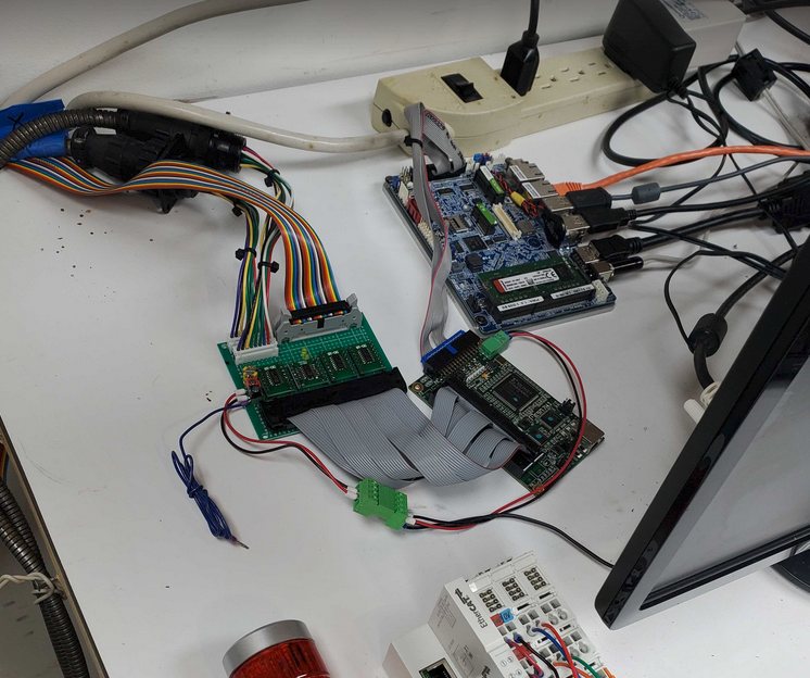

Greetings,
I'm working on a new conversion project, modernizing an old Bridgeport Series 1 2HP that has a working Prototrak Plus system on it. For "phase 1" of the project I am keeping the original Trak servo motors/drives/encoders and the Trak "wheel" style encoders for table position. The machine has ballscrews, though they are a bit worn and have some backlash. I know this isn't ideal and may present some problems, but I hope to tackle that later. My goal is to get it up and running for close to zero cost initially, then figure out what I want to improve later.
My past conversions have all been open-loop stepper systems, and while I'm quite comfortable with LinuxCNC down to the programming level, closed loop config and tuning with LinuxCNC is new to me. I've been focused on getting one axis working first. I was able to at least get a basic tune on a single loop using just the motor encoder. But I'd like to take the next step and use the axis position encoders in a dual loop setup to improve positional accuracy.
I'm using a Mesa 7i43 parallel port FPGA card that I had left over from my first CNC conversion 12+ years ago. I designed and hand-wired a board to handle the differential signal conversion to/from the servo drives and encoders. I've got that all working just fine on the bench - all of the encoders and servo outputs work through Hostmot2 and HAL as expected.
I did a bunch of searching on the forum but there seems to be fairly sparse info on this topic. I followed the guide that's on the wiki , but it's also a bit light on details. I've got a rough config put together based on the steps in that guide, but I know it still has some problems and I could use a more experienced set of eyes. My controls engineering class was almost 30 years ago at this point (!), and while I do have some basic experience and understanding of PID control, I'm getting a little ahead of my skis on this dual loop implementation.
Happy to share full configs, but I figured I'd start with just the X axis snippets. My guess is my config problems are in the feedback part near the bottom of the HAL config, that's where the wiki guide seemed most vague.
Thanks!

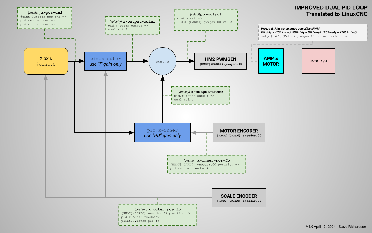

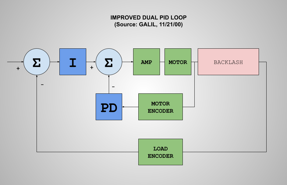

It's been a busy week here, but I'm still working to wrap my head around this. I posted a link earlier to a Galil video about dual loop compensation, and finally had a chance to watch it in detail. It gives a good overview of the approaches and problems. The proposed "improved dual loop" seems to be more or less the same approach that was described rather sparsely in the wiki.
Here's the video again: www.galil.com/learn/online-videos/dual-l...compensation-methods
And my re-drawing of their simplified dual loop.
To better my understanding I've been working through the process of translating that simplified loop to show the actual relevant HAL components and signals. Here's my first approach. It's much easier to understand and learn in diagram form than just seeing it as a pile of HAL commands.
I have not yet taken this back down to my shop to rework the config to match the drawing, but hopefully this weekend. Anyone see any glaring mistakes or have other comments?

One thing I'm questioning is whether both the inner and outer PIDs should receive the same position command signal. It isn't really shown explicitly in the simplified Galil drawing, though the wiki example definitely does it this way.
Also, I want to make sure I understand the nomenclature. I think I wrongfully assumed this type of dual loop was a velocity loop (inner) and position loop (outer), but the outputs from both loops are velocities, so I think that's wrong. You can see my confusion in the initial configs I posted as I called the PIDs "vx" and "px".
Next up, the Prototrak DC servo amps are PWM input -> motor output voltage. Varying the voltage on an unloaded DC motor varies its speed (velocity). These are just amps and not closed loop drives - the motor encoder output just comes straight into the Mesa card. I am a bit confused on whether this is called "velocity mode," however. Is that term reserved for a drive which itself runs a loop with the motor encoder to maintain the commanded velocity?
Which leads me to wondering whether the velocity outputs from the motor encoders should be used. Andy, you kind of hinted at that the other day. I'm curious how you would see that fitting into this diagram.
Thanks in advance.

Replied by rodw on topic Dual PID loops with motor encoder + scale encoder per axis
I thought the intention was to close the velocity loop on the drive/amp and to close the position loop from the scales in linuxcnc.
But I've not got any experience to add.

These 35 year old drives/amps don't have any way to close the loop internally. They're just offset PWM in -> +/- DC voltage out as far as I know. There's no microcontroller in them, and the motor encoders don't connect to them. The signals were passed directly to the primitive Prototrak Plus controller/DRO box.
