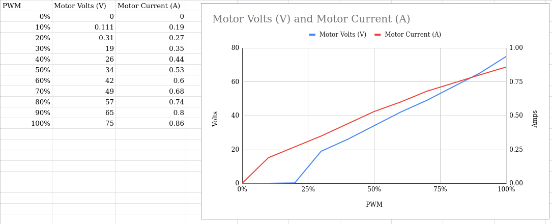

A little bench experiment running the motor open loop with no load across 0%-100% PWM values.
Except for the discontinuity at the bottom, voltage looks more linear to me, though they both look reasonably linear.    Maybe loading the motor would make it more clear, but I have to find a good way to do that on the bench.

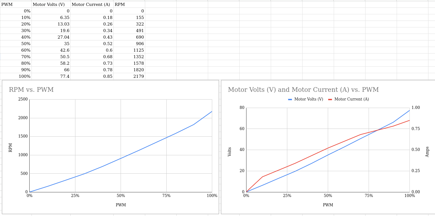

Another test with cleaner results.  One of my DMMs had a low battery so it was having some trouble auto-ranging I think, so the last results were a bit screwy.  I also measured RPM with my optical tach this time.
Another observation: when I run the motor at a fixed PWM value and apply a physical load to the motor, current will jump up substantially but the voltage will drop a much smaller amount percentage-wise.  So it behaves more like a CV power supply and not a CC power supply.  The voltage drop could be explained by the 10ft long 16 gauge wire that feeds the motor.
