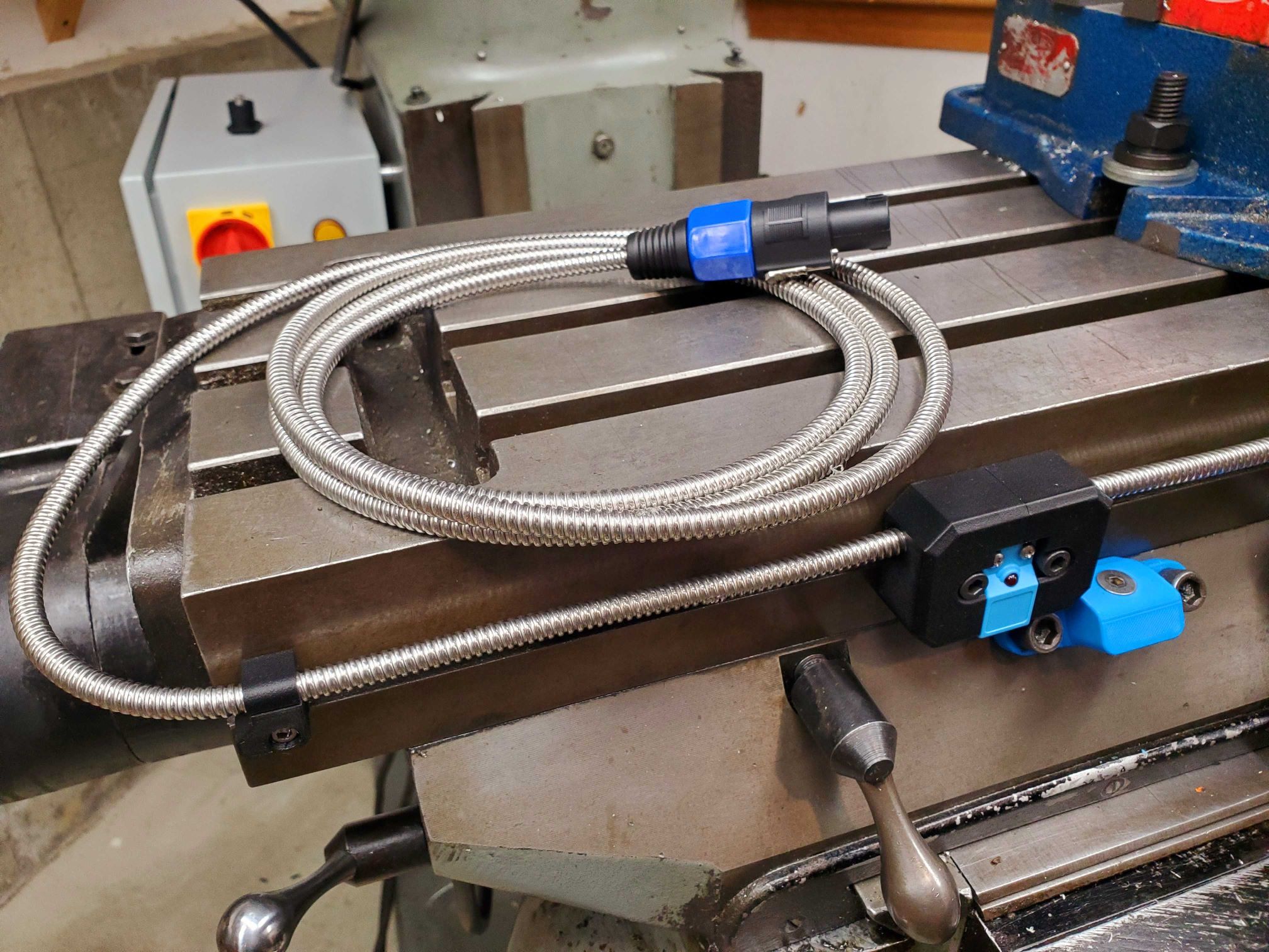

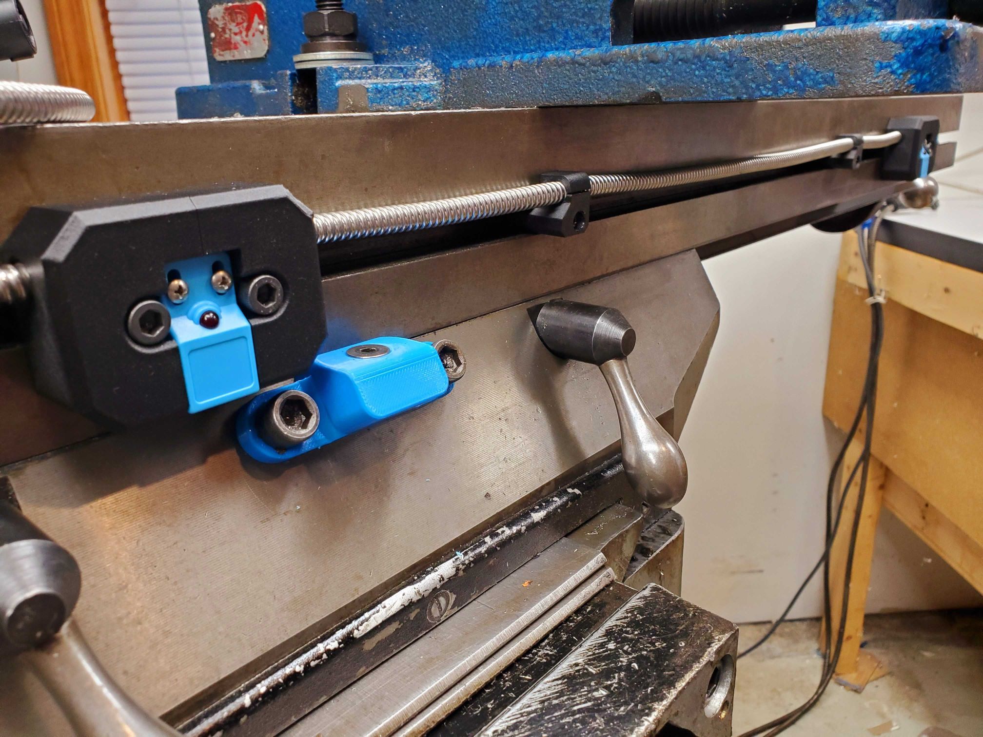

Unfortunately I haven't had a lot of time to get back to the servo drive configuration conundrum on my conversion project, but I did make a prototype of some X axis limit/home prox switches. Just 3D prints for now - I may end up changing my mind about having them in the front T-slot. But it should make tuning on the machine a bit less nerve-wracking in the meantime.
I've also stumbled into a 750W DMM Tech AC servo and driver. Unfortunately just one, not a pair of them. That just might put a bug in my ear about replacing the original huge brushed DC motors, though...
