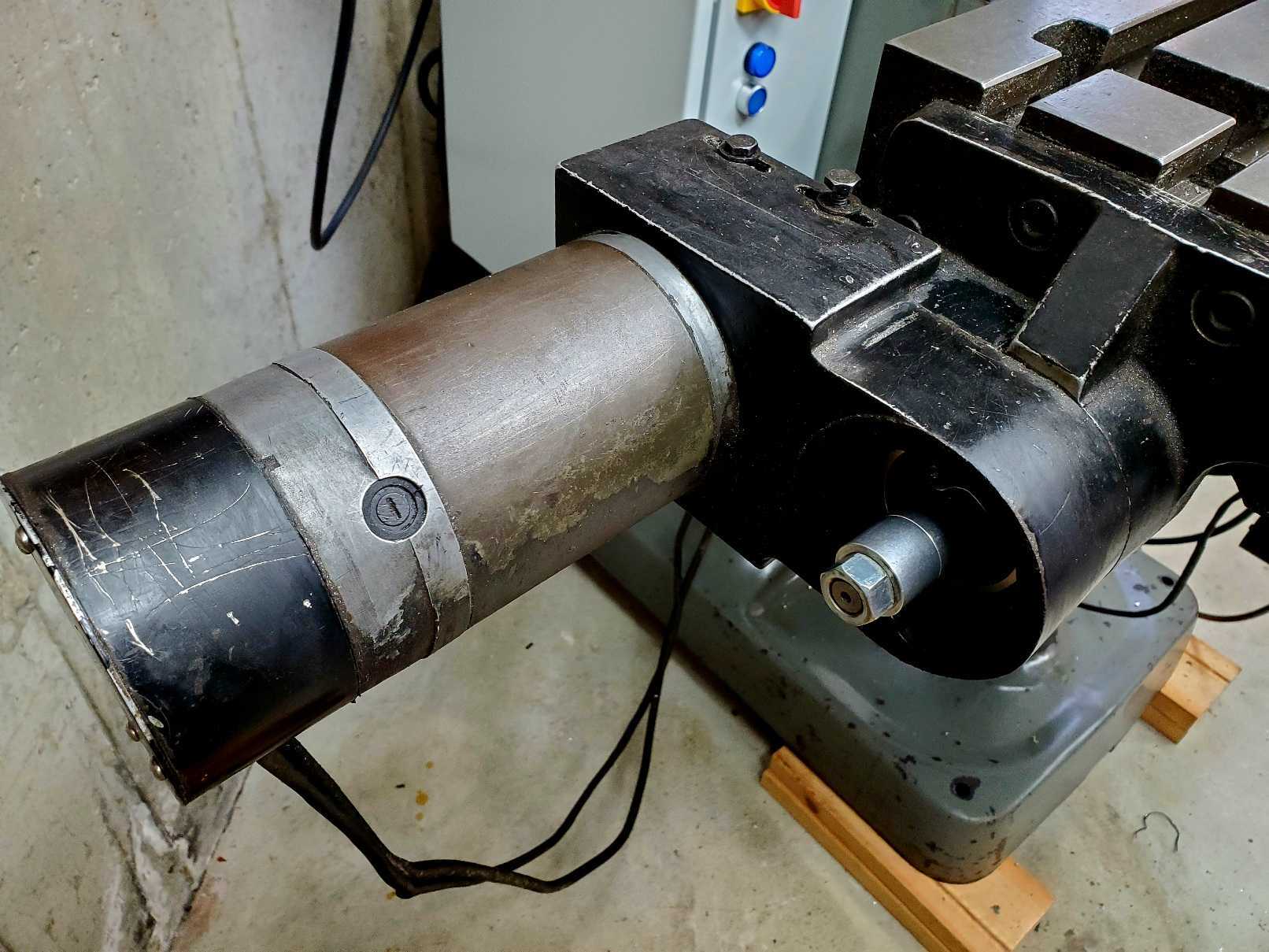

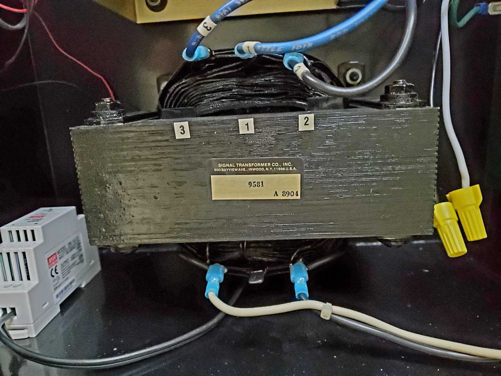

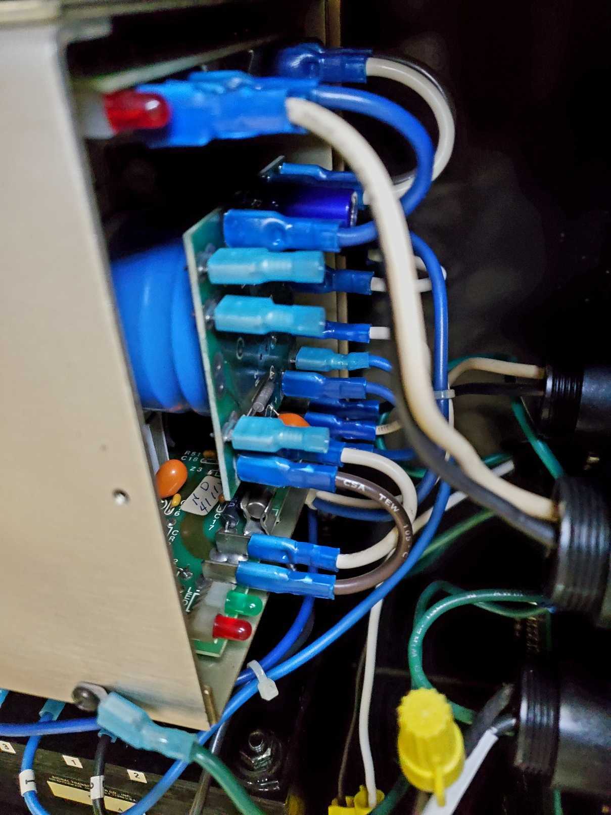

13 Apr 2024 17:49 #298184 by TangentAudio
These are the parts of the old ProtoTrak Plus system from 1989 that I am still using for the moment, because they came with the machine and still work.
I have not pulled the amp boards from the cage to get photos, but they are pretty primitive.  Not much more than a DC power supply really.
The servo motors are big, brushed DC with a 16T:44T belt drive to couple to 5mm pitch ball screws.  The 2000CPR encoder hangs off the back.

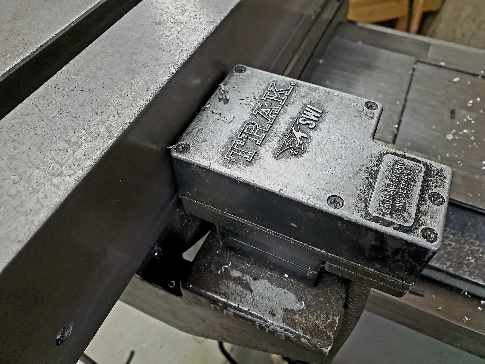

And these are the "infamous" Trak gage wheel table position encoders (on X, Y and the non-motorized quill).  They work, kinda, until they get chips in them or they get misaligned.
