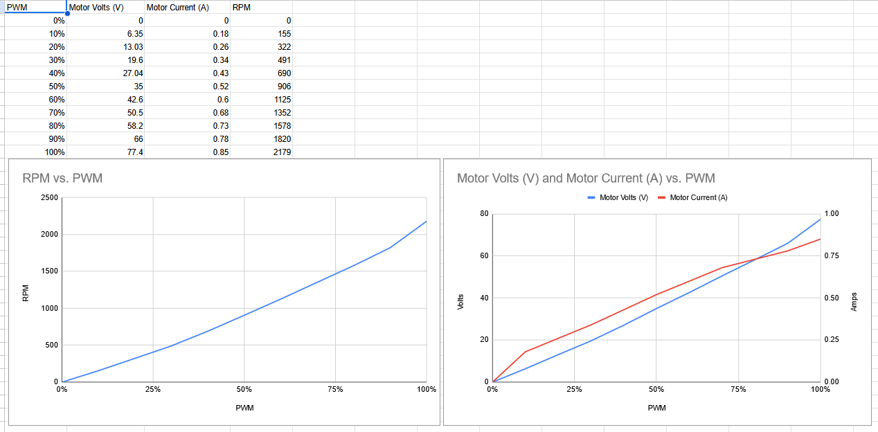

To be clear this is actually not what I observed. If I command 50% output, it seems to output a fixed voltage roughly 1/2 of the max voltage of the drive supply. If I increase physical load on the motor, current to the motor will increase dramatically as it tries to maintain speed. Voltage at the motor does drop slightly (just a few volts, but keep in mind it's at the end of 10 feet of cable). Current will increase by a large factor depending on the load. For example at 50% the motor draws 0.5A when unloaded. That will jump up to several amps as I apply a load.
I measured RPM, voltage and current at the motor for the full range of the PWM. That was all measured with an unloaded motor. I've reattached the graphs since that post was a couple pages back.
I did not have a way to apply a consistent load to the motor (grabbing the pulley with a rag) so I couldn't really produce the same graphs with varying constant loads. But my observation was that it behaved more like a bench supply in CV mode rather than in CC mode. I think that's a fair analogy to what the drive is doing?
I really do appreciate the discussion.

Is this an open-loop command or under PID. IOW, you're saying that as the load increases, your motor command remains the same?

That graph was done in open loop. I disconnected all of the PID signals and was just controlling the PWM output value directly. And yes, the observation about current increasing with load - that's with the same PWM value and also open loop.

That's what I meant with:
"the inherent velocity feedback from the BEMF makes it so"
You do have velocity feedback (and damping) in a open loop PWM system
The gain in the loop is inversely proportional to the motor resistance.
If you slow the motor so its BEMF is less the the applied voltage, the current increases.
If you speed the motor so its BEMF is greater than the applied voltage, the current reverses
to oppose the motors motion.

And between the drive and the motor, you only have power cables, no tachometer feedback, right? Only two wires (thermal sensor notwithstanding)?
This is sounding quite bizarre. Negative feedback needs to be calibrated which is either a tach signal (potentiometer) or a D-term.

Correct, just the +/- wires between the drive and the motor. There's no analog tach on the motors, just a quadrature encoder that has no connection to the drive electronics.
