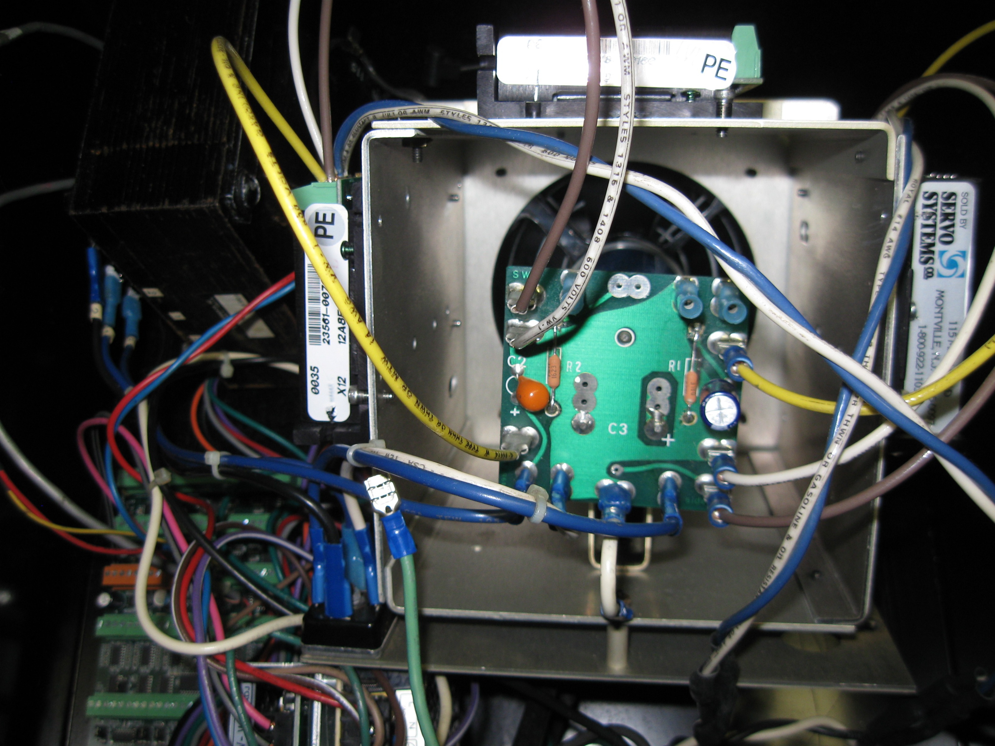

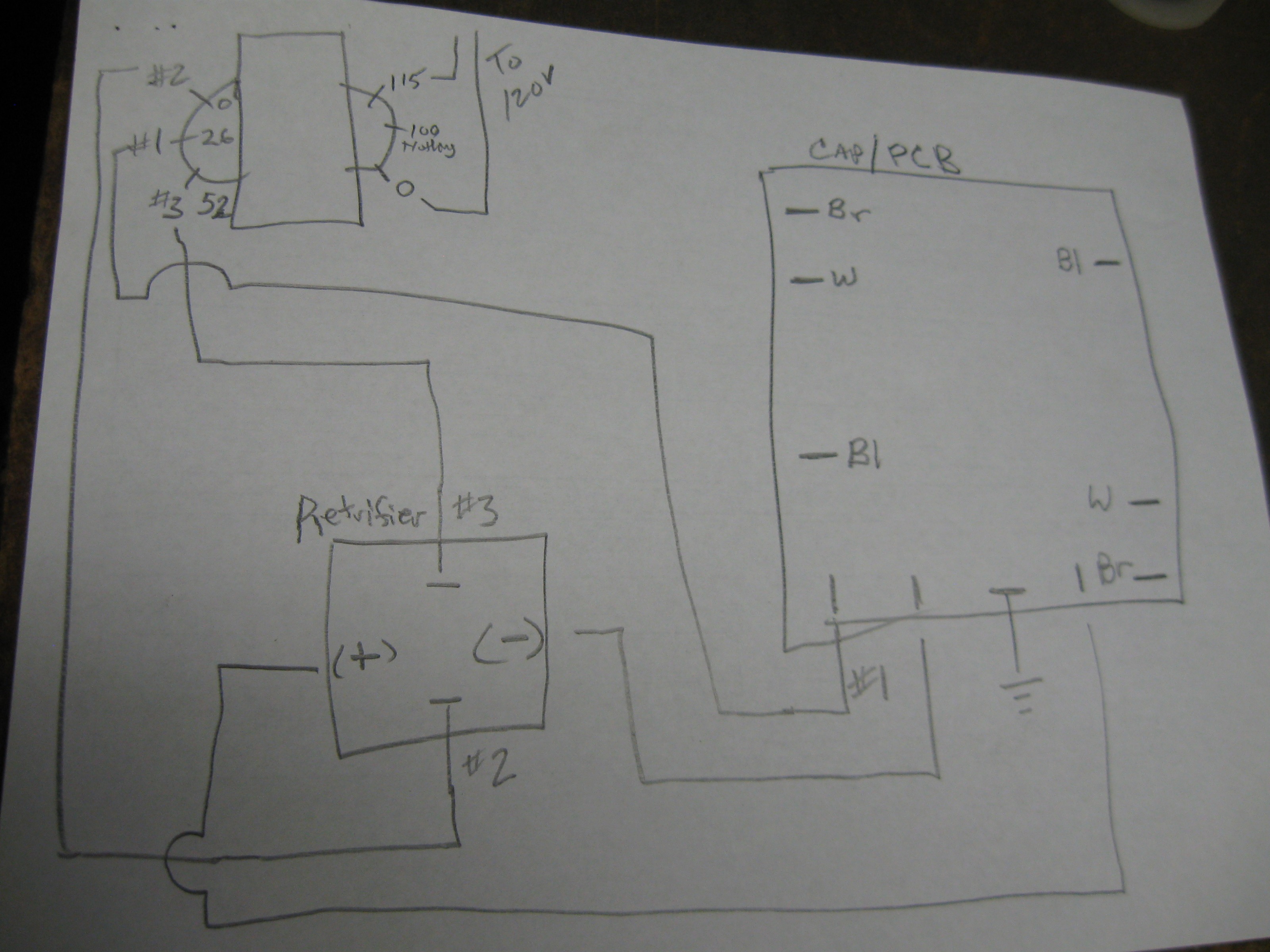

10 Mar 2017 18:01 - 10 Mar 2017 18:02 #89354
by new2linux
Replied by new2linux on topic Prototrak Plus Retrofit with Mesa 7i77 & 5i25 cards
Many thanks Andy and Dan! Here are a few pics, use for reference, because it needs to be correct.
this is a diagram of the leads, if you see the rectifier is marked + on the left & - on right. Also the PSB is enlarged in the diagram, with the Brown=Br; White=W; Blue= Bl. I have taken just best guess for the locations in the pic. The other pic is of the amp with the fan assembly rotated for better view.
Many thanks!
Many thanks!
Last edit: 10 Mar 2017 18:02 by new2linux. Reason: clearify
- Posts: 19896
- Thank you received: 4648
10 Mar 2017 18:24 #89356
Replied by andypugh on topic Prototrak Plus Retrofit with Mesa 7i77 & 5i25 cards
It seems fairly clear that white is negative.
But as for which of blue or brown is positive, I can't really tell.
What does the multimeter say? Which connects to the + terminal of the capacitor?
- new2linux
- Posts: 711
- Thank you received: 9
10 Mar 2017 18:25 #89357
by new2linux
Thank you Andy & Dan! To insure this is tested correctly I place 110v light between 1 & 3 measure voltage; 1 & 2 measure voltage; 2 & 3 measure voltage, changing the light as I go to the next set of leads. Will this also answer Andy's question about 80v. I can pull other capacitor out to see back side of PCB if it is better that way.

- new2linux
- Posts: 711
10 Mar 2017 19:10 #89362
by new2linux
Many many thanks!!
The results form having 110v light in circuit and testing with voltmeter. 1 & 2 on 12v scale needle moved both ways(+ & -) on scale, moved very small amount.
1 & on 12v scale needle moved both ways(+ & -) on scale, moved very small amount.
3 & 2 on 12v scale needle moved both ways(+ & -) on scale, moved the largest amount. The light was on, but dim.
thanks for all your help!!
- Posts: 19896
10 Mar 2017 19:30 #89365
Why are you using a 12V scale? Aren't these 80V servo drivers?
Something isn't making sense here.

- new2linux
- Posts: 711
10 Mar 2017 19:35 - 10 Mar 2017 19:37 #89367
by new2linux
Thank you Andy!
The needle moved such a small amount on the 60v that it was hard to decide how much it moved. Even on 12v scale it was very small amount. This measurement is at the transformer not the PCB or capacitor.
thanks!
thanks!
Last edit: 10 Mar 2017 19:37 by new2linux. Reason: spelling
- Posts: 19896
10 Mar 2017 19:54 #89371
Why?
Also, you would need to use the AC setting at that point. (And DC on the other side of the rectifier)
Why?
