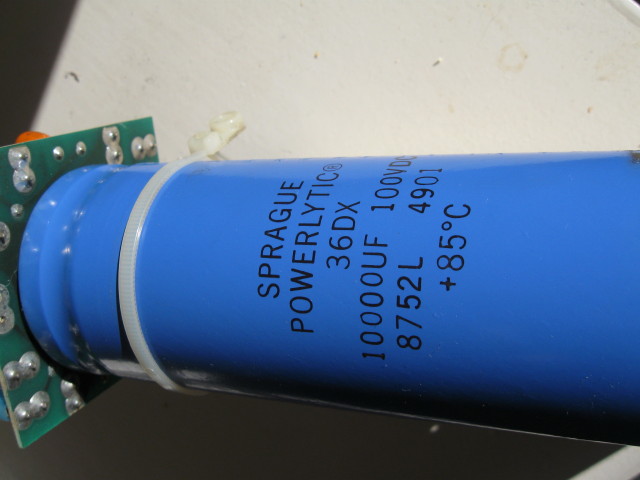

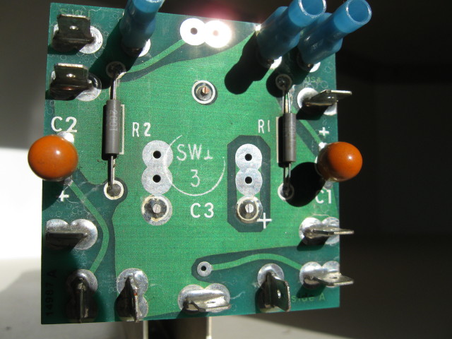

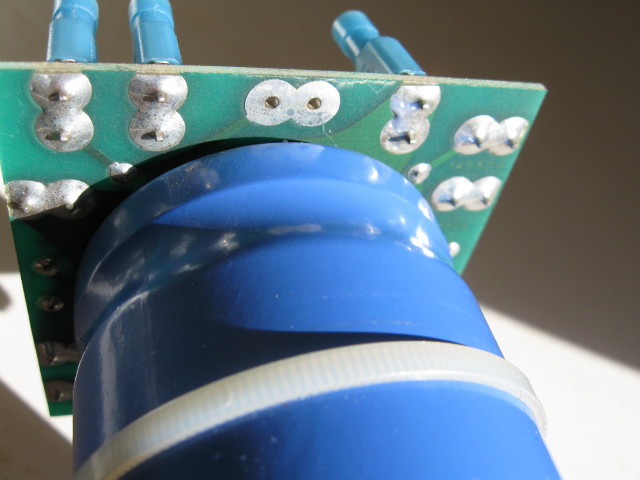

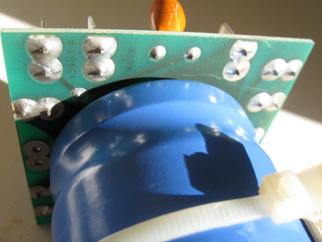

11 Mar 2017 13:36 - 12 Mar 2017 14:54 #89414
by new2linux
Replied by new2linux on topic Prototrak Plus Retrofit with Mesa 7i77 & 5i25 cards
Many thanks for all the help!
Attached are a few pic of the cap/PCB, labeled top (viewed from back), labeled side (viewed from back), as you will see the blue "crimp on" and the orange small capacitor are in the pic for ref. The front I tried to get the light to help with the circuit id.
If I can assist with a voltmeter to test continuity please advise. Take note this assembly is not the one in use, there are 2 of these.
many thanks! helpful comments are warmly welcomed!

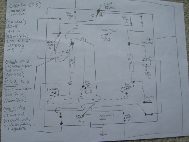

Edit: The diagram is my best effort (please comment if necessary) to get this documented for others. The top "left open" there is no component there, as seen in pic to the left (I hope). Note 3 the pin of the capacitor (c3) does not seem to go anywhere. The list of components are to the left, this is what was marked on the components, open to suggestions. The dotted lines I am not completely shore, tested good continuity, but could not verify visually, if that is where they go 100%. The notes may not read so well: Note 1 PCB has large copper foot print (on far-side) goes to the + side of rectifier; Note 2 PCB has large copper foot print (on near-side) goes to the - side of rectifier. Lower left terminal on PCB goes to #1 on transformer.
edit: The terminals in question (looking at front.jpg) are on right side just under the light blue "crimp on", there is a terminal that is in the horizontal position (unlike the light blue "crimp on" that is vertical), then a capacitor, then 2 terminals that are in the horizontal position. It is these that are as per a prior post labeled by color, but if we now look at it as 1 at the top,2 mid and 3 bottom the following values were results of test.
40v=2 & 3; 40v=1 & 3; 75v=2 & 1
I include this here to keep track.

13 Mar 2017 13:09 #89513
Replied by andypugh on topic Prototrak Plus Retrofit with Mesa 7i77 & 5i25 cards
I remain confused. Your schematic shows nothing connected to C3+

13 Mar 2017 14:04 - 13 Mar 2017 14:09 #89518
by new2linux
andypugh, thanks you!! The if you read note 1 is connected to all the places you see note 1, so that would the top terminal on the right side, the very bottom on the left side, along the top it is the to the left most along the top (I cut the pic off, but the diagram lead goes all the way to the right, then to the bottom, then the pic has it back). This PCB is symmetrical except the very top, (the pic has note "left open"), I don't know if a capacitor like c1 or c2 would make it possible to use that as "z" axes power supply to amplifier.
Many thanks!!

13 Mar 2017 18:30 #89540
by lakeweb
Replied by lakeweb on topic Prototrak Plus Retrofit with Mesa 7i77 & 5i25 cards
Hi new2,
I would recommend you get a friend that has electrical experience look in on you. But for now, the best I can make of your diagram says:
The red circle is your motor power supply positive and the blue the negative. And goes to what is called 'High voltage' from the PDF: servosystems.com/pdf/amc/12a8.pdf that Andy had offered you, is where this gets connected. The other PDF is not retentive for this. And that is all you will use from that power supply.
You will need 5 volts for the 7i77. I've not looked into it, but you may be able to jump that from the 5i25. Or you can buy:
Power Supply or the type that Andy previously offered.
And then if you need to use the field contacts to drive relays from the 7i77, that is potentially yet another power supply. Typically 24 volts.
On my mill there are five different power sources. I get the feeling you think just the one supply will do. Is that the case?
Best, Dan.
Best, Dan.

13 Mar 2017 18:49 #89541
I actually think that left, right and top are where the moor drives connect (with a set of crimps supplied for connecting a third axis)
I believe that the rectified voltage feeds in at the bottom. Either of the two in the blue circle can be negative from the rectifier.
But: I don't know what the extra wire from the transformer to that board bypassing the retifier is for, neither do I know what the extra terminals are for which seem to be coupled via the small capacitors.
It is quite likely that you can ignore those with your new drives.
But, I echo the sentiment that having someone who knows one end of a multimeter from the other give it a check-over would be a good idea.
The red circle is your motor power supply positive and the blue the negative. And goes to what is called 'High voltage' from the PDF: .
