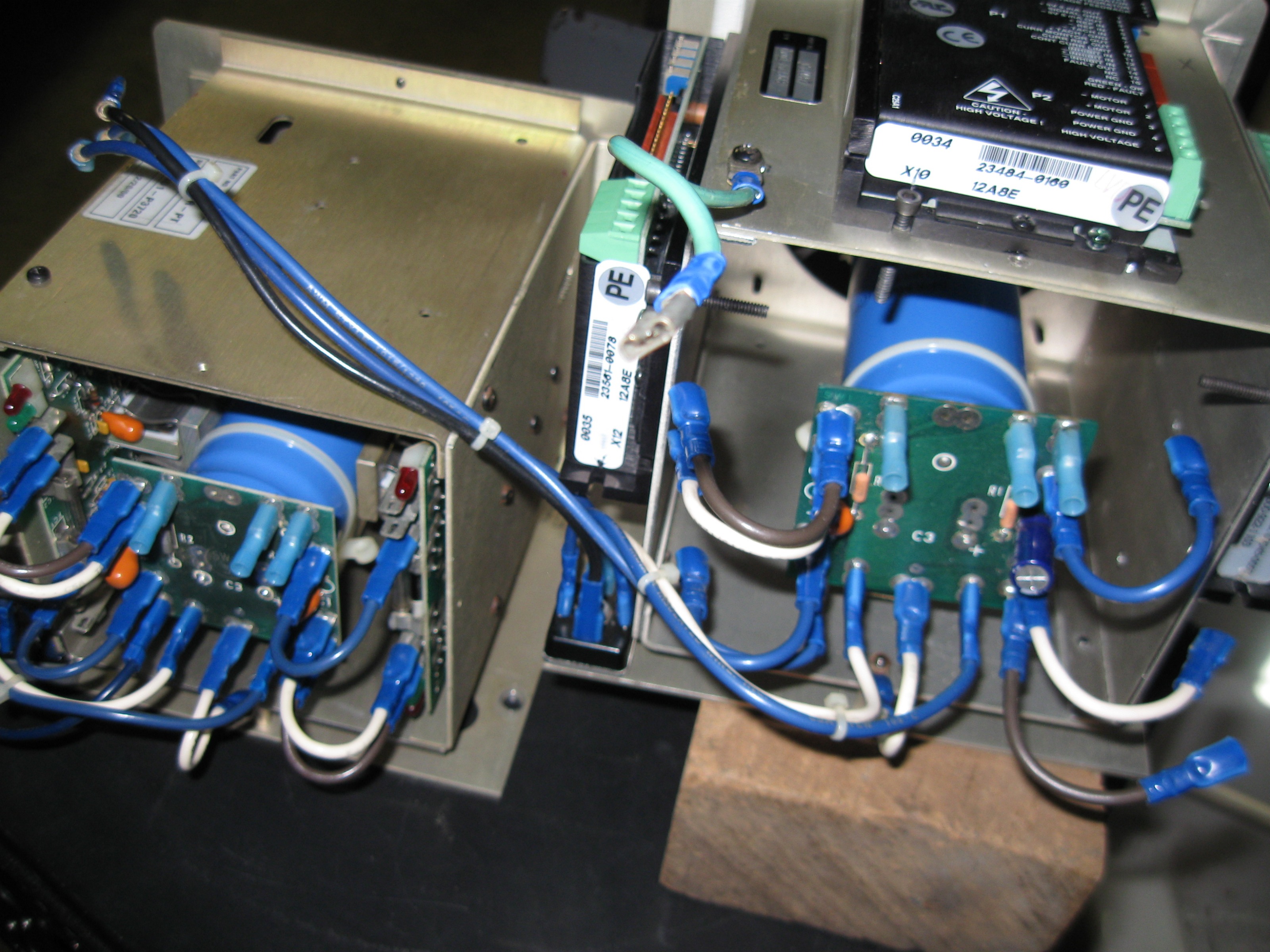

andypugh, many thanks! Below is a description from the manual, I am not shore if I have answered the question. Also the link to manual. If you see the pics the old amps were on the inside of fan box, now on the out side, a "z" axes is on top, but looks like may need away work around to get power from capacitor PCB terminals, just looks 2 axes friendly.

My question is can I get away with using the push together spaded connectors or do I need to start anew and make one piece, for power to servo from amp. These are to be twisted,as you see in the pic, I have shrink wrap.

I see no reason not to make new one-piece cables from the PSU to the drives, it will be a better job and the terminals are cheap. (But then I already have a good selection of crimping tools)

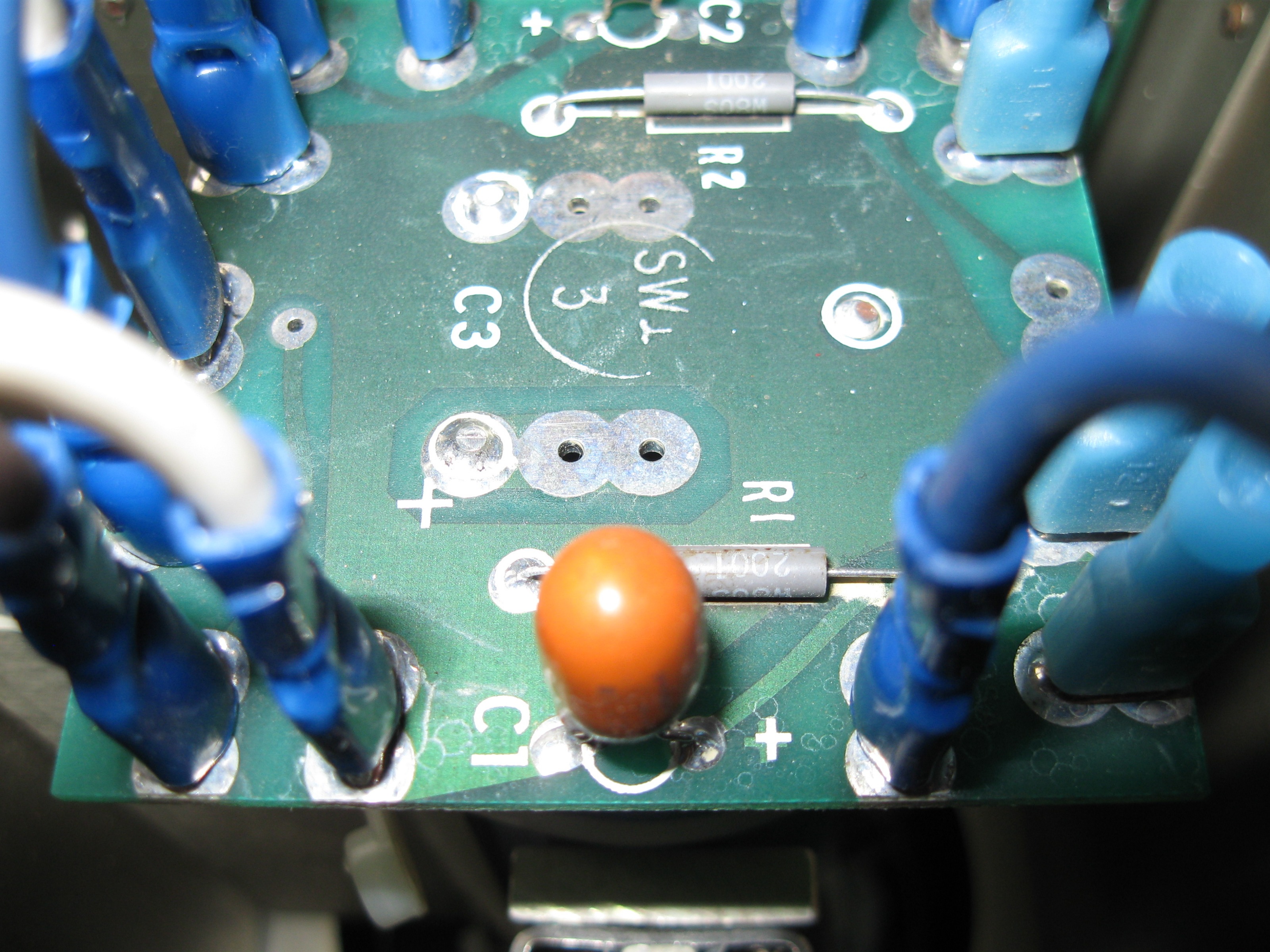

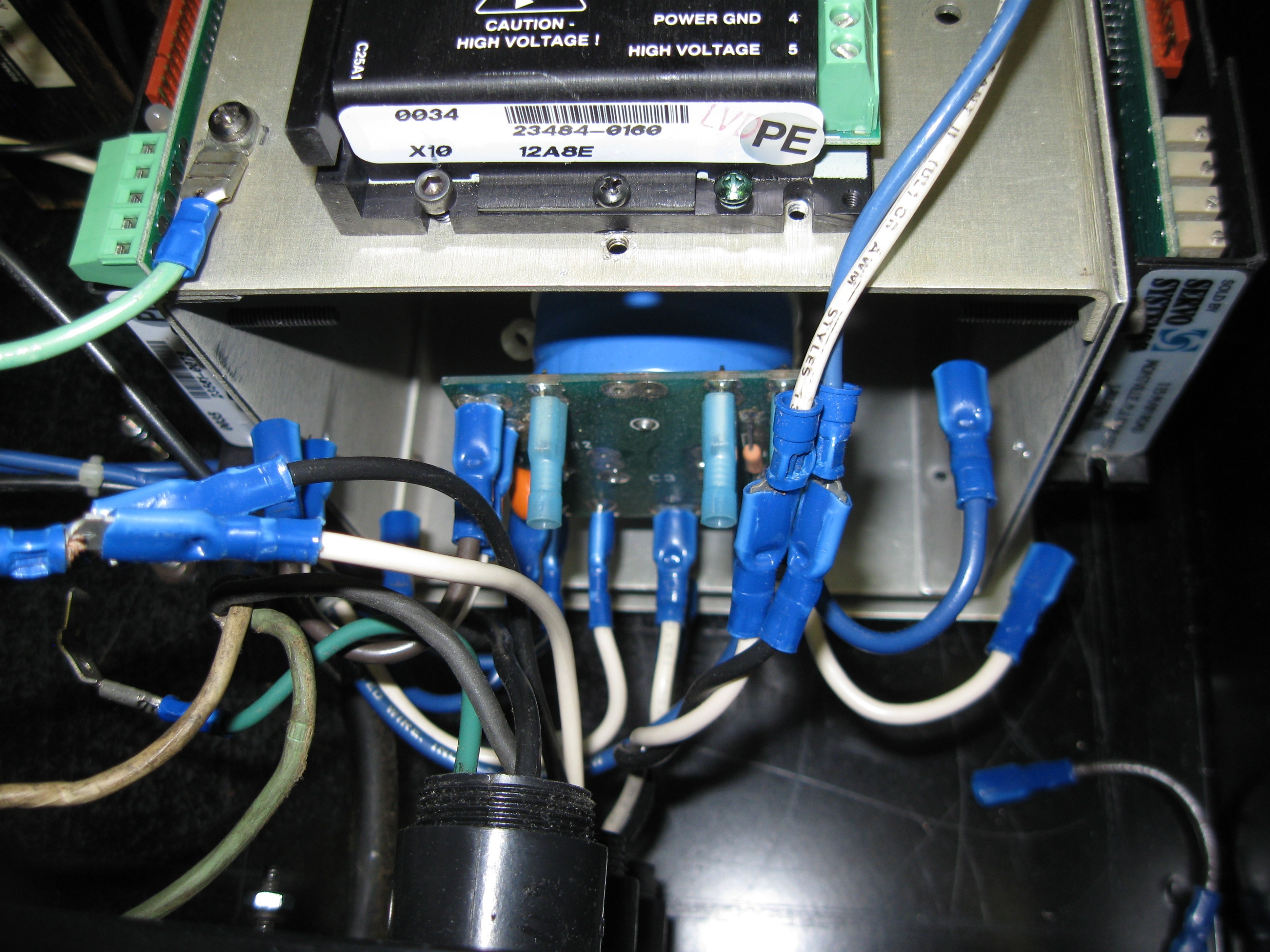

I am need to confirm leads. The pic is the end of the PCB with capacitor, the blue lead is to the right side of pic and I placed that on pin 5 on the P2 single connector (HIGH VOLTAGE DC Power Input) see this link: servosystems.com/pdf/amc/12a8.pdf.
I am attaching the white lead (the just to the left of center in the pic) to pin 4 the (POWER GND Power Ground (Common With Signal Ground))
I am attaching where the brown lead (hard to see, but is to the very far left) is to the pin 3 (POWER GND Power Ground (Common With Signal Ground)).
Now to P1 single connector: Pin 4 & Pin 5 go to 7I77 card DRV 0 & DRV 1.
Does this sound correct? Is there a way to confirm prior to powering up?
Many, many thanks in advance for help, it is warmly welcomed!
10 Mar 2017 16:14 #89338 by lakeweb
First is to power the power supply without hooking it up to the amp and use a volt meter to be sure where the positive out and ground are. Use an incandescent light bulb to load it and be sure. Then you can hook it up to P2, pin 4 and 5 of the amp accordingly.
I don't see any connector called DRV0 on the 7i77. The output from the 7i77 is from TB5 and called GND and AOUTx. See page 9, pdf 15 of the 7i77 manual. Those go to P1, pin 4 and 5 of the amp.
Best, Dan.
10 Mar 2017 16:38 #89340 by andypugh
Yes, you do :-)
I see brown, blue and white leads. I have no idea how to tell which is which from here.
The rectifier is probably marked with + and -, as is the filter capacitor. You need to figure out which or white, blue and brown is connected to +ve and which to -ve, either by inspection of the PCB, buzzing through with a multimeter when the system is powered off (and has been for long enough to discharge the capacitor) and/or testing the voltage and polarity with the PSU powered up and no drives connected. You should also check that the voltage is no more than the 80V rating of your drives.
