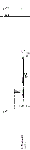

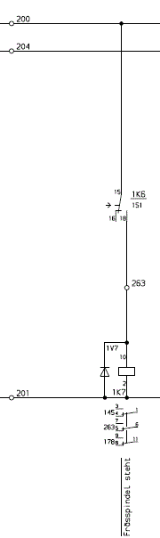

Q1 after your question i noticed that your power schematic on page 1 of this thread is a little different to the 700C. There have to be made some changes because your brake for toggeling is engaged by the triangle Relais. Can you tell me what kind of device 1K6 is and what its contacts do?

Q1 1K6 is a time delay relay. It is set for 7.5 seconds.

Is the 1K6 Contact wired to an PLC Input?
I then will do some changes for the brake part soon.
I have an hal config for testing/setup the single stages step by step, i will comment it and then post it.

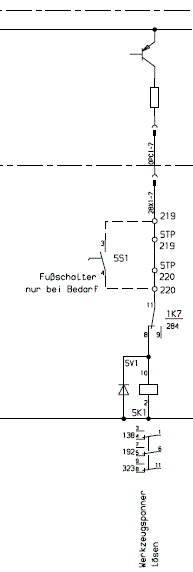

Thanks for looking at that. The MH400E has no PLC.The 1K6 relay controls the 1K7 relay which signals that the spindel is stopped to the NC controller. 1K7 is also the inhibit on the tool changer.

The intern Philips PLC (gearchange, safty etc.) ...
But now this signal is wired to linuxcnc?
- RotarySMP
- Posts: 1524
- Thank you received: 562
27 Feb 2018 22:53 #106681
by RotarySMP
Yes, through the Mesa 7i84.

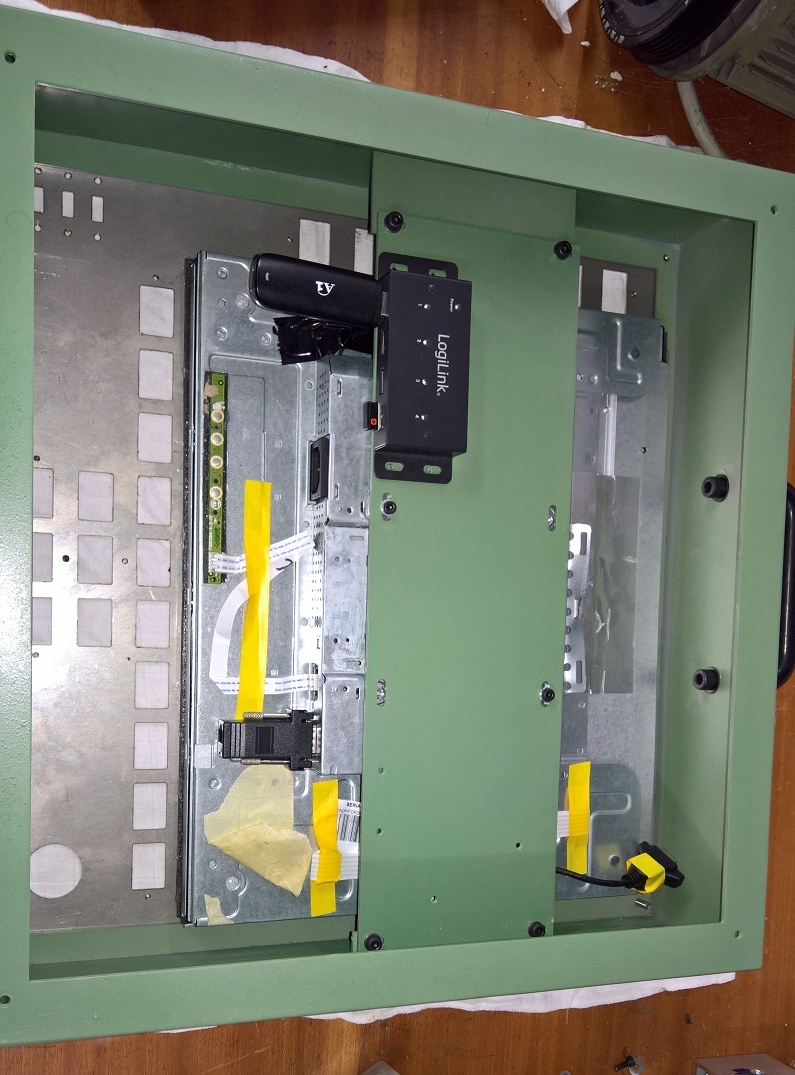

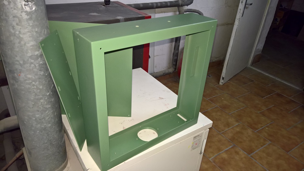

Still too cold in the basement. I sprayed one coat of green paint ont he control housing, but it will probably take all week to dry.
