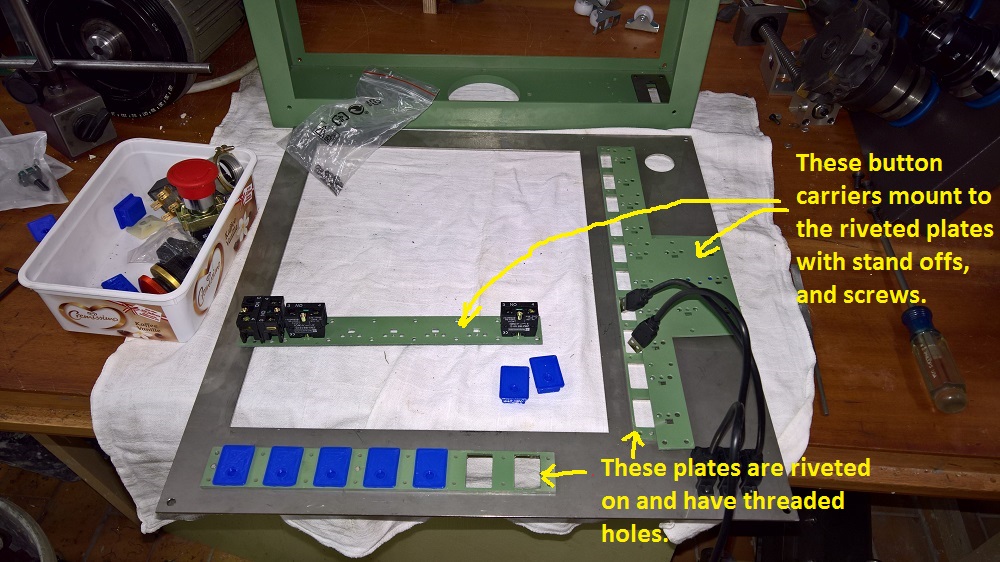

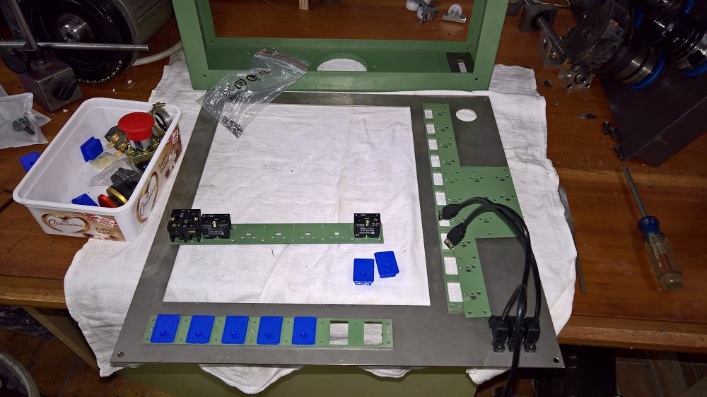

12 Apr 2018 13:57 #108876
by J Green
Replied by J Green on topic Retrofitting a 1986 Maho MH400E
Glad to see you are making more progress.
Was comparing the front panel photo of Jan 3 to this photo and wondering if the front to back have been switched. Or is this photo showing a before the riveting is done layout?
Hope to include a PDF showing some miniature 5 volt light bulbs that might be useful to repair a LS 403 scale. Seems interesting the range of expected life span for the bulbs.
Would be useful to know what the LS 403 photo sensors spectrum sensitivity is, especially if trying to convert from incandescent to LED .
Any way glad to see you are making headway !
confused Bob

12 Apr 2018 14:08 - 12 Apr 2018 14:09 #108877
by RotarySMP
Hi Bob,
The photo above is the back side of the front plate. I didn't want a bunch of extra threaded fasteners through it to mount the button carriers, so I had plates lasered which got riveted. I'll update the photo to make it clearer.
My LS403's require both 5V and 12V DC supplies. Not sure which supply is for the bulb, and which powers the sensing head. Thanks for the file on the bulbs.
Mark
Mark
