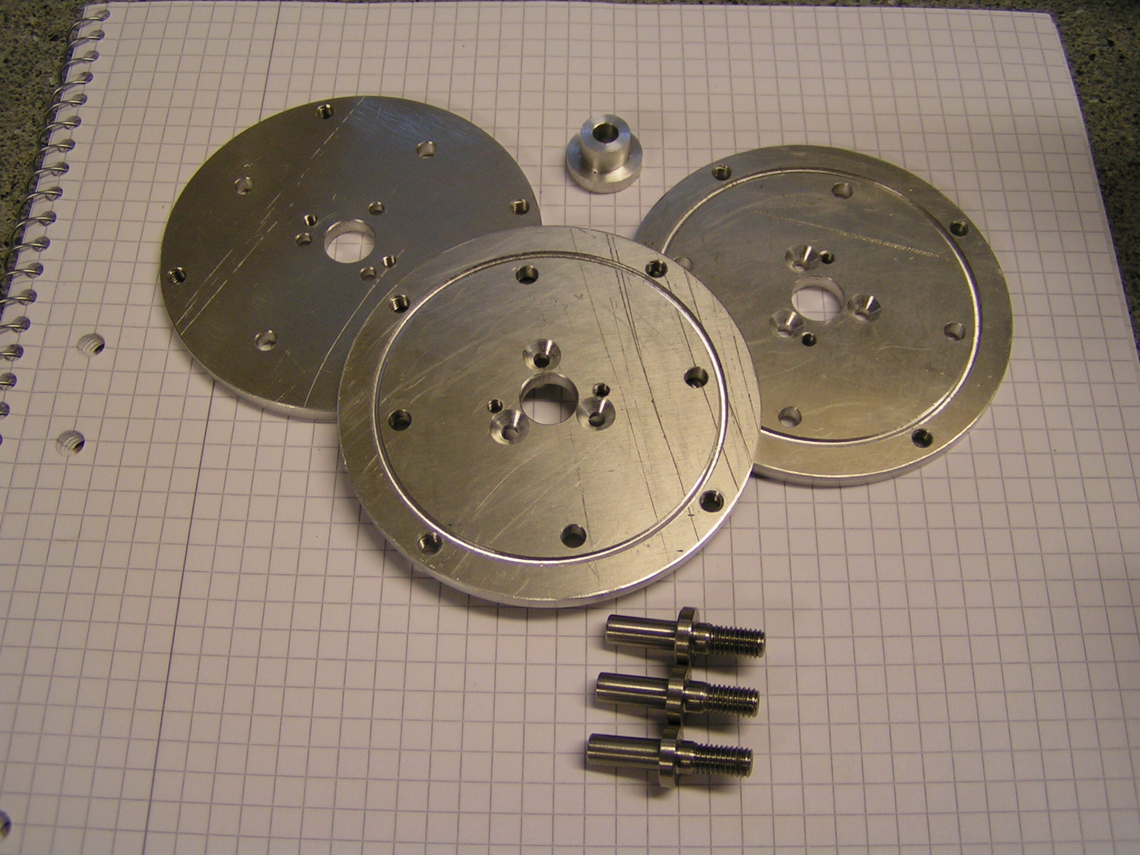

I am having troubles with the servo adaptors. They screw at the end of the tachometer and they have considerable rounout.

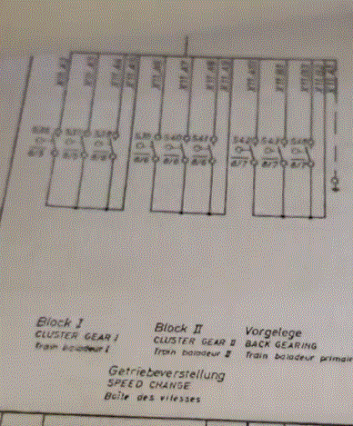

Will the gearbox.comp allow shifting with infinitely variable spindle speed. I have a Deckell FP5NC with variable speed spindle motor, VFD controlled. It has what looks to be the same 18 speed gearbox.

They deckels gearbox seem very similar to the mahos.

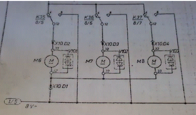

That video of the open deckel gearbox is excellent. I added a link to it in the guthub gearbox.comp wiki. With respect to the Deckel gearbox, while mechanically similar, from the wiring diagrams in the video John posted, it looks like the deckel feedback is done with three switches per stage, rather than four by the MAHO. If so different logic will be needed to determine which direction to turn the motor from an unknown position (assuming the Left-mid feedback is the missing one).
Also it looks the the gear stage motors are controlled LH/OFF/RH with a single, relay per stage, whereas the MAHO uses separate on/off and polarity reverse relays. Although maybe I understand the logic here wrong.

Have you considered making new shaft exensions with oversize encoder extensions, installing them on the servos, strap the servos to the bed of the lathe, power the servo, and turn the encoder shaft extensions to final diameter so that they run true to the servo?
