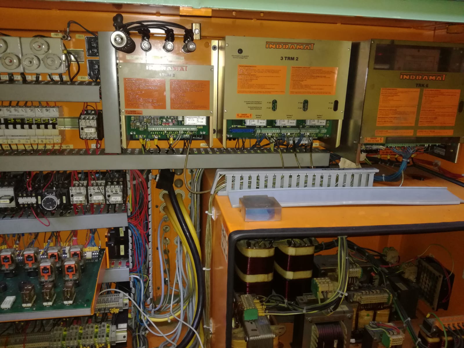

So i bought today a Maho 500C, with a problem on the control, i atached a picture with the screen,wich shows the error.
greetings from Southtirol
Bernd
Servus Bernd,
Welcome to the wonder world of MAHO ownership
The error message seems to refer to the drives or motor tachos. Does your 500C also have an Indramat 3TRM2 amplifier unit? Do you have the Indramat manual? I found a pdf of it somewhere on the web, so if you need it, PM me your email address so I can send it to you.
There are fuses on the Indramats PSU card, so that might be a good place to start looking.
Mark

- Bernd
- Posts: 11
10 Oct 2018 12:34 #118635
by Bernd
Replied by Bernd on topic Retrofitting a 1986 Maho MH400E
Servus Mark,
im happy like a little child, just because i have purchased a old piece of steel and electronics, thats not working... for other peuple its difficult to understand...
yes it is also equiped with Indramat drives, it has one 3TRM2 for the XYZ, one different for the spindle drive, and i think the little one is for a eventual B-Axis.
The machine arrived today, in the next days ill try to find out whats wrong.
Bernd

- Bernd
- Posts: 11
10 Oct 2018 20:54 - 10 Oct 2018 20:55 #118657
by Bernd
Hi Christian,
its a MH500C, with Philipps 432 (i think version 9). no, the machine is equipped only with a standard rigid table. maybe the past owner had one... Fortunately i've got all the original documentation for the machine, But thanks anyway for the very kind offer. If somebody needs any copy's from other documentations for the 500c series i can scan them.
in the meantime i checked the fuses like Mark advised me, they seem to be Ok.
If i start the machine with the hydraulic switch the Servos sounds like they get current, and the brake on the Z-axis releases.
as discussed on other forums the failed hardware-check "axis 1 2 3 LMS failed" seems to be a problem on the control side, i think LMS stands for something like Längenmesssystem or length-measurement system.
