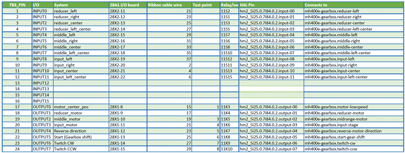

I think the dekel gearbox motor rotates only in one direction end cycles from all 3 gears so the is no need for 4rt camAlso it looks the the gear stage motors are controlled LH/OFF/RH with a single, relay per stage, whereas the MAHO uses separate on/off and polarity reverse relays. Although maybe I understand the logic here wrong..

Indeed in the deckels the gearbox motors rotate in only one direction. So they don't need 4rt cam. The lader or .comp development for this gearbox will be much easier.

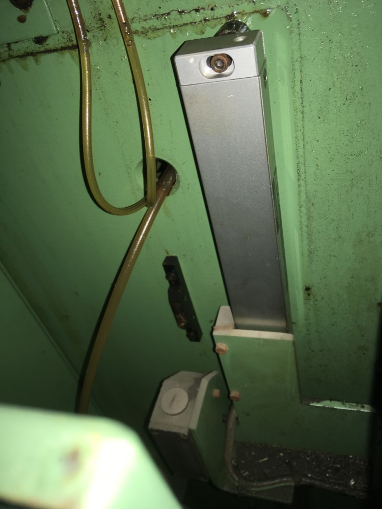

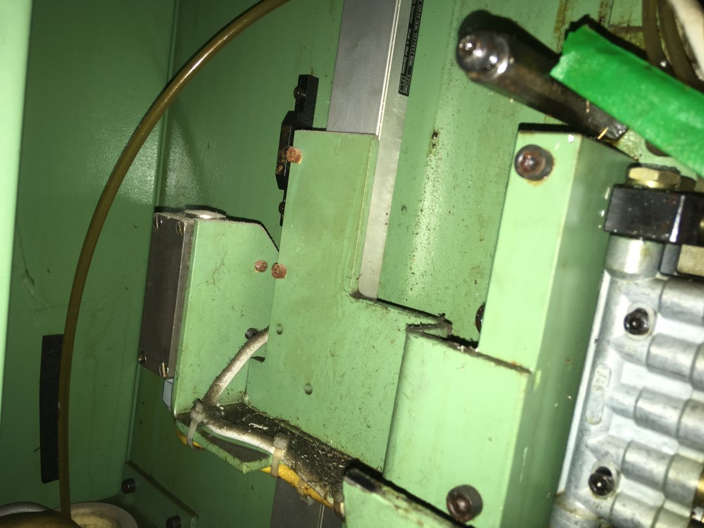

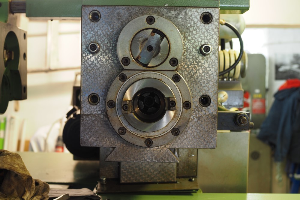

Not much done this week. Since the Z has crept up, I was able to finally remove the LH side rear splash shield, and the transformer cover, so I could get to the Z linear encoder. With that splash shield off, the vertical head could be swung out of the way. It looks like the horizontal spindle has never ever had a tool in it. Pristine.
Next the Z linear encoder will need trouble shooting.
The Y encoder worked again yesterday, so there must be an intermittent fault in that system, which will need tracking down.
Mark
Mark

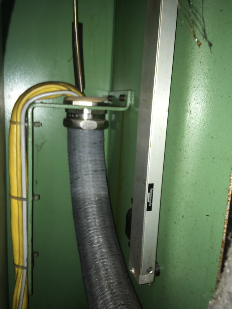

Mark Always good to read of your progress with the MAHO. Hope you get into the details on how to find the problem and then fixing the scales.
Question - Your last photo ( Y axis scale ? ) shows a flex-conduit going past the scale body. My question is Who makes that flex conduit., or who (other than DMG ) sells that type and style of flex conduit ?
Hoping you get stuff sorted out and still have time to stuff the MAHO thru the way too small shop door before winter. Might think about some easy clean floor oil drip catcher. My machines mark their spot as much as a Harley or Triumph motorcycle does/did.
Just a thanks for more of the saga.
Bob
Bob

Mark, to get it right, your machine was already equipped with Heidenhain scales instead of Philips ones? What series is mounted? How is the cable mounted? My Kunzmann has LS903 as far as I remember that have a remote socked with about 20cm cable. I already dismantled one to clean the sealing. Cable to the CNC is connected using the 9-pin Heidenhain round socket. The scales have 11uA sinusoidal signals, so any dirt between pins or bad insulation may have severe impact. What EXE converters do you use? I bought 3 brand new EXE 602 last week for 40€ each, so in case your not sure about yours it may be worth to buy one new and test.
