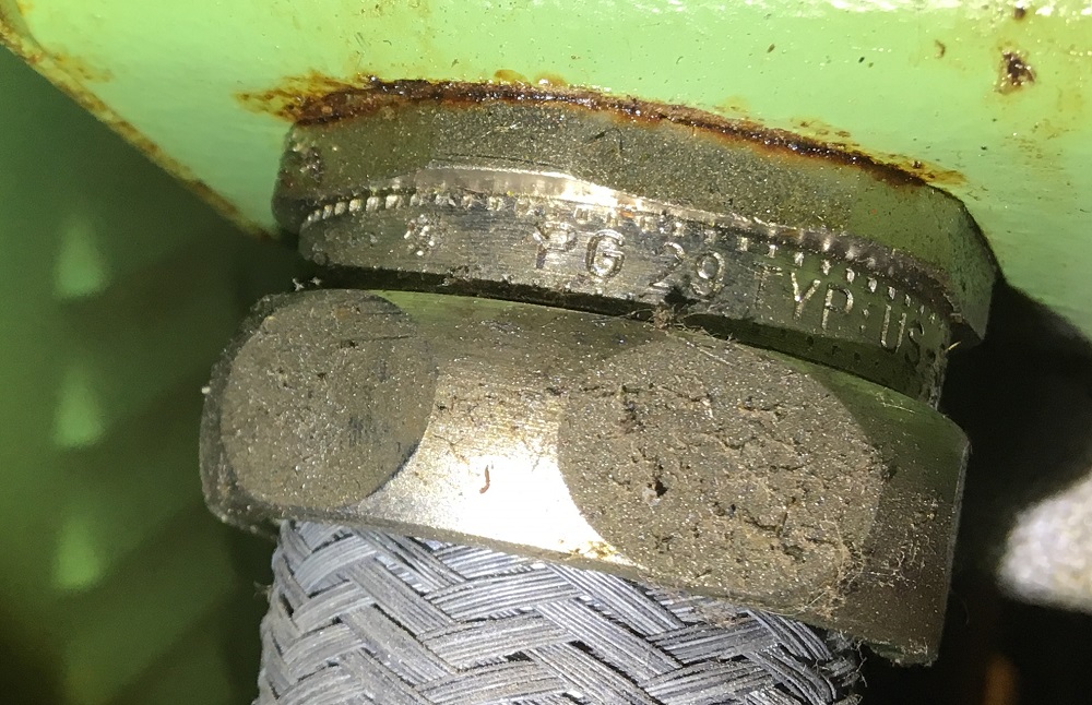

Bob,
I took a look at that X axis braided conduit yesterday, but there is no obvious brand marking on it. The mounting hardware is marked PG 29 TYP US ... .
Sorry, I just realised I didn't get a full shot of that part number, but googling it reveals that PG29 is just a generic gland nut.
www.mencom.com/shop/cable-glands/pg29-me...ass-0-702-0-994.html
The Z axis conduit is larger. Sorry I forgot to photograph that as well.

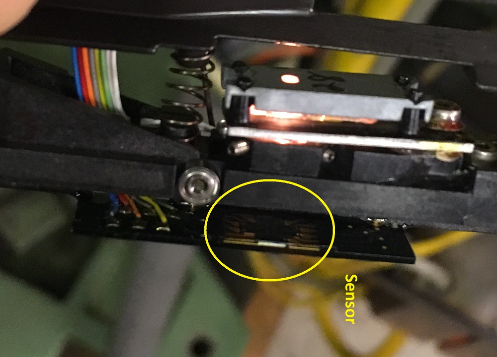

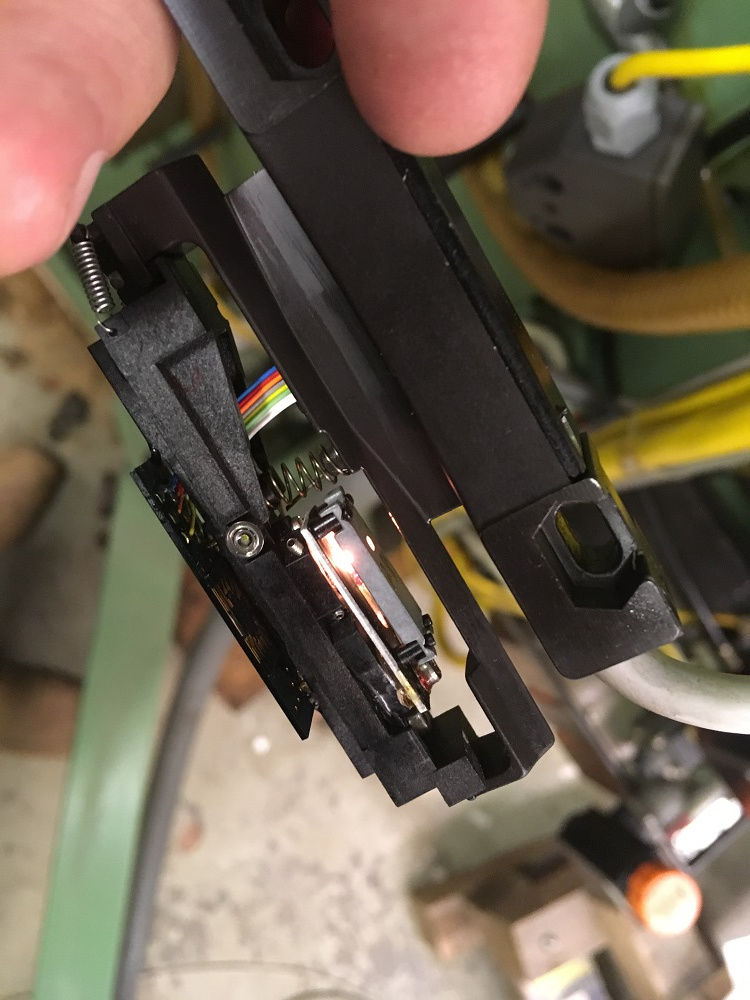

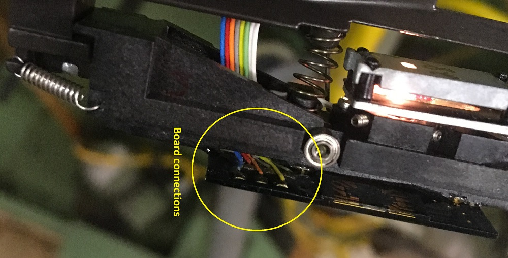

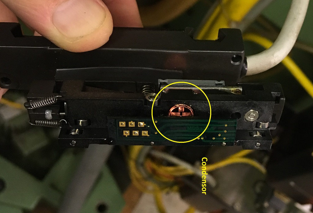

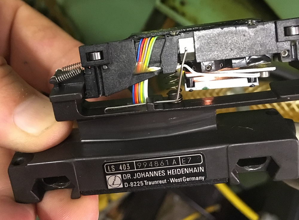

Yes my MH400E has the Heidenhain LS-403's. The cable is hard wired to the sensor head with about five meter cable to an M23 connector. I recycled the three axis EXE board from the Phillips control cabinet.
It is also hard wired with the matching connectors to the encoders, and with hard wired output cables to the Phillips. I made a metal shield (the grey square) for that EXE board and mounted it to the wall of the cabinet. You can see the encoder connectors on the floor of the control cabinet.
The only change I made was to cut off the Phillips dSub connectors, and terminate these wire into the MESA 7i77. Since the X axis encoder -> EXE -> Mesa signal path works perfectly, I have used that encoder to check the other two axis of the EXE, and they work.
Yesterday I pulled the sensing head from the Y axis.
This is the axis which has a signal but is flakey. I cleaned the scale a few months ago and it started working normally, then got flakey again. As you can see it is not a bulb issue.
I'll reclean the scale, and this time also try to clean the condensor and sensor more thoroughly.
The solder joints of the wiring look fine.
Good idea to look at cleaning the pins on the m23 connectors. They look spotless, but cleaning should remove a variable.

02 Oct 2018 09:04 #118337
PG = Panzergewinde = Stahlpanzerrohrgewinde = steel armoured conduit thread
en.wikipedia.org/wiki/Panzergewinde
It's an interesting thread in that it has an 80 degree thread angle, so has a relatively shallow depth for the pitch.
(I think the steepest full-thread is BA at 47.5 degrees. Proper threads are 55 degrees, of course

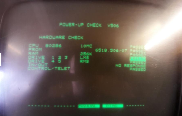

02 Oct 2018 12:19 #118342
by Bernd
Replied by Bernd on topic Retrofitting a 1986 Maho MH400E
Hey y’all
your work and your colected know how in this forum is so professional, i thougt i could be able to do also a Retrofit.
So i bought today a Maho 500C, with a problem on the control, i atached a picture with the screen,wich shows the error.
Im a mechanical engineer, and know CNC, CAM ec. but have no skils in Linux.
Maybe i can disturb you sometimes with my questions, and one more Maho gets a new life
greetings from Southtirol
Bernd

Mark, my scales are equipped with a remote m23 socket, connected by a 20cm cable. These connections where performed by Heidenhain and are a bit difficult to service. I expect the sensor head and the glass scale to be fine. If there had been a scratch or dirt on the scale, the failure would always occur at a distinct position. The Heidenhain EXE has a separate failure signal to indicate a missing edge or false differential signal. Maybe it is worth getting one and check the scale if you are sure the wiring is fine. The original 3x2 + 1x2 cable itself is quite robust, meaning as long as you can't see a mechanical damage it is electrically fine. Maybe you already wrote it but did you swap the scales of different axis (with the drives off!) to check the EXE? Christian

Is the EXE boards interpolation level adjustable?

03 Oct 2018 06:03 #118386
by cgroth
Replied by cgroth on topic Retrofitting a 1986 Maho MH400E
Bob,
you may get flexible sleeves here, though I did not try them yet:
www.techflex.org/de/verzinntes-kupfer-ge...t-tinned-copper.html
From the EMI point of view it is not necessary as long as you use good cable, which has separate shieldings per differential pair and / or shielded power cables. It is not that easy to push the cables throught the metal slevees yet they give your machine a decent touch. Christian
