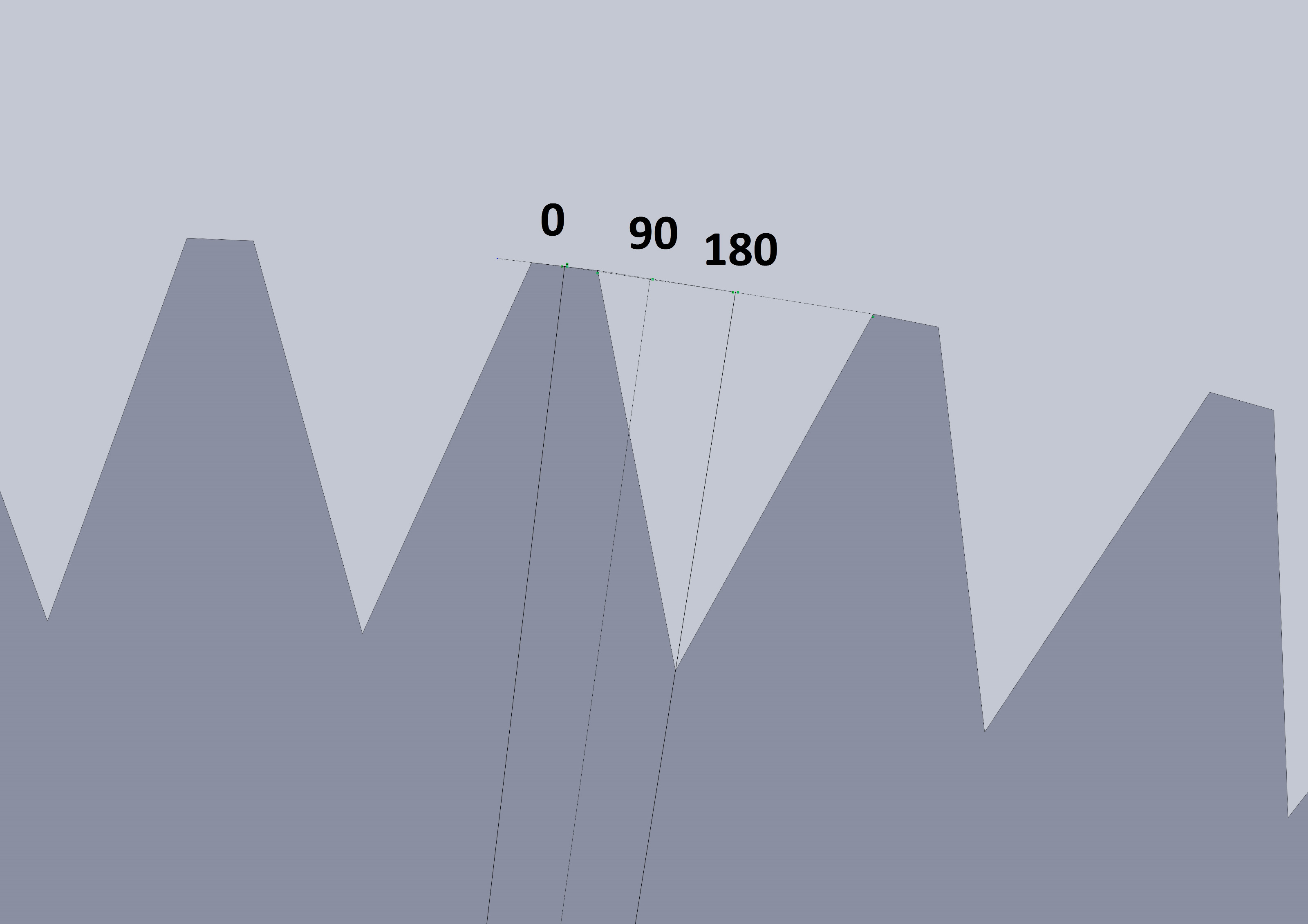

It might work if the sensors are fast enough. There are specific devices for gear tooth detection, for example Avago ATS667LSGTN-T
But.. Is that gear running 1:1 with the vertical spindle?
Replied by andypugh on topic Retrofitting a 1986 Maho MH400E
Hi to all, is this a good idea for spindle encoder on mahos?

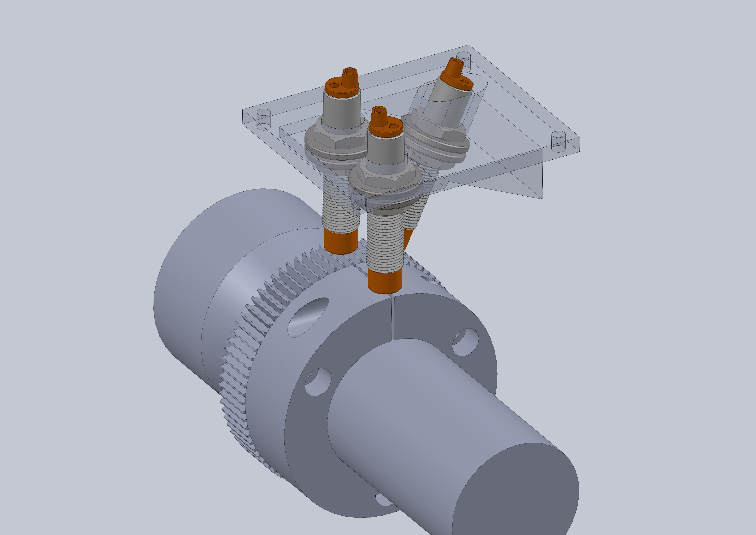

Thank you, the shaft rotates 1:1 with the vertical and horizontal spindle but in reverse. 4000 revolution per minute equals 67 rotates the second, the gear has 80 teeth so 67X80 is 5360 tics per second or 5,5 KHz. I was thinking one of these sensors, they claim 10 KHz or more, down to zero speed some off them.

Hi John, that is a good idea. I take it you are planning for rigid tapping. On the 400E, that gearbox cover is one peice across the whole head, so you would have to remove the motor, and the vertical head swinging arm at the least to get it off. Is this cover smaller and easier to work with on the 600E?

Make sure that the AB sensors are 90 degrees out of phase, not 180.
(Don't ask me how I know that's a possible mistake to make)
When one sensor sees a gap, the other needs to be at the tooth edge, not tip.

I can confirm that this will be a good way to put the encoder for rigid tapping. It is in fact similar to what is originally done on my 600E (1990 vintage).
What is done on that is that there is a shaft that is rigidly connected to the shaft going from the gearbox and forward. This shaft goes all the way through the gearbox, and is sticking out in the back. And on that shaft there is attached a 1024 (I think.....) lines/rev encoder with index.
This index is also needed when orienting the spindle for tool change (mine has that too:-)).
For this to work out correctly one have to adjust a parameter in the setup to make sure the orientation is correct. And this will need to be adjusted after the head have been disassembled (like I have done). Tha allignment will be off when you reassemble since you will most likely engage the angeled toothed gears differently when you assemble it back together.
But you can rest assured you are going about this the same way as Maho is doing it on later model mills, so you should be quite safe.
Althoug I would suggest having a higher frequency response in your readers. Remember you are reading the phase relationship continously. And that means you need more than 1/2 frequency margin. I'm not saying it won't work, but I'd be more comfortable with a higher margin than what you have now.
