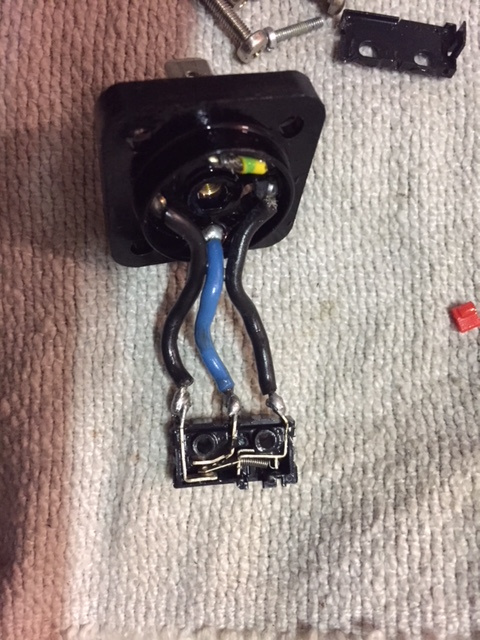

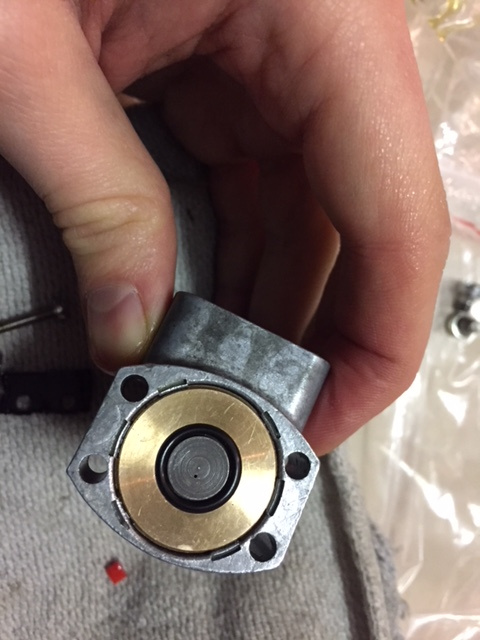

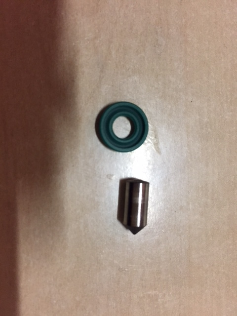

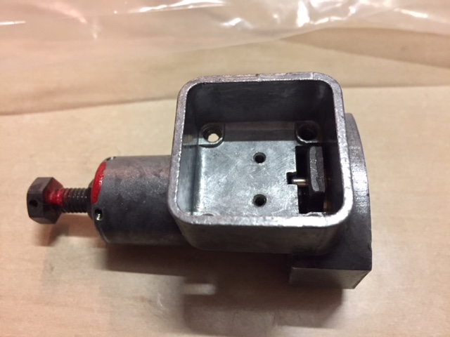

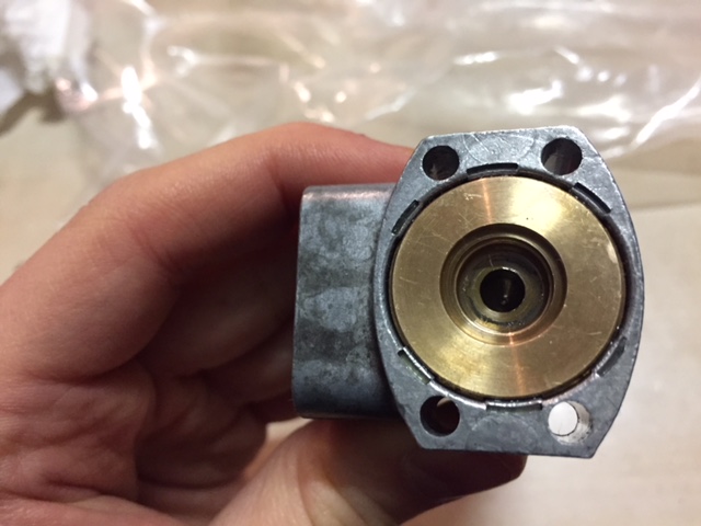

Hi guys, lots of interesting posts here, as usual! I was busy with my little business but now I have more time to post. One small update on the Maho that's completely unrelated to LinuxCNC is that I had to replace the gaskets on my DG35 pressure switch. It's a device mounted on top of the hydraulic pump responsible for tool clamping.
The pump would switch on and off in short jumps, making a loud noise as the breaker in the electric cabinet jumped back and forth. Turned out there was plenty of oil in the pressure switch. I took it apart, cleaned the oil and found wear on a gasket mounted on top of the actuator pin, responsible for converting pressure into motion and flipping the microswitch.
Since the gasket is not a standard part (as far as I know), it had to be custom made by a company specialising in machining custom gaskets from polyurethane rubber. This was a once-in-a-lifetime opportunity to also replace the two other orings in the pressure switch (they were a bit flat). I paid around 6€ for all three parts.
Predictably, the pump no longer malfunctions. Replacing the entire pressure switch would have cost me around 120€ (it's made by Hawe). Honestly, the chance of anything happening to the metal parts is almost zero, the mircroswitch inside costs maybe 0,50€ and the gaskets are also very cheap. So there's no reason to replace the entire thing, especially when the machine is used for hobby purposes.
In my case, I've been using my smaller bolt-on spindle exclusively for a few months now, so fixing the pump wasn't a big priority for me. But it got so bad that the switch would flip on and off hundreds of times during one machining session and I was getting worried something else would break as collateral damage.
I also noticed that the label on the circuit breaker in the machine's cabinet was different than what I have in the schematics DMG sent me. It's very likely that the schematics describe the entire class of these MH600s rather than this individual unit. Which means that I probably wasted a lot of money and postponed the retrofit due to a lack of funds for Mesa cards, whereas I could have just gone with the stuff Mark sent me. Well, live and learn.
All in all, I sincerely hope no one else here will ever have to replace the gaskets in their machines' hydraulic pumps, but in case you do, I'm attaching pictures of the parts I described. It's a real slog to clean oil from a microswitch!

Great Input. My switch unit on the hydraulic pump hat the backshell broken. I just epoxied it back on, as there is no sign of other damage.
