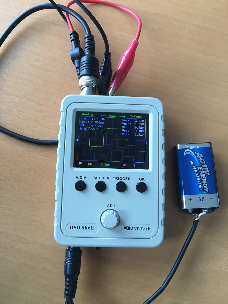

Instead of a second voltmeter, I have this little bundle of excellence...
Who designs a tiny, potable hand held device which will obviously be battery powered, but makes no provision for the battery in the housing???
I'll hook that up and see what it says about ripple voltage.

aahhh, nice, a DIY scope.
You could watch the drop-outs in LinuxCNC while moving the axis at lowest speed,
hook up the scope and measure several Voltages at different stages like 12V, 5V, ICs, etc. on the PCB while that dropouts occur. This might be the fastest way.

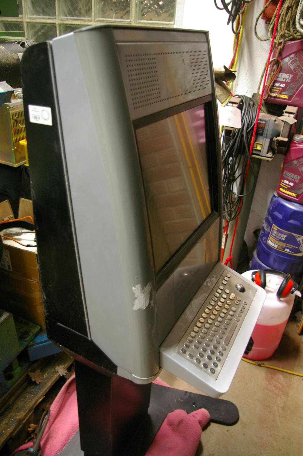

I talked to a co-worker that I'm looking for a touch monitor and, guess what,
he was cleaning up a storage room and found this.
It is a former public information stand with vandalism-proof keyboard and 17" Touch Monitor.:

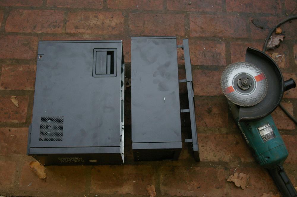

A chopped Desktop PC with i5 Quad-Core, 16GB RAM and an 500GB SSD:

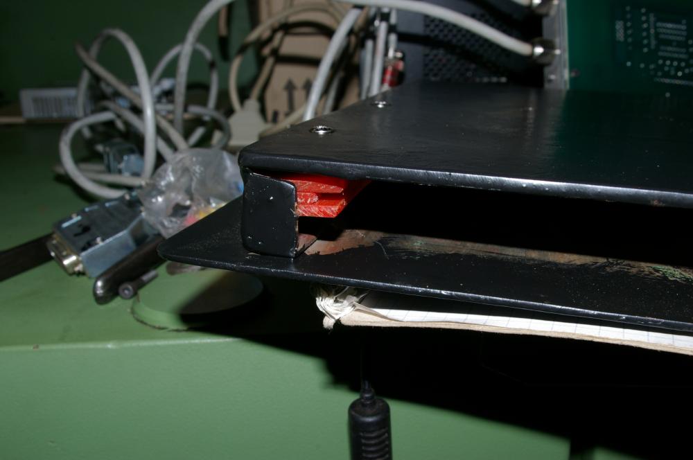

A selfmade housing for the MAHO-EXE.
It is made of 3/4/5mm junk sheet metal.
The PCB guide rails are made of rests of sheet plastic.
Not a beauty, but it works and is bullet proof

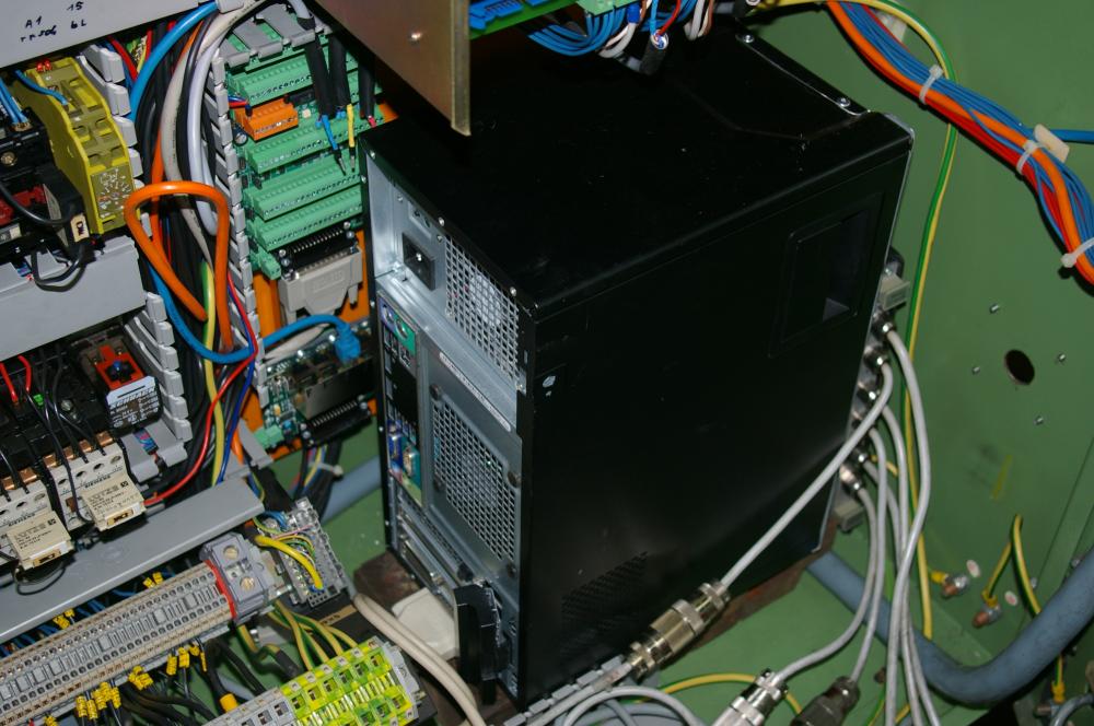

The PC took a seat for the picture in its later position.
I chose this position because I need the space behind it, beside the Mesa boards, for the 4th-axis controller which I will definitely realise in the future.
As you can see, the cable of the X-Axis glass-scale is too short to mount the EXE where Mark placed his one.
I will have to exchange that cable in the long run:
