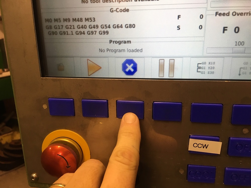

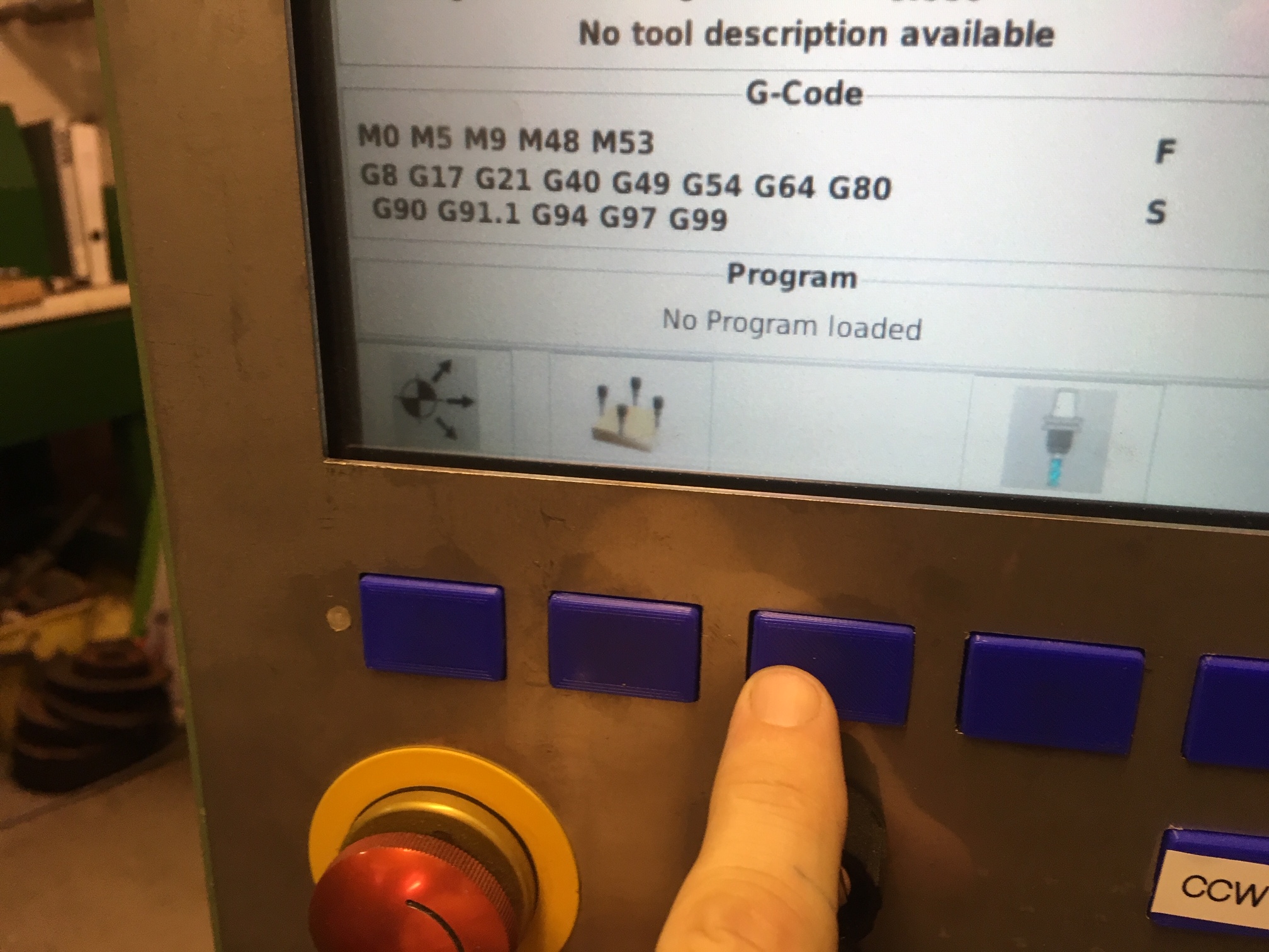

I agree about a physical button. With the touch screen, you have no tactile feedback if your stop finger moved while looking away to the work or spindle. That is what is cool about gmoccapy. When you need your physical run/pause/stop button, it is there. When you are not in mode where you are running a program, it is freed up for a different purpose.
Program run mode...
Jog mode...
Mark
