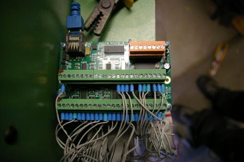

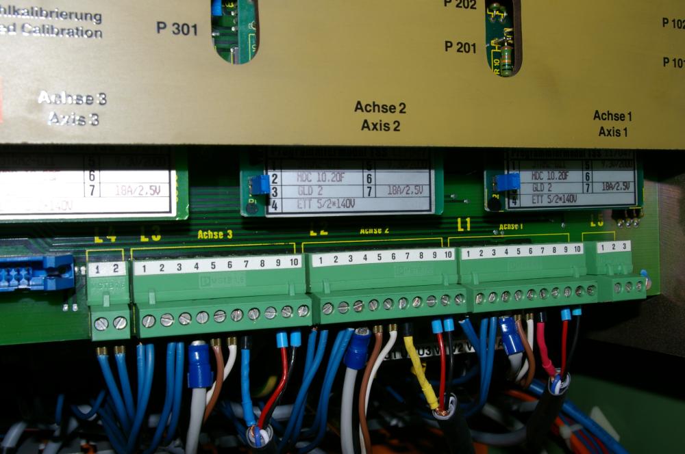

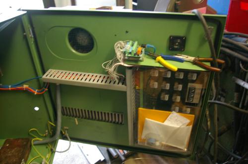

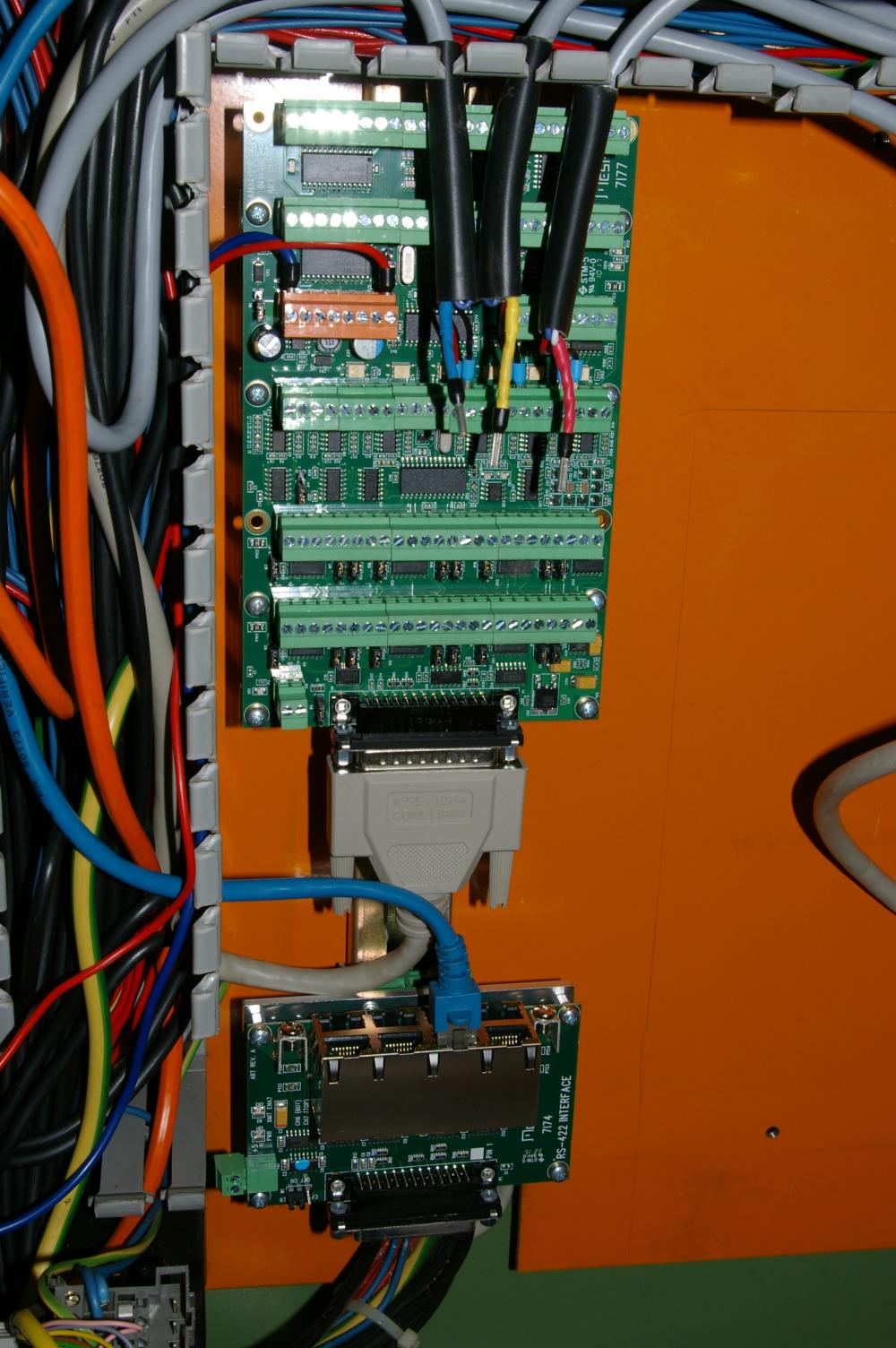

17 Jan 2019 06:28 #124329
by hanmon
Replied by hanmon on topic Retrofitting a 1986 Maho MH400E
Hi Mark,
nothing spectacular, yet.
Wired up the relays for a first test on the weekend and color coded the servo controller wires.
As you already mentioned in an email, every MAHO is different.
I have this cooling unit mounted in the cabinet door, therefore the relay PCB is located in the lower right corner rotated by 90°.
As you can see, I installed an additional 7I74 Eight Channel RS-422/485 interface which connects with the
7I84 Isolated remote field I/O card and a 7I73 Pendant/control panel interface which will be located in the control panel.
More pics will follow.

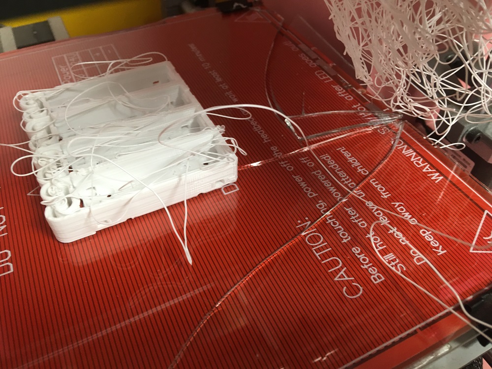

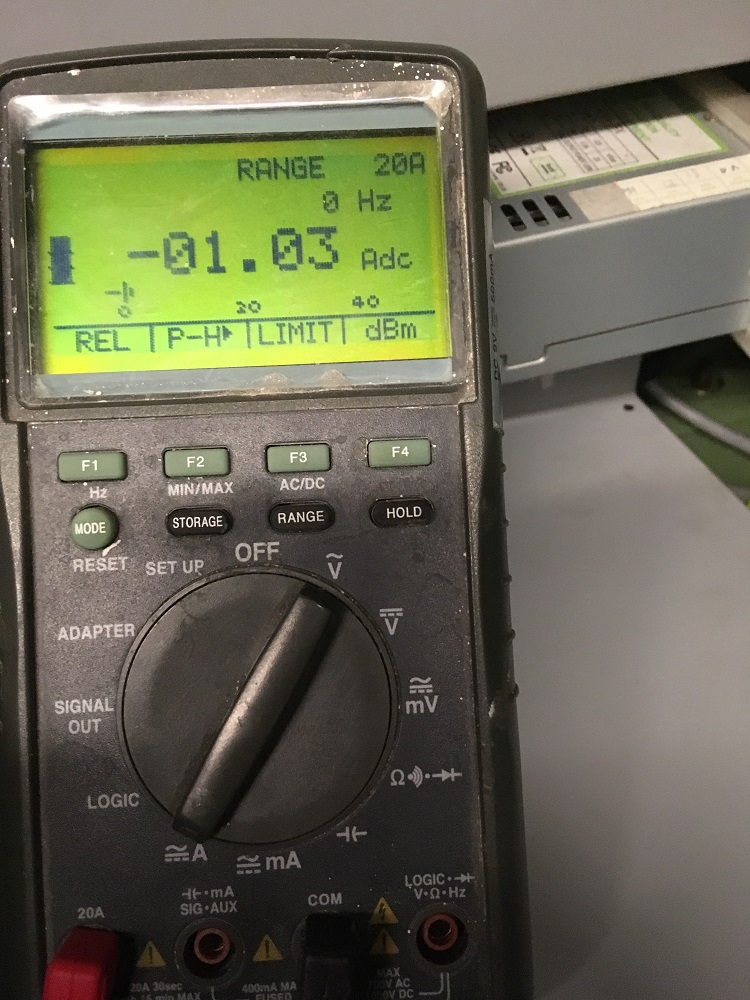

I got a start on the troubleshooting yesterday. Switched the EXE's back to original config. Y on the 19A1 EXE, and Z on the 602 EXE.
There are a few different rabbit holes to explore:
- EMI from the 5V chinese
- EMI from the 12V ITX PSU
- Failing capacitors in the Y EXE channel
- ??? Floating single ended signals?
I'll try and work through them systematically. First up - the capacitors.
After letting the 3D printer run unattended, where it got lonely and rebelled...
...finished wiring up the battery pack with 4x 2600mAh NiMH's. The are a few years old and only delivered 4.8V at idle, dropping to 3.8V powering the MAHO's 5V rail, measured at the exe. None of the exe's output a valid signal, and the MAHO E-stopped as soon as motion was commanded. If I need to move on to the EMI rabbit hole, I'll get some fresh batteries.
Switched out the battery pack for my hacked ATX PSU. It delivers 4.8V at idle, which is near the bottom of the Heidenhain spec. Once connected, X and Z were stable, and could be homed, but Y still E-stops as soon as motion is commanded.
The current draw of the whole 5V rail is 1.03A at start up. (Oops polarity reversed.)
Hanno, what sort of current rise would be expected in a failed capacitor case?
The next step will be to return the system to known start condition of using the chinese switching PSU, just to get Y working as before. For this the ammeter will be removed from the main rail supply point and wired to only measure the current to the Y EXE. Then run the circle drawing gcode, which draws one pattern, waits 15mins, draws the next , waits etc. And log the current flow during that test.
Then let it cool down again, and repeating the test for the 12V rail. This may be a likelier target If 5V supply to the 19A1 EXE is only passed through to power the encoder bulb, but the signal processing electronics are powered by the 12VDC.
Mark
