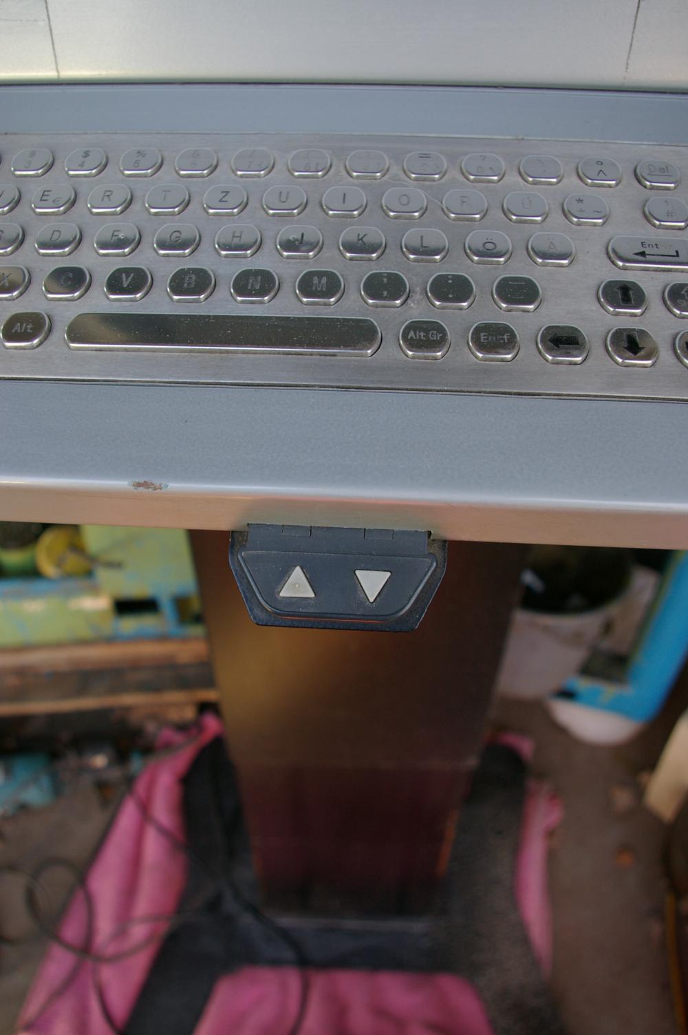

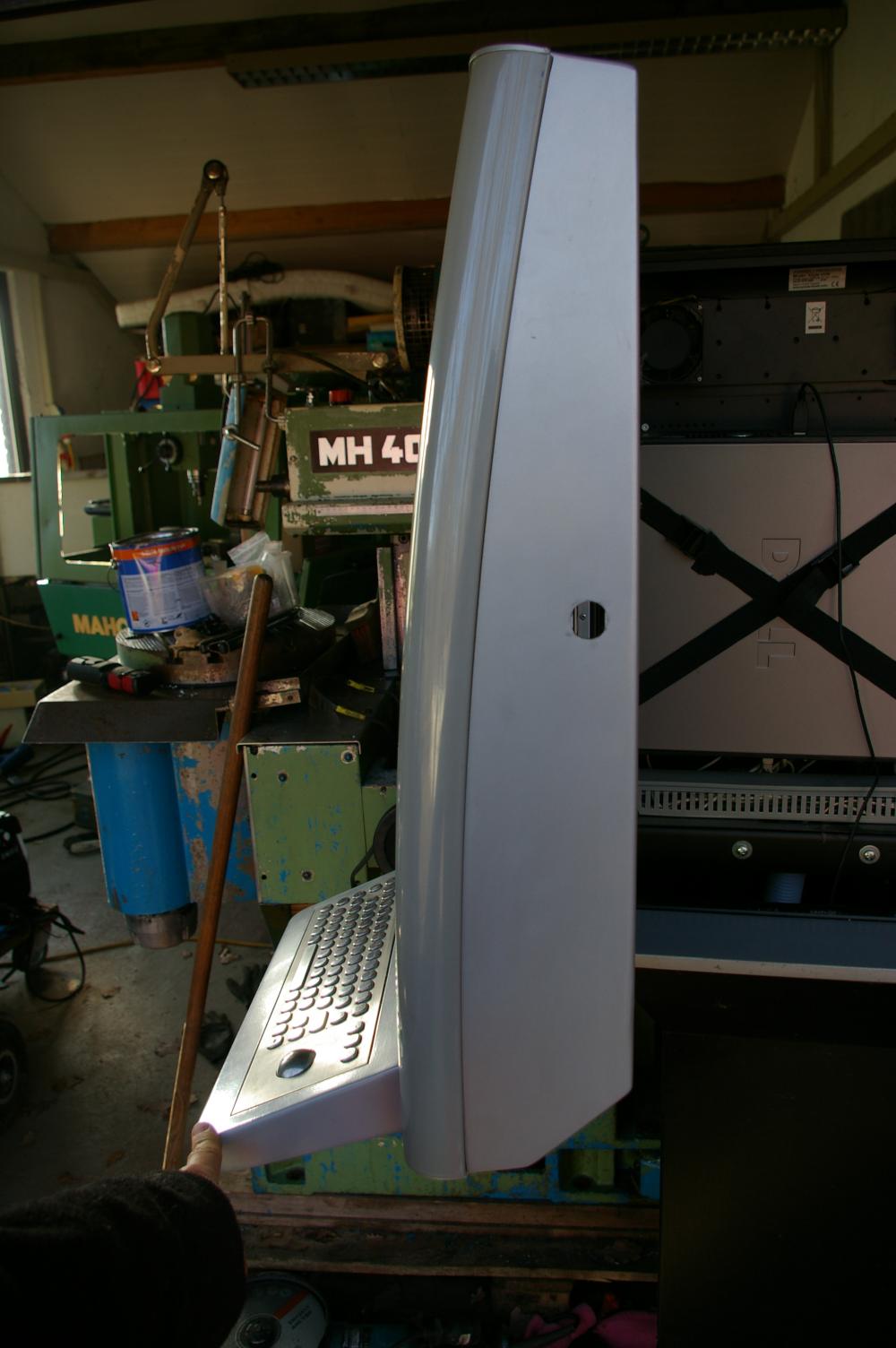

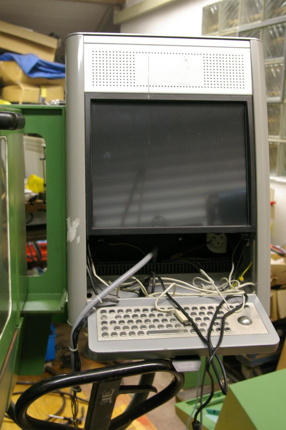

Opened up that yesterday's present.
The monitor and the keyboard work, just the trackball needs a little attention.
I wondered what this little arrow buttons below the keyboard were for.
The whole thing is electrically height adjustible, yeeaahhh

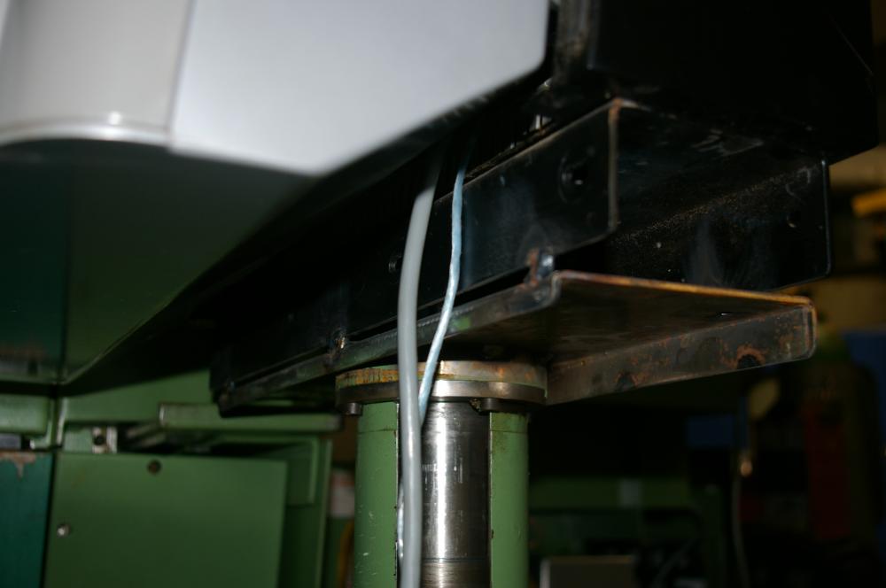

Initially I wanted to use the upper part only, now I'm torn.
The bend edge of the housing is a con for installing the push-buttons on the right like Mark did on his console.
I'm about to finish my shopping list.
I decided to not cut off the d-sub-15 connectors but buy 3 counter pieces for the connection to the 7i77.
Hooked up an old Enermax PC PSU to my 250MHz Philips Oszilloscope to measure the ripple on the 5V and 12V DC.
It is not measurable. As it delivers 5,12V an 12.2V without load I will try it as the power source for the MESA and the MAHO-EXE.
