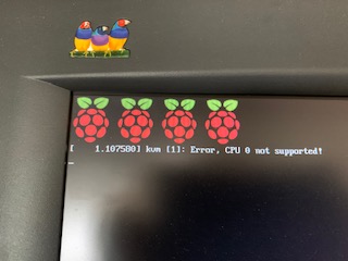

When it was refusing to boot it would hang with this on the screen:
After I added the "total_mem=3072" to config.txt, it would hang there for a while and then boot up. With this fix, I could actually use the system as it was... but I'm not going to. Now is a good time to start afresh.

I wish there was a fix for that meaningless but scary-sounding message. (It can be ignored, and is not the cause of any crashes that might be seen at that point)
It means that CPU0 isn't supported for KVM virtualisation. Which is something that you would never use on a CNC controller.

And, just for the record, that scary message appears to be an artifact of the real time kernel install.
