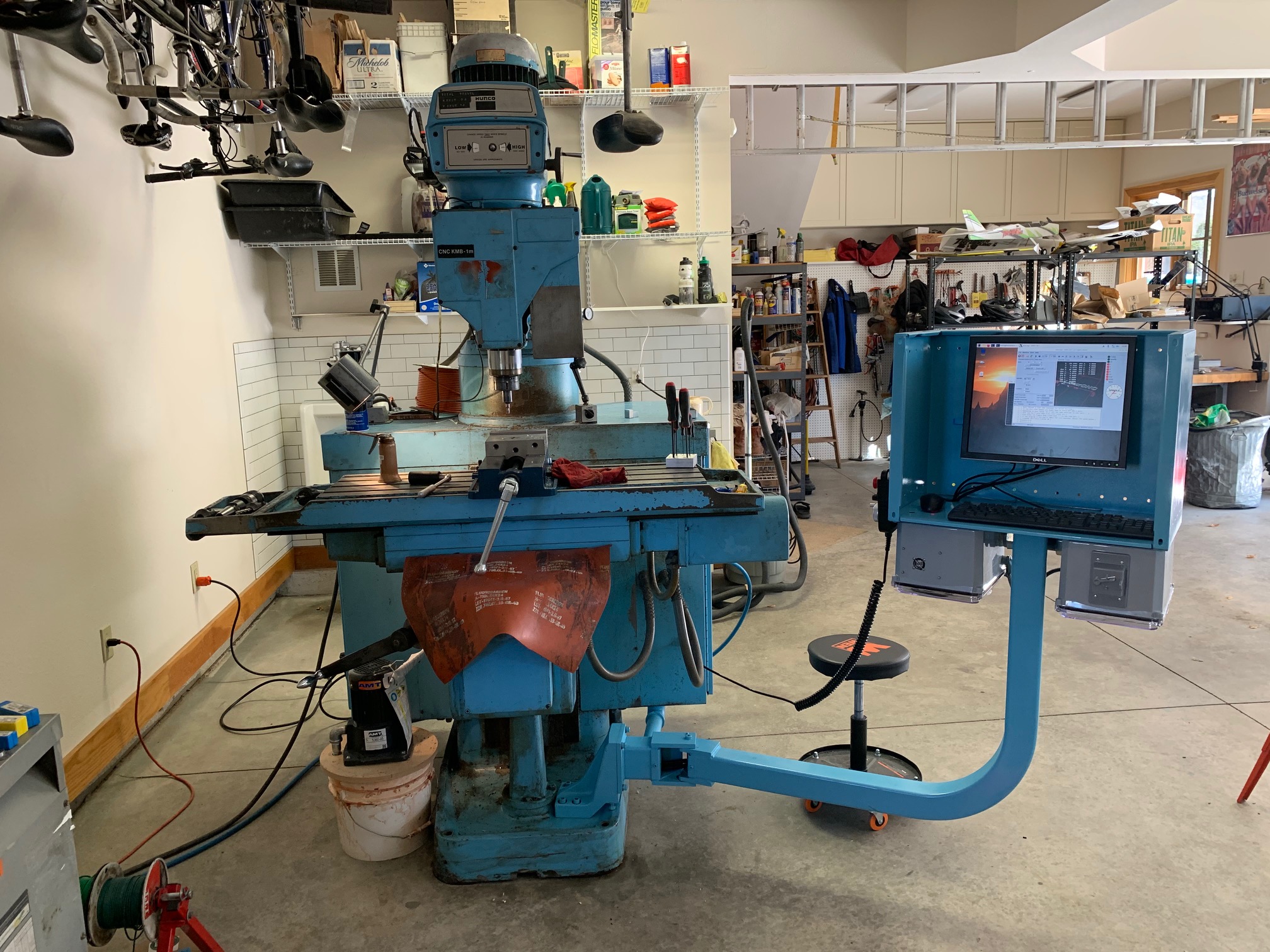

I want to replace my old computer and keep the Servo Drives and Servos in my KMB-1, which has been upgraded to BX. I would like to know the wiring you used on the TB-3 and TB-8. Thank you.

Sorry for have to involve in your thread . I have 3 servo + driver MAX -400 from Electro-craft, I wish to begin one retrofit for my Bridgeport knee. Could you share that MAX-400 instruction manual with me ? Also, I pretty interested to know how Mr Robert did his connection with the MESA board. Could you share it with us ?

19 Aug 2021 15:39 #218147
by _big_
Replied by _big_ on topic Hurco KMB-IS CNC update
Summer time. Haven't been out here for a while.
I don't really have a proper schematic. Instead I have this spreadsheet that shows how things are connected. I can send that to you if you'd like.

28 Oct 2021 01:53 #224540
by CORBETT
Replied by CORBETT on topic Hurco KMB-IS CNC update
Leith,
Nice work on your machine.... Looks Great....
@charlieLedezma
I used EtherCAT for my setup instead of MESA. I am using a Dell Optiplex computer hooked to a Beckhoff EK1100 and several Beckhoff EL terminals for the interface. All of my builds are RIP from source and I only run Debian 7 Wheezy with LCNC 2.7 for my larger machines and have just started trying out 2.8 with Buster 10 in the last year or so.... I am finishing up a small Denford Microturn cnc lathe using Buster 10 with RIP of 2.8. It is a pristine build as I built the EtherCAT driver from source and never entered ROOT for any of the process... Have figured out EtherCAT pretty well to so that I can get a pristine install for 32 or 64 bit.
As for the connections, I do have some sheets and info on what I did... the only problem is that I am super busy.... this is the first time in months that I have been on here. When I get time, I can show how I did my retrofit, but I would say that it is quite involved and not as easy to do as you can with a Mesa board. If you are very verse with LinuxCNC and can build from source code without a problem, plus be very comfortable with HAL code, then you can go the route I did... but if you are not verse or do not have time to learn how to fully put a system together, then Mesa is the way to go. There is tons of support and anyone can put it together if they follow instructions as it is well documented... EtherCAT is pretty much a no mans land for getting help, but there are a handful of guy's that help when they can.
@Wynoose66
That is exactly what i did. I removed the existing OEM Hurco computer and used a Dell Optiplex 7010 USFF. hooked to the Beckhoff controller wired to everything through the TB connectors.
Sorry that I am not much help at the moment, but just too much going on. I will try and check back if Leith doesn't help you guy's first.
Thanks,
Robert
