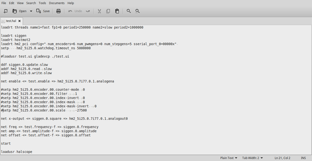

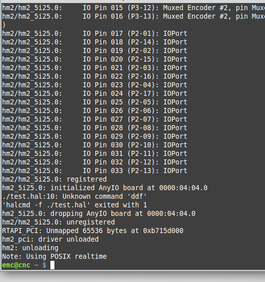

Todd, Thank you for your help. I am not shore what has happen, but this is the error messages and pic of the "test" and the lines in the file. I have the line edited as per your suggestion, but the motor does not seem to get the signal.

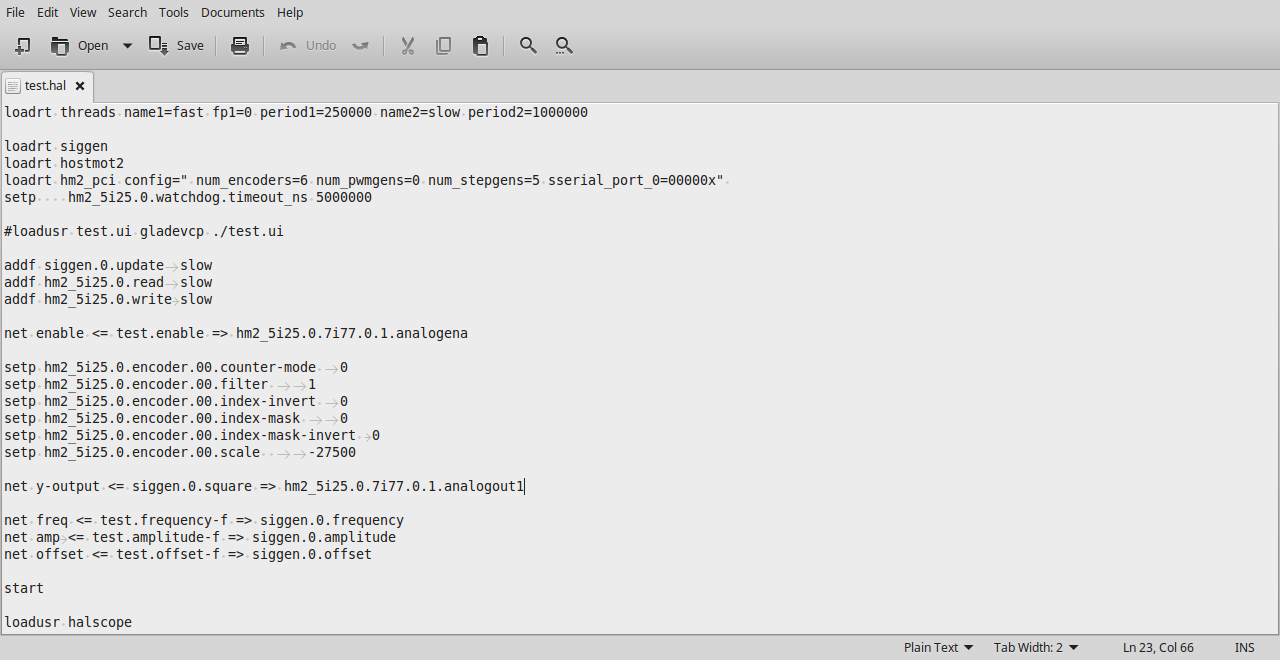

There is only one siggen loaded so that should still say siggen.0.
I do see some possibly unnecessary stuff that references the X-axis.
All of the "setp hm2_5i25.0.encoder.00" lines refer to setting up HM2 parameters for the 1st encoder channel. But I don't think that is pertinant since we aren't really using any encoder for the testing. You could change those lines to "setp hm2_5i25.0.encoder.01". Or you probably could simply delete them.
It is more likely the key lies with the error message you gave. That is pertaining to the user interface. It sounds like maybe something didn't unload or get closed properly once. You may need to reboot the computer to reset every thing before you try again.

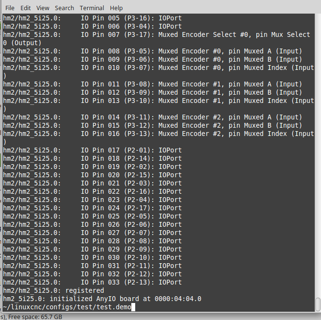

Todd, Many thanks! Today when I started I deleted the files in the "test" folder under the configs dir, and recopied the files from desktop folder of original files. Attached are the pic of the error in "terminal" and a pic of the files in the test.hal folder. I used the "#" to rem out (I think is the term) to reflect your suggestion as per post# 22 Aug 2022 19:27 #250223. I also could be very wrong, please suggest a way forward.

You forgot to change the "ddf" on line 10 to "addf"

Todd, thank you. After the edit "addf" the "x" axes motor vibrated ok & so I edit this line: "y-output <= siggen.0.square => hm2_5i25.0.7i77.0.1.analogout1" (with hope) but I am not able to get the "y" axes to vibrate, yet. I am at a loss. Attached is the error.
