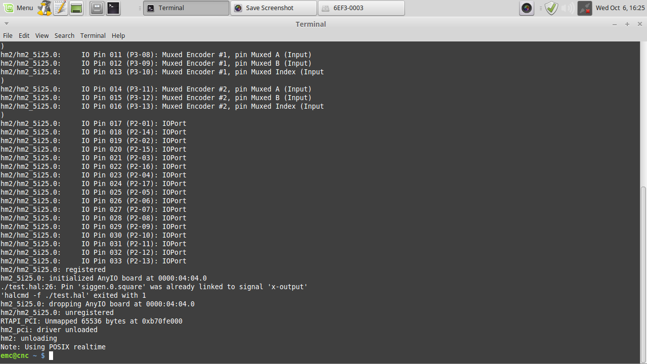

Todd, hope your travels were safe and fun for all. I have applied power & tried to get the "test" to send signal to motors, so I can try o-scope on the velocity loop tuning. The attached pic of the error is attached, I could not get to the siggen screen yet.
Many thanks
Many thanks

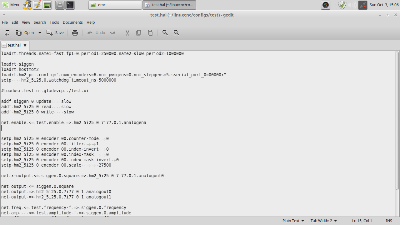

Replied by Todd Zuercher on topic Set up using AMC AB15A100 drives, brushed DC motor Prototrak Plus with Encoders
I'd strongly suggest testing only one drive at a time so be sure to comment out the Y axis analog output line while testing the X.
You had that error because you replaced the old analog output line without removing or commenting out the newer ones.
Here is a new test.hal that has both encoders set up for the X and Y and separate net lines for the X and Y analog outputs (with the one for the Y commented out.)
When you want to switch to the Y axis simply remove the comment for the Y output line and add a comment (#) to the one for the X.

Also, according to the manual the velocity output pin (#15) on the drive is scaled at 22kHz/volt. That will most likely not be quadrature, so to compare with the encoder settings in Linuxcnc you'd need to divide by 4.
If you want your machine scaled so 120ipm is the max velocity, a 1V command should be 0.2 inches per second. Your encoder scale is 27500 edges/inch. So I think a 1v command to the drive should show 0.2*27500/4=1375hz, 1375/22000=0.0625v on the O-scope. (When every thing is tuned right (that or 0.25v if I'm wrong about the quadrature).)
If you are looking at the encoder feedback in Halscope, you'd look at the velocity feedback of the encoder which is in ips, so there you would be tuning for 0.2ips for a 1v command.
