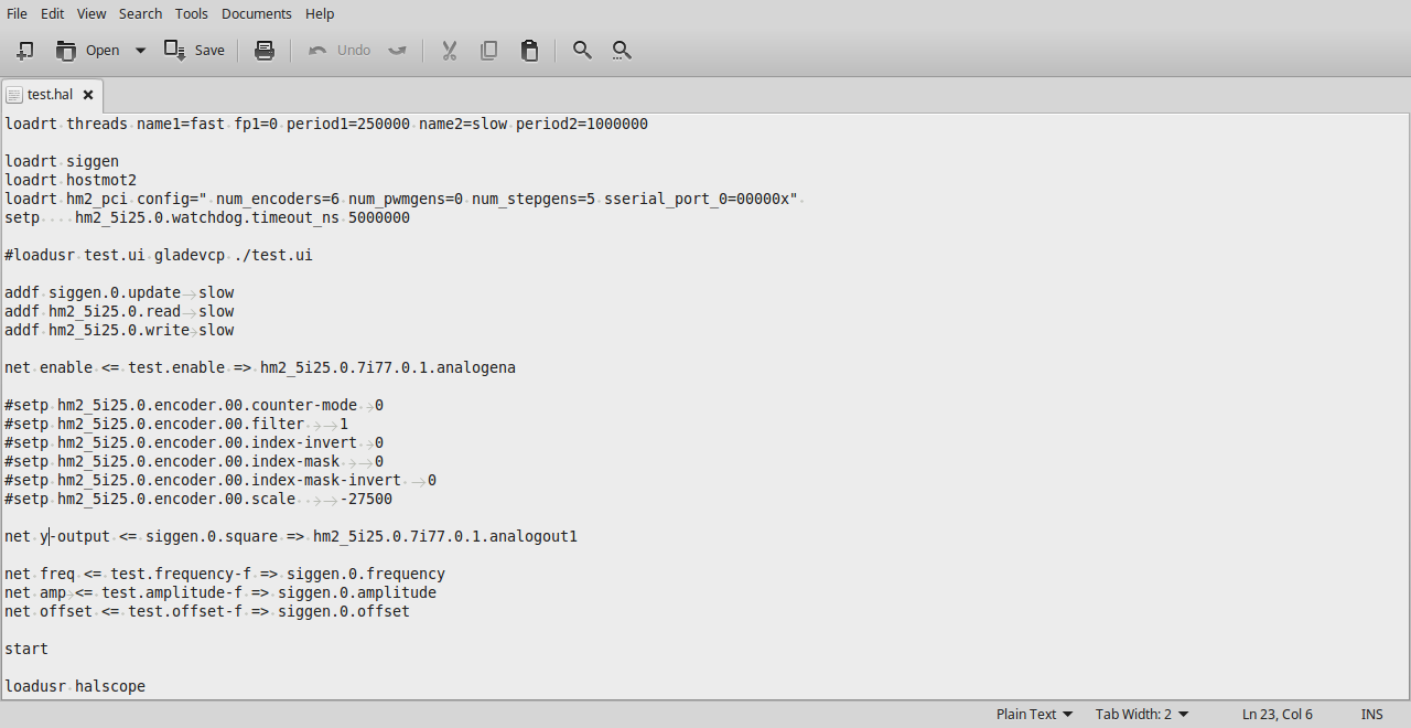

Todd, thanks! I have closely review (to the diagram a few posts earlier) my connections & tighten a few connections on temps & others, on P1 (the A-M-C drive) there is no wire from pin 2 to pin 11. Should there be? I see both have "GND" in the name (pin 11=GND vs. Signal GND=pin2).
As I start at the "terminal" screen, type in "~/linuxcnc/configs/test/test.demo" I can see the LED on the drives go from red to green, but no motor vibration on ether motor. Attached is pic of test.hal file. I hope to try the o-scope on the "y" axes.

Replied by Todd Zuercher on topic Set up using AMC AB15A100 drives, brushed DC motor Prototrak Plus with Encoders
There should be no wire connecting pins 2 and 11 on the AMC drive. But if you check the continuity between them I believe you will find that they are connected within the drive.
Just for the sake of experiment try setting up the test.hal file like this.
This will connect both drives to the same siggen signal at the same time. So you will need to have both of the motors detached and clamped down.
It could also be possible that the settings in the y-axis drive are such that it's response is imperceptible to you.

Todd, Thanks! I deleted everything in the "test.hal" file; copy & past your text from the prior post, saved & rebooted. At "terminal" key in:"~/linuxcnc/configs/test/test.demo", press return and I get the HAL Oscilloscope & siggen test screen, all looks good. I press the "enable servo drive" and the "x" axes motor vibrates, but not the "y" axes.
I look at the HAL Oscilloscope screen, at the bottom at "selected channel" the 1channel is "siggen 0 square" channel 2 is "hm2_5i25.0.7i77.0.1analogout1" should I include ""hm2_5i25.0.7i77.0.1analogout0"??
I do not have 2nd motor clamp yet, but working on it. The motors do not vibrate wildly, just a medium buzz sound.
