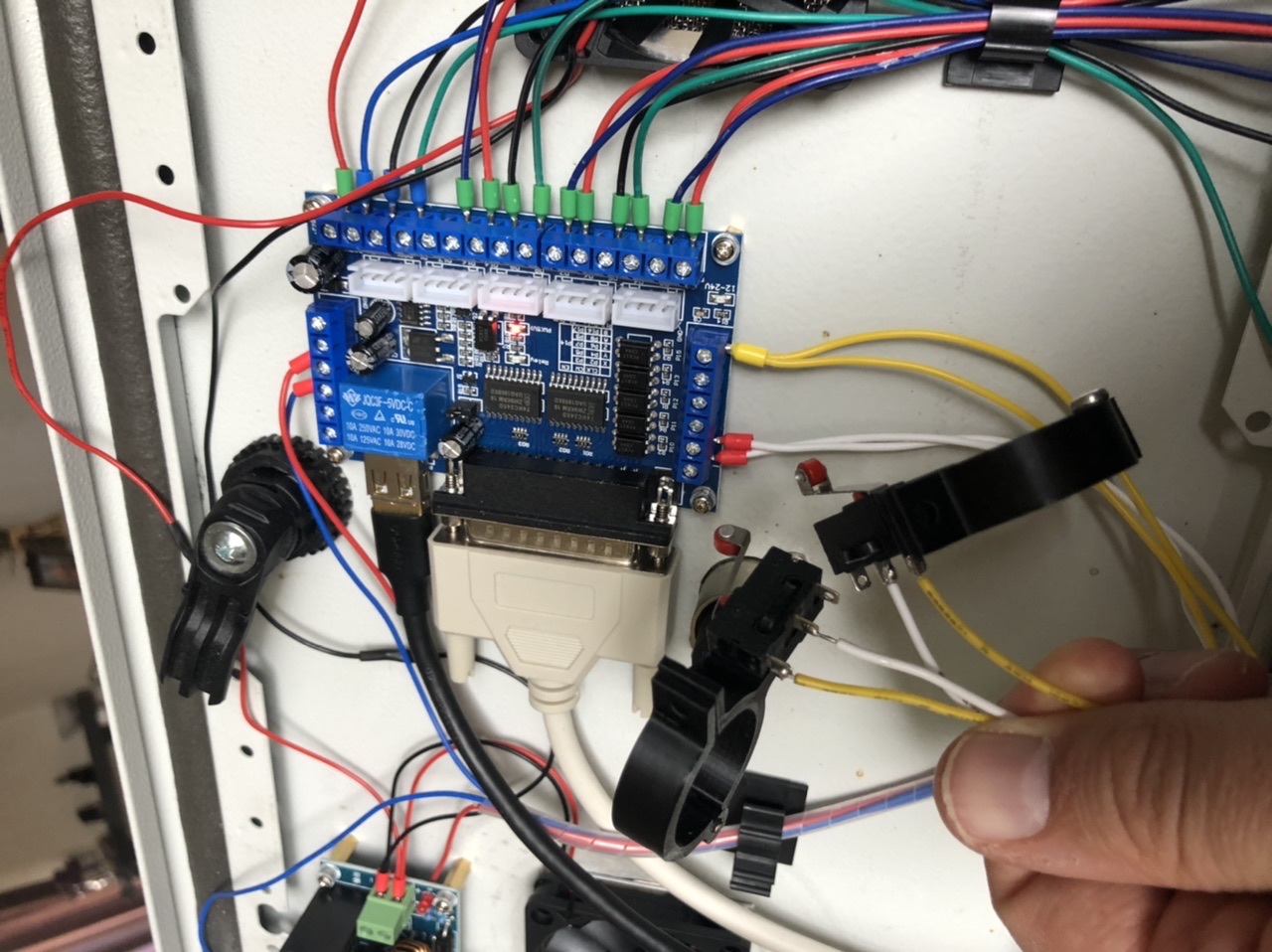

Thanks, the HAL Show/watch is a good one, I tested it out last night.
Everything seems to work fine, except the homing switches. Even in the HAL watch it doesn’t give me a signal.
So I must be wiring it up wrong…. I connect the NO pin to the P10 and the COM to the GND
Last edit: 13 Feb 2022 10:35 by remon_v.

I don't think you have said what BOB you are working with. if it is the standard china one with the blue relay
It will need powering with 5V and 12-24V otherwise the inputs won't work.
So can you give a link to the BOB and how you have that wired

13 Feb 2022 11:49 #234682
by remon_v
Replied by remon_v on topic Home switches wiring / setup
- Clive S

Are you saying that in halshow looking at the say pin parport.0.pin-10-in does it change from yellow to brown or vice versa ?
Can you check with a meter what volage you get on pin 10 BOB and when the switch is activated
Have to tried connecting the 2 -ve gnd's together. I would remove input 11 until you get input 10 working.
edit
try this: assuming the X is joint 0
net home-x1-y1 <= parport.0.pin-10-in
net home-x1-y1 <= joint.0.home-sw-in
edit

Hal watch… does nothing even when I just connect P10 and configuring like you suggested (just joint 0 / X1)
I’ve measured the voltage, when not triggered it’s 9V. When triggered it’s 0V.
